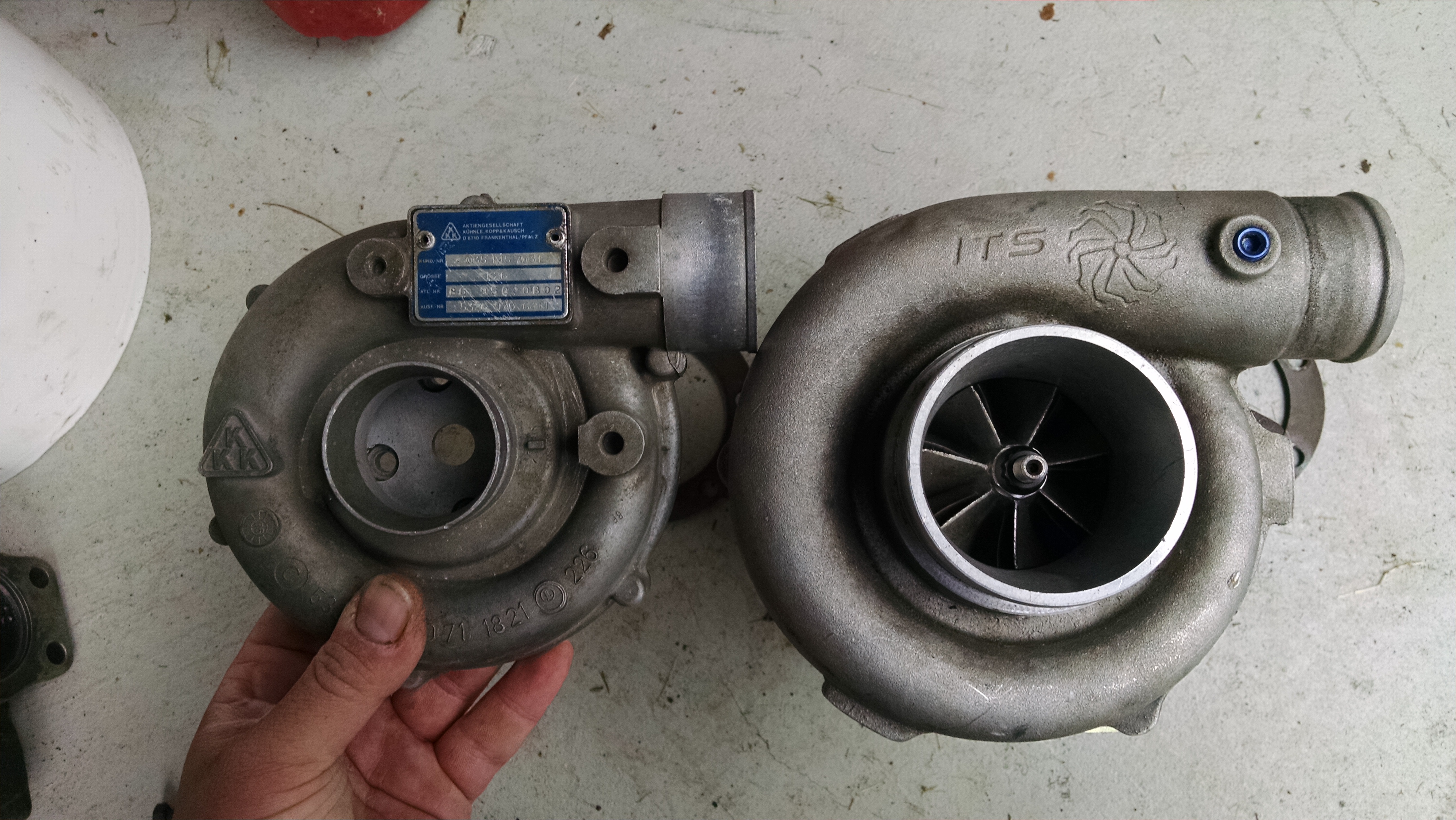

I picked up a Porsche upgrade turbo the other day, and I need some help identifying what it is. As you will see in the pics, it has ITS on the compressor housing. It uses a replica #8 housing, which has an almost 2.5" out. The compressor wheel measures 76mm/57.8mm, the turbine measures 70.78mm/61.5mm. Any help would be greatly appreciated.

I have been told on the S2furum that I his is a T58 from innovative turbo systems. I wonder if this will be ok on my old 20vt...

Pretty much, it's a 58mm turbo, should be good for 4-500 wheel. The power curve may not be the greatest though.

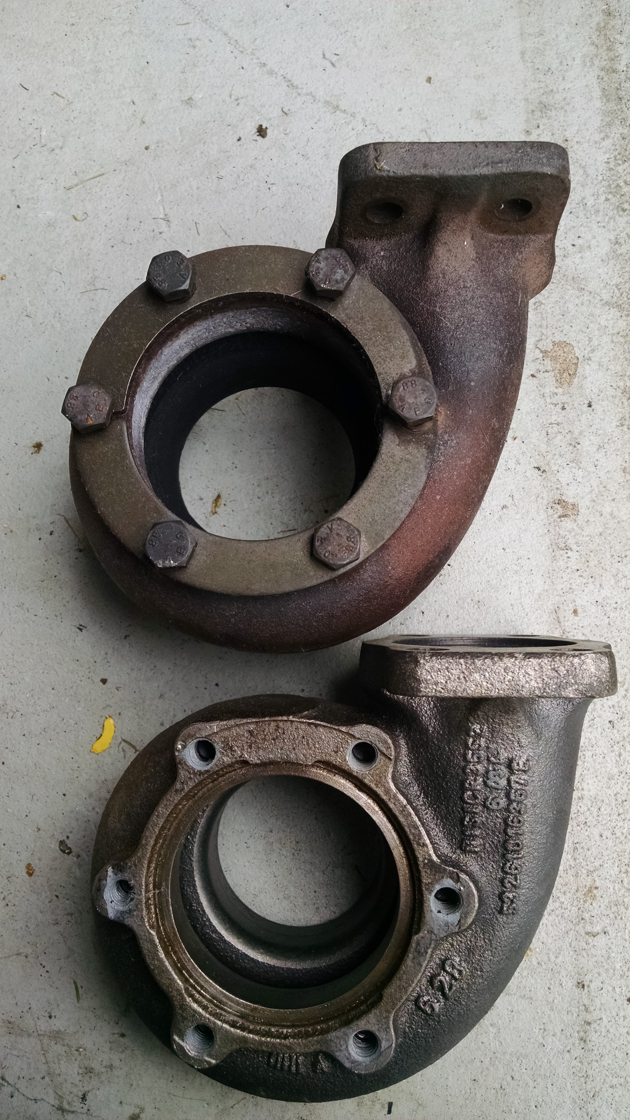

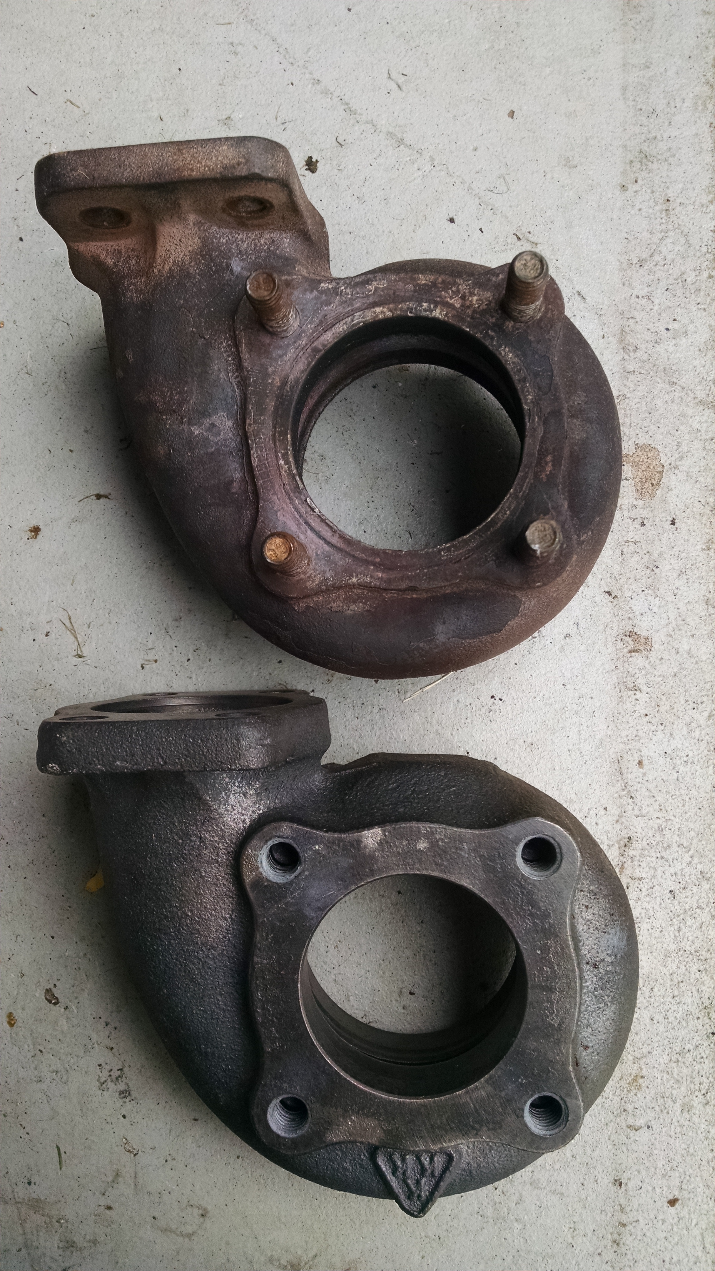

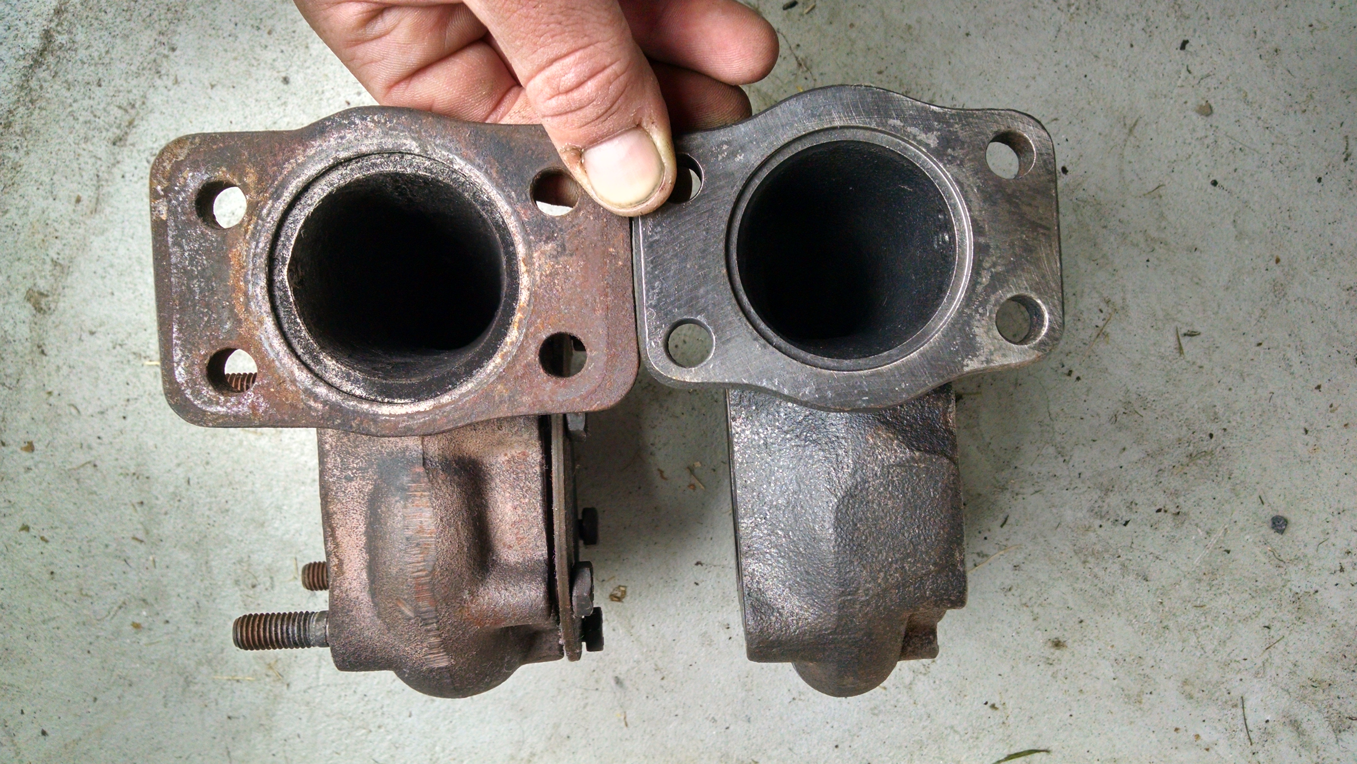

That’s a pretty big hot side, ideally you would go smaller on the hot side and use e85 to get power back through timing. Usually you use a hotside with a larger exducer like that on a v8 or something with more displacement.dana wrote:you should always expect a smart ass answer from me
So not ideal really.

I posted this in my project tread, but figure I'd put it here too. Here are some comparison pics I took. The turbine housing is being compared to an Audi K26 housing. The compressor housing is being compared to a Porsche K26/6 housing. I don't know if there is a difference between the Audi and Porsche compressor housings, so I wanted to make sure toet you know which one it is.

Ohh anodized back plate
Re: Turbo guru's, I need some help!
Yep! Billet anodized back plate. From what I can find, ITS was a pretty high end turbo back in their day.88a5tq wrote:Ohh anodized back plate
