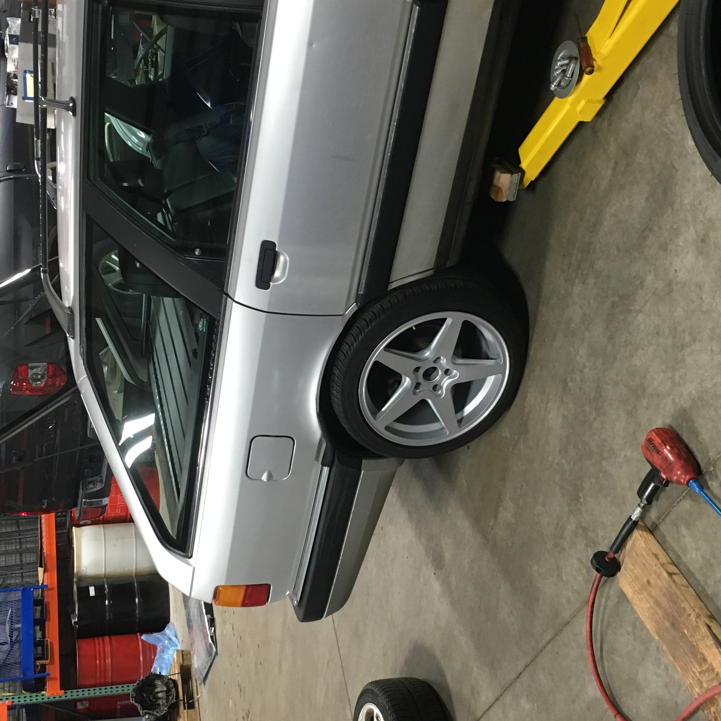

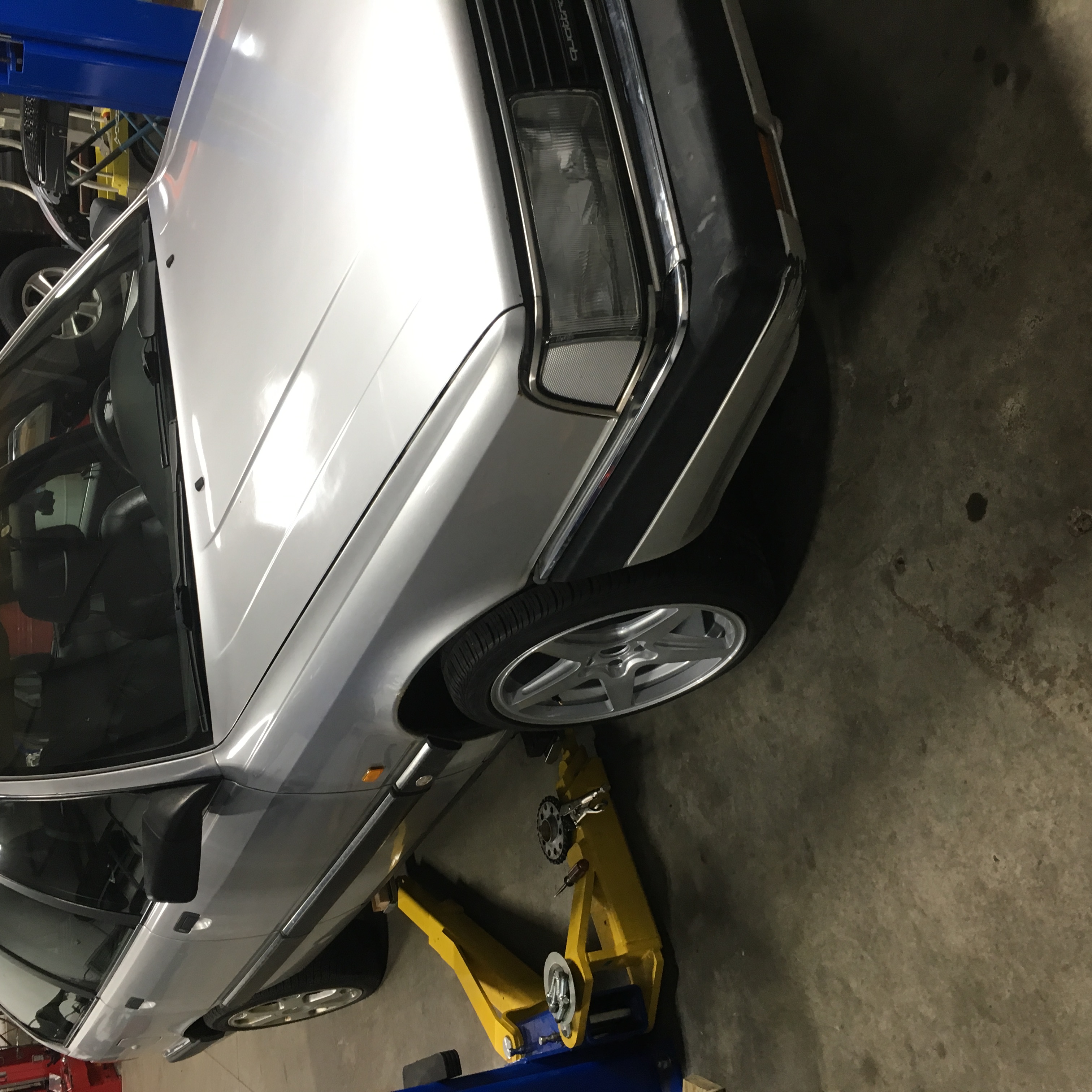

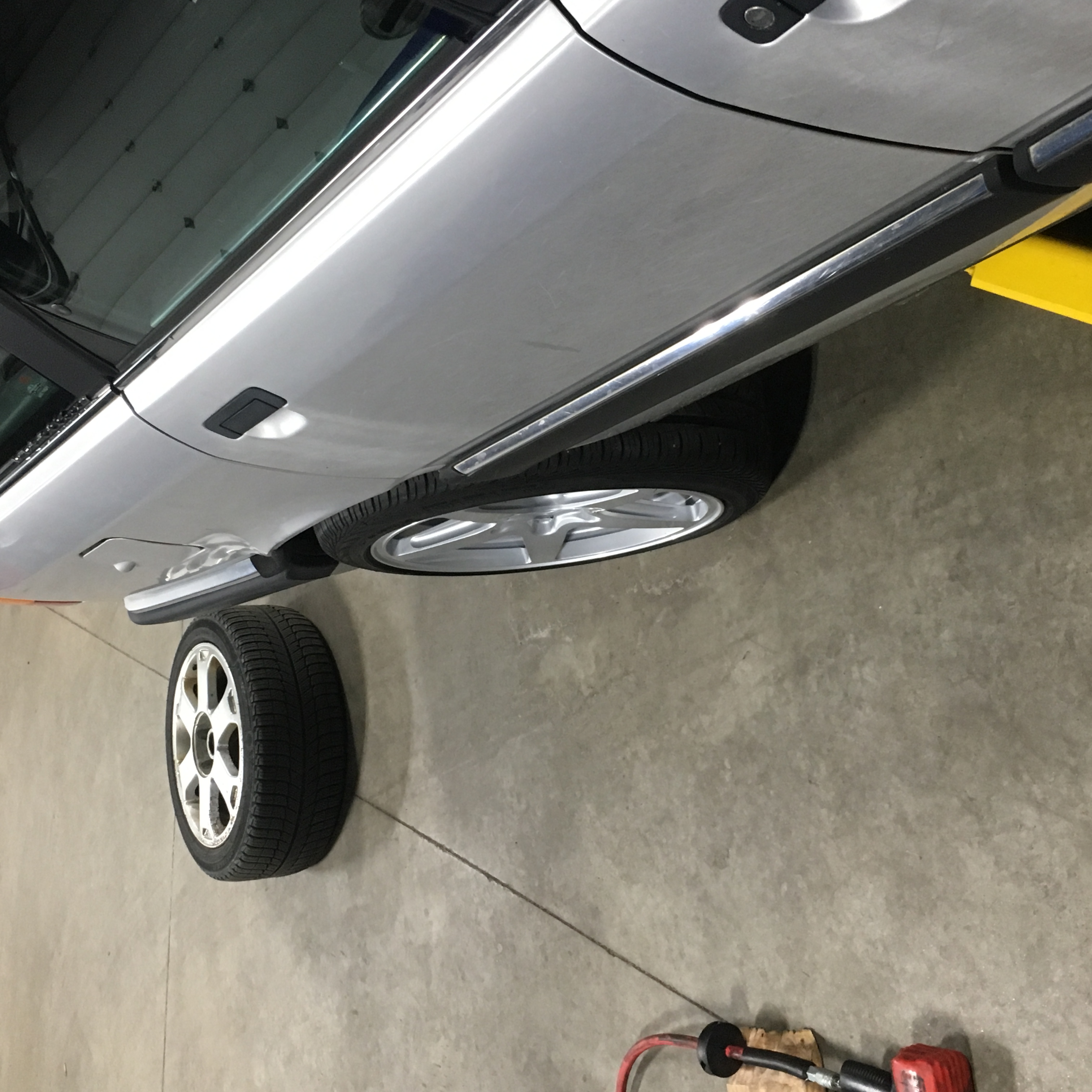

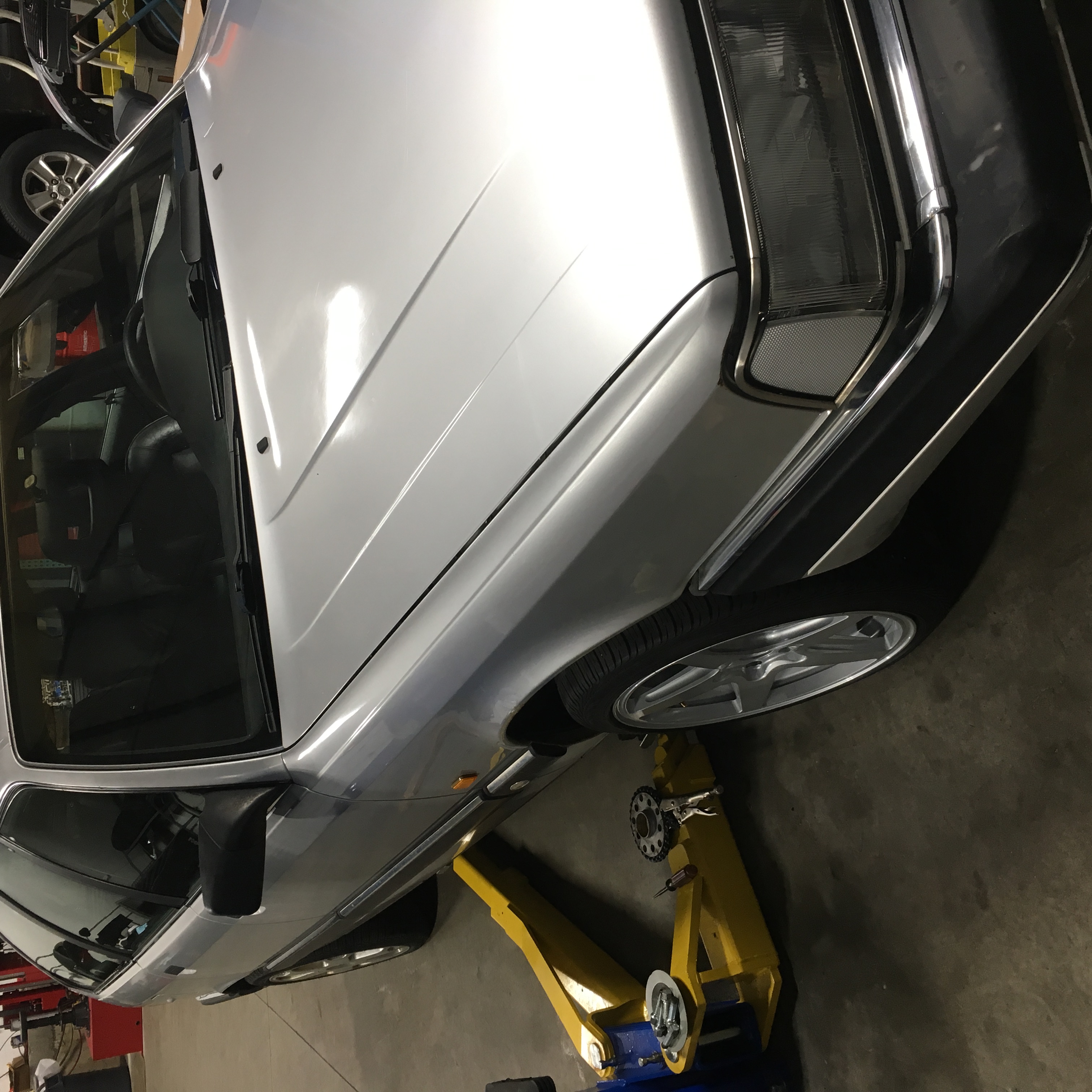

I picked up some 18x8.5 et30 wheels, I test fit a 245/40-18 and they fit nice especially because I’m not lowered (maybe someday but not a priority) but 255/35-18s are cheaper and look beefier.
I’m pretty sure I won’t have issues and worst case I’ll run more than the 0.3 degrees of camber I currently have in the rear but I wanted to see what some of the more aggressive widths/offsets that have been run on a flared t44. I’ve read every 20v build thread and no one likes posting wheel/tire specs, especially offsets.
Here’s the test fit: (front is still kinda high from lifting) I’m thinking the 255s will do me good especially at the off-road height.

*If anyone was wondering, you can fit 18x9.5" ET 20mm wheels with 235 40 18 up front on maximum low*
