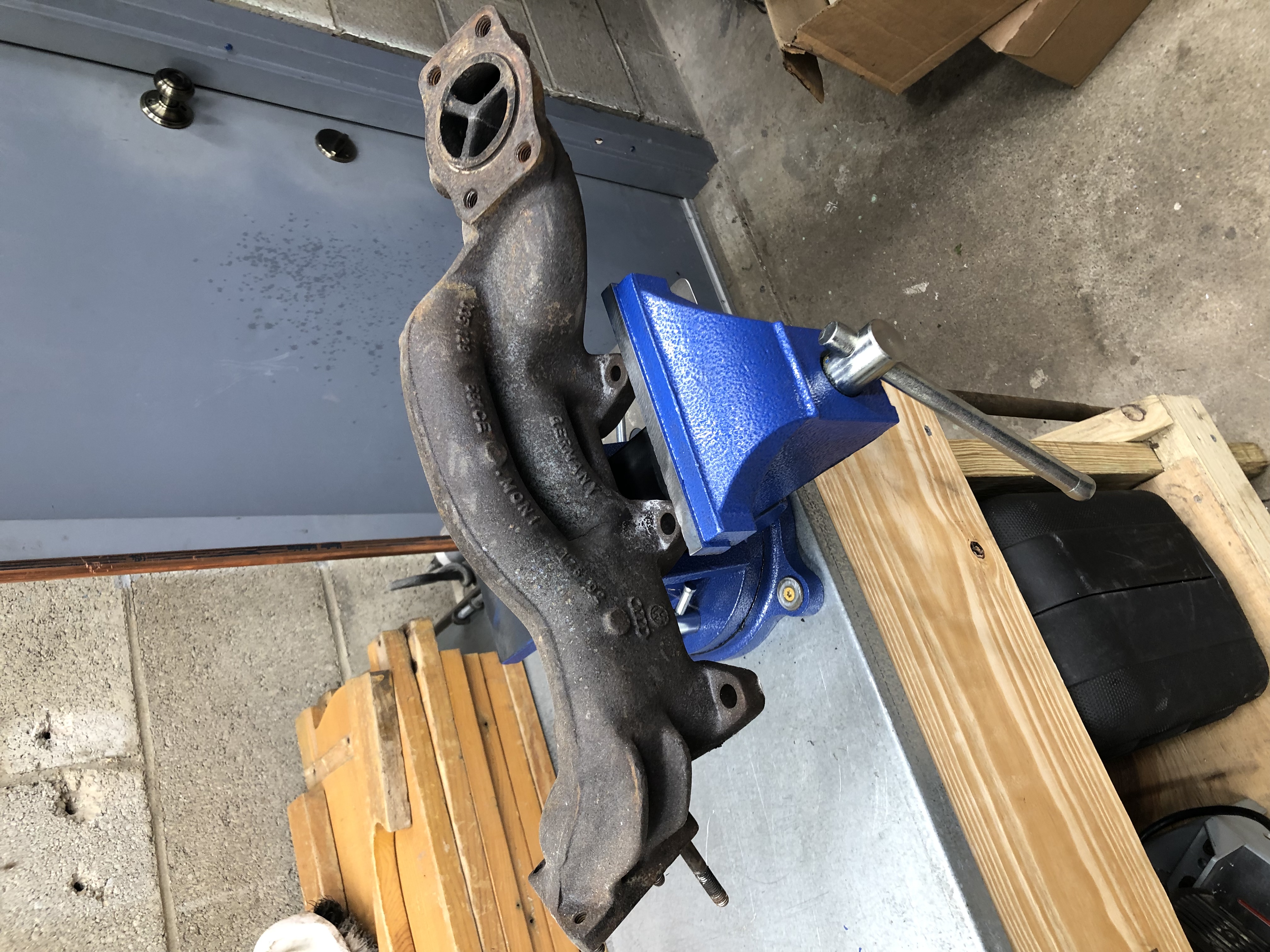

Re: Jonathan's Audi 20vt Exhaust Manifold Project
MoAr!
- 93454B78-77C0-47CA-BFF0-85BB2A49D3C7.jpeg (2.12 MiB) Viewed 26092 times
- 421A2089-0DD3-49D3-B05B-0E0FD5FA43F4.jpeg (2.31 MiB) Viewed 26092 times
- 8D3595C5-1A45-4928-BF9A-508BB6116EAB.jpeg (3.04 MiB) Viewed 26092 times

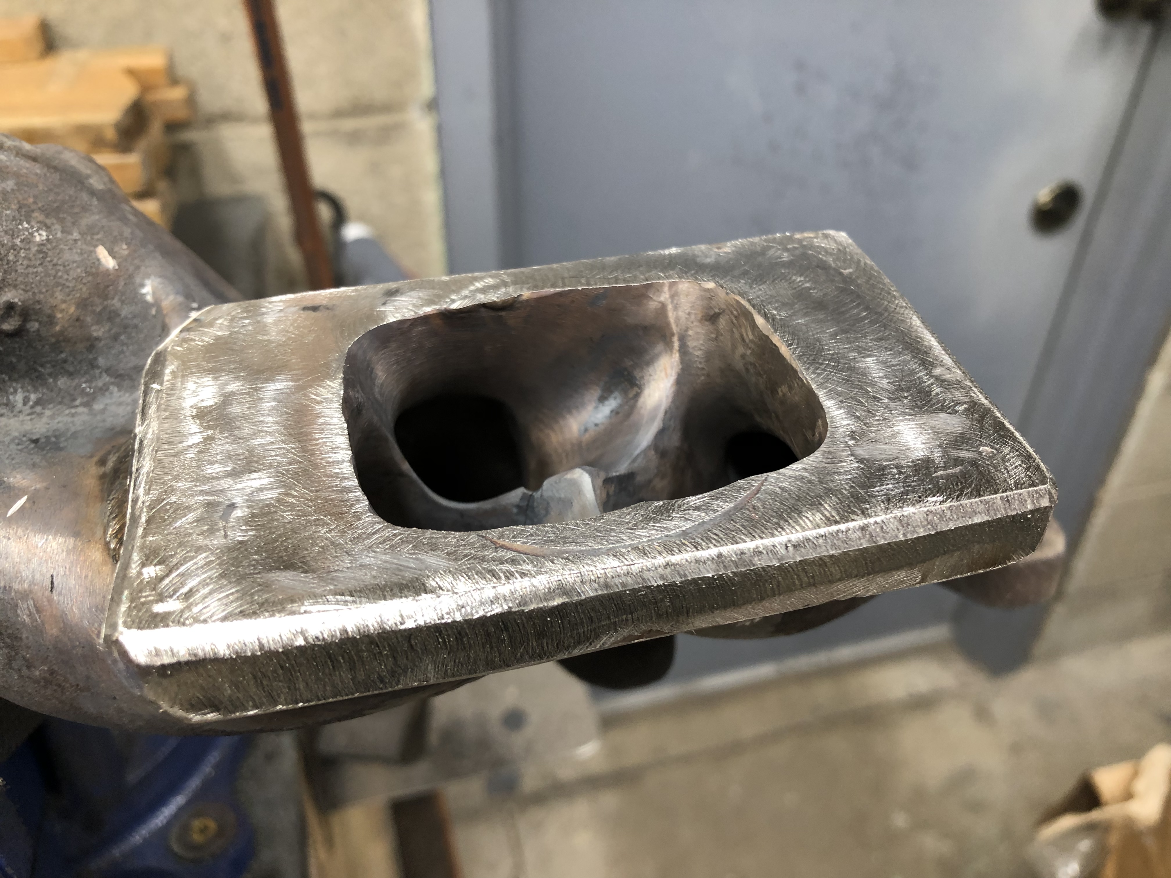

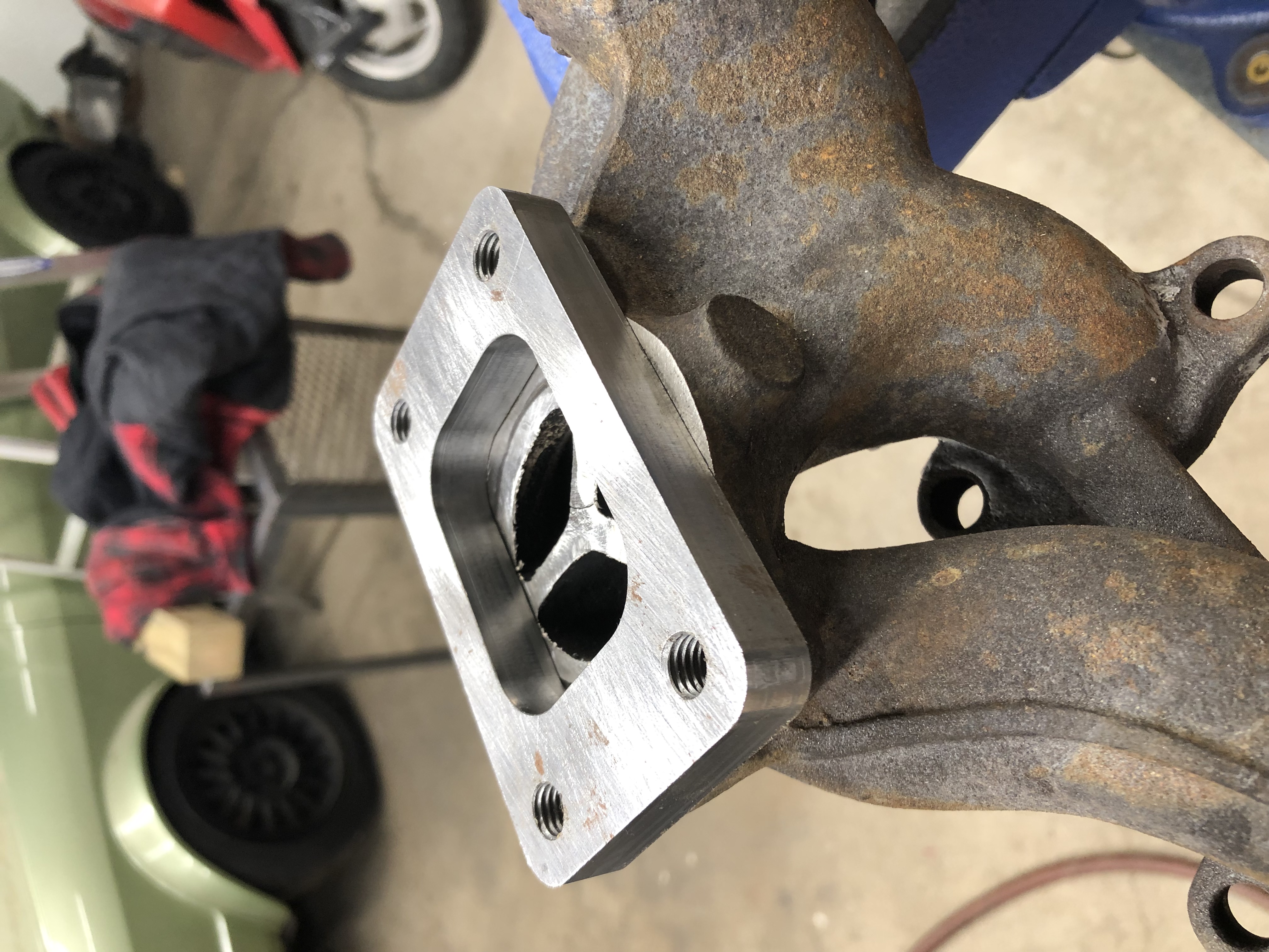

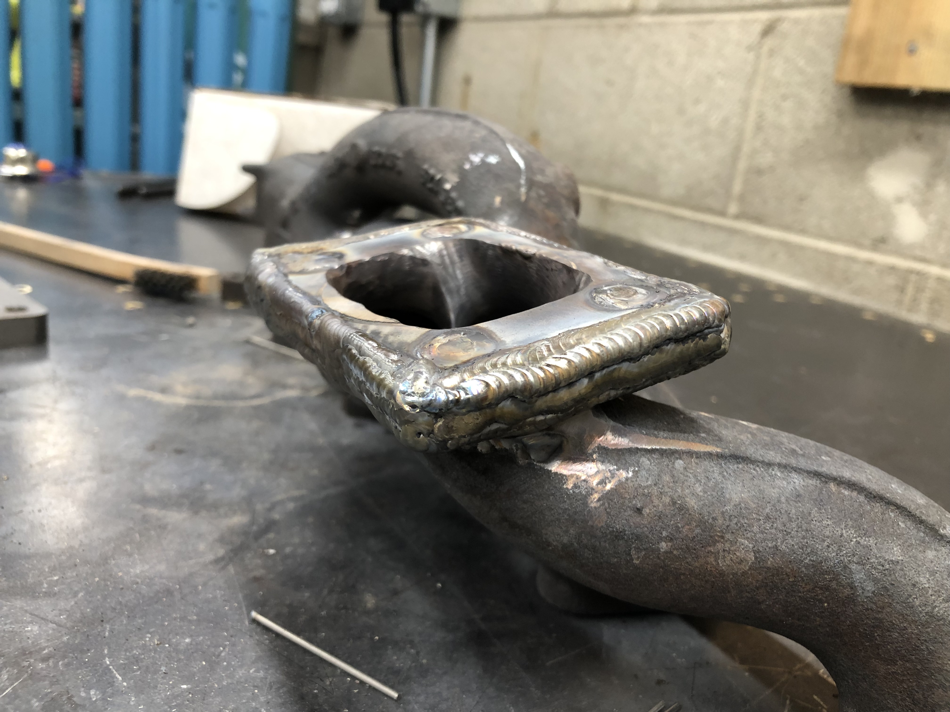

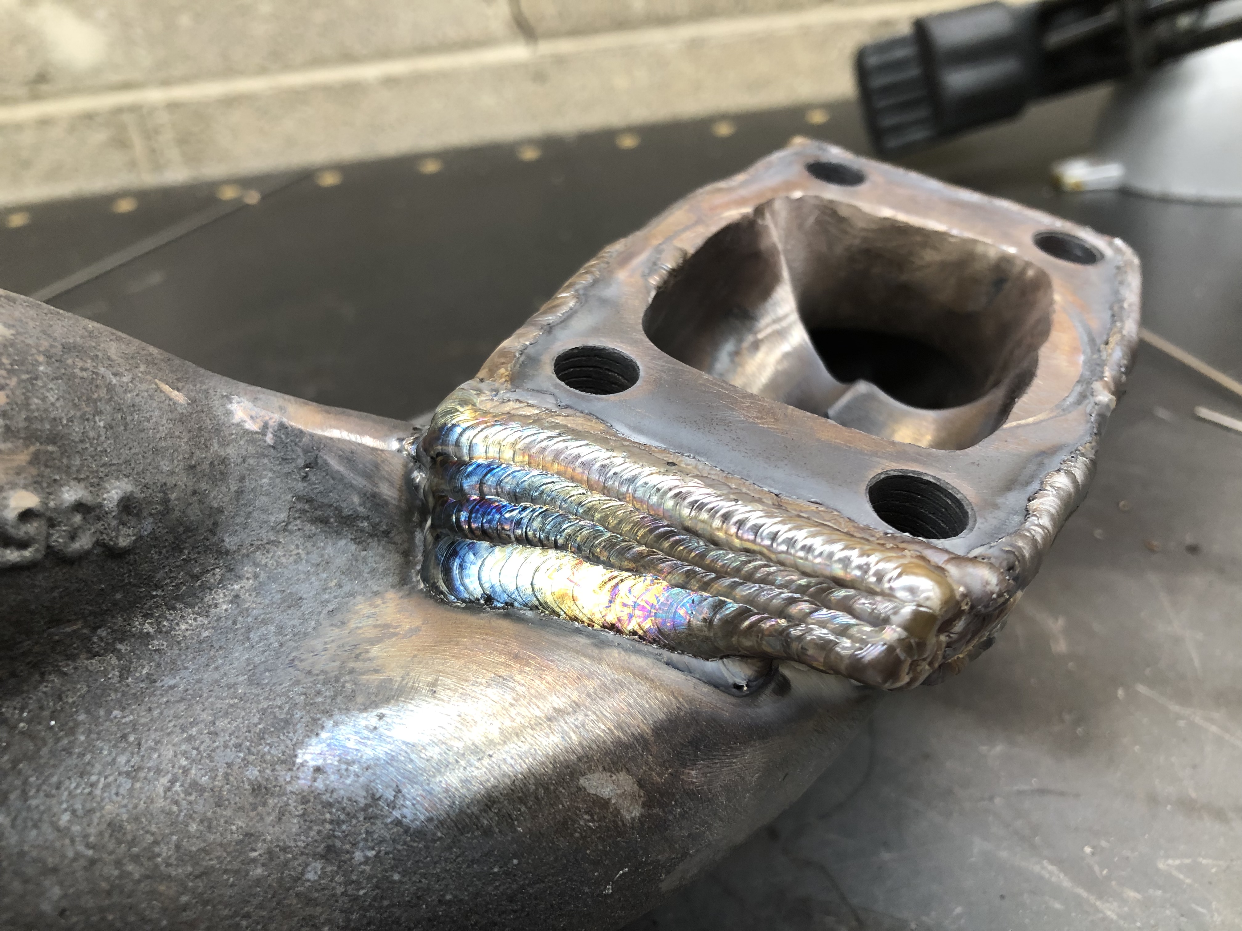

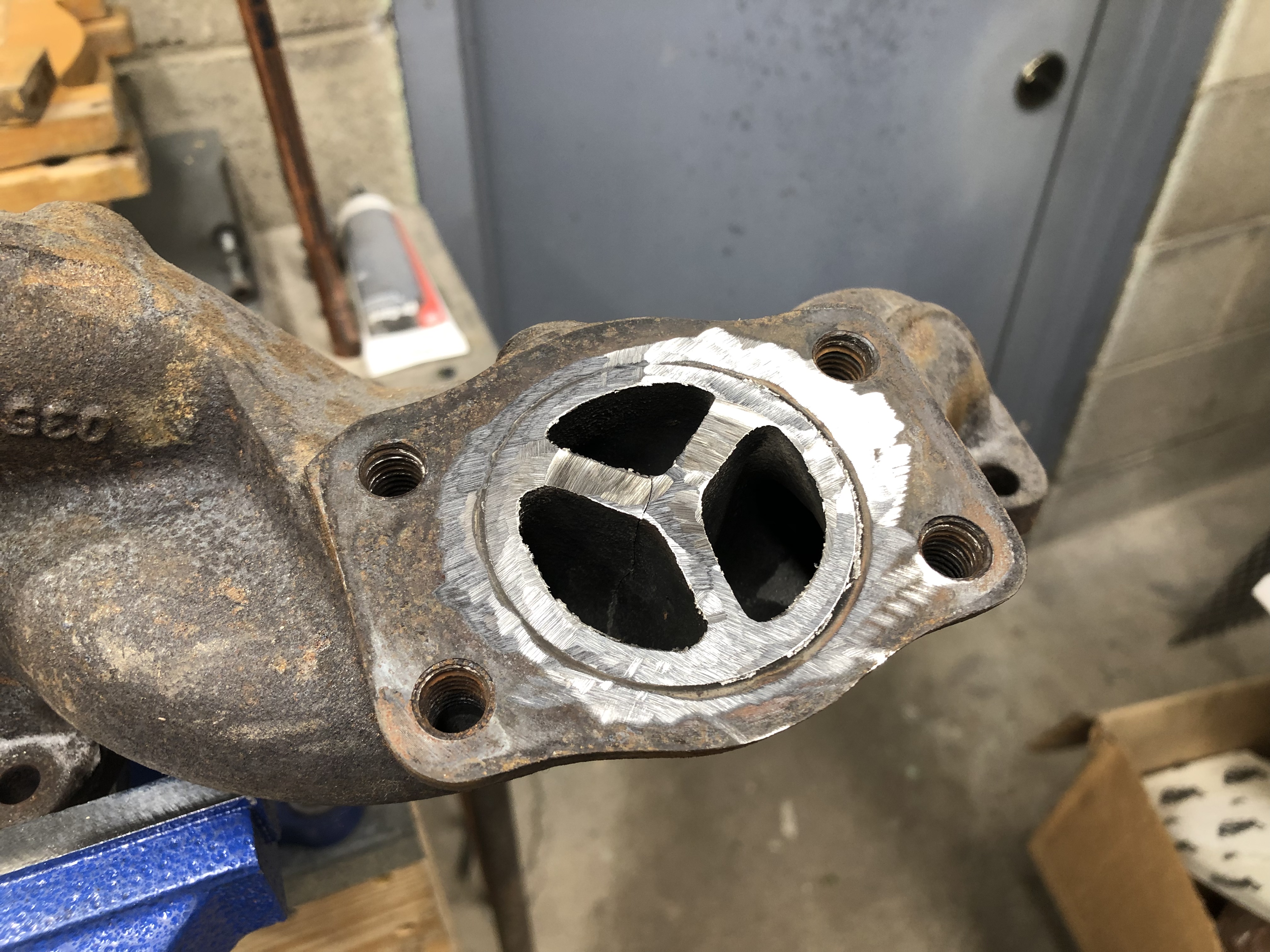

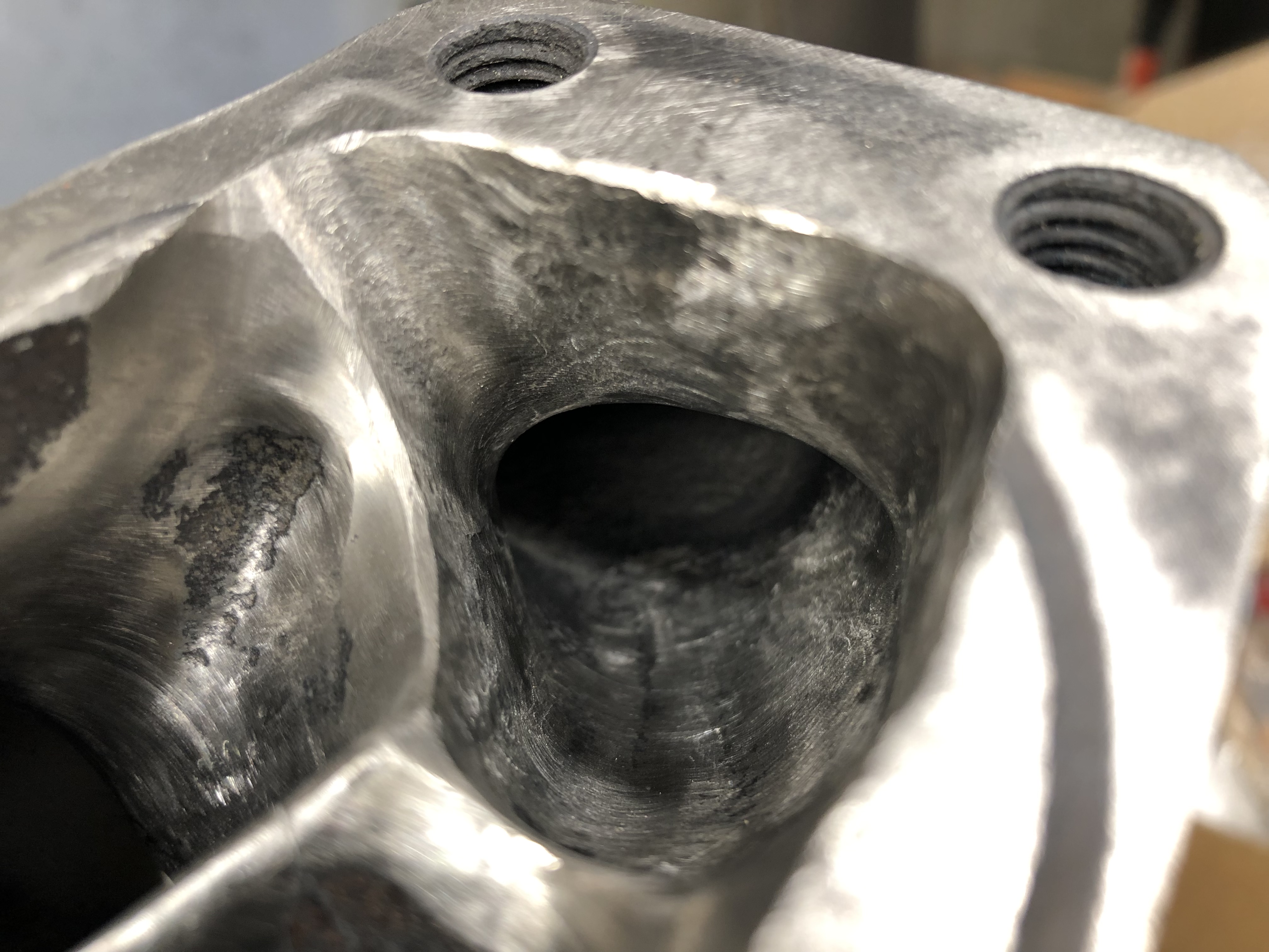

Lots of nickel-99. Here, I am building up the flange to match the Garrett T3 flange.
- 9C2AA10E-56AD-44CE-BB56-7F9800762FCB.jpeg (2.28 MiB) Viewed 26092 times
- 788751B5-7657-4E93-80B4-14A4AA668924.jpeg (2.84 MiB) Viewed 26092 times
- 6675EF55-BDE7-46A8-8AE8-AE95C1A4C3E8.jpeg (2.74 MiB) Viewed 26092 times

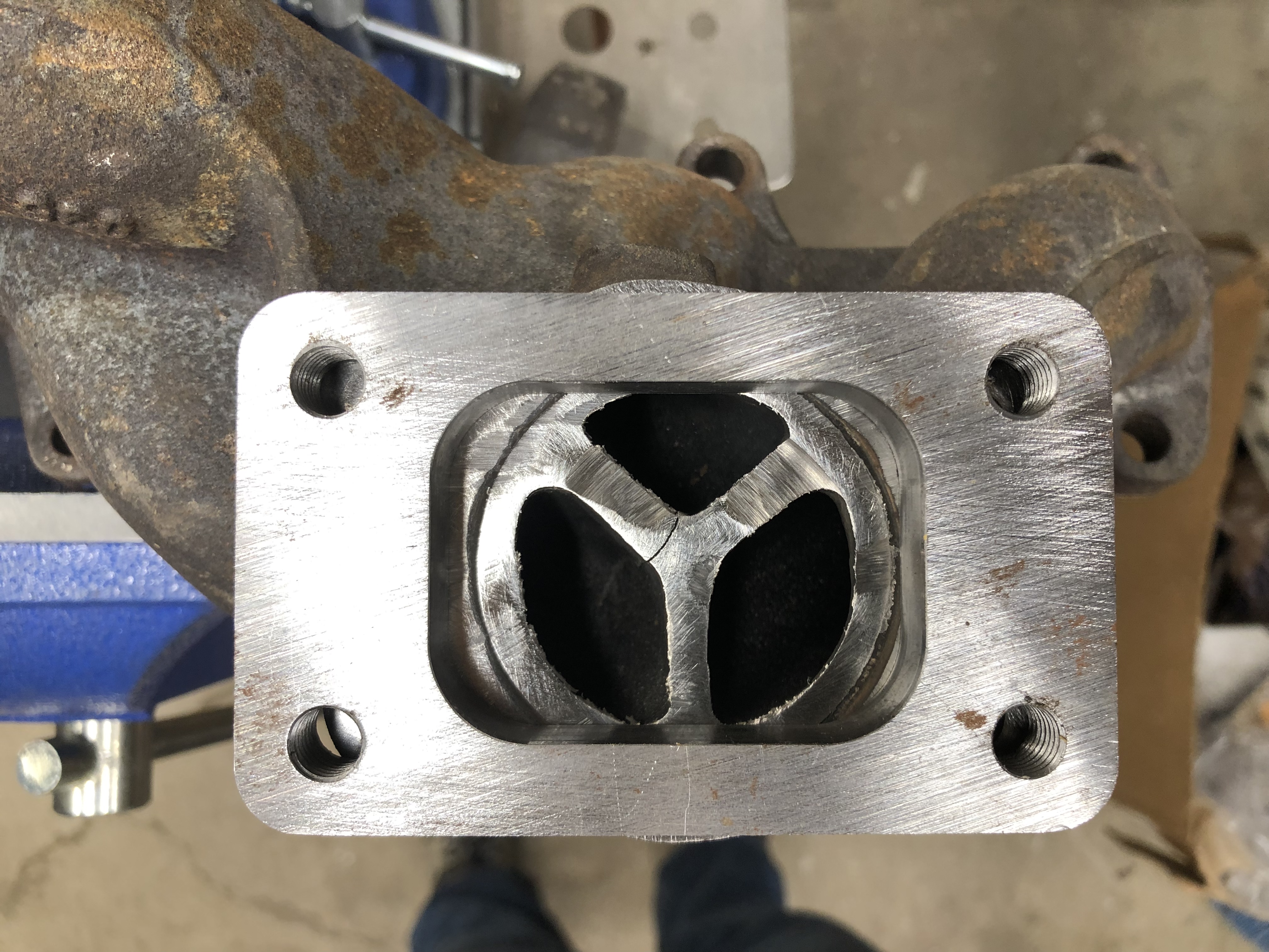

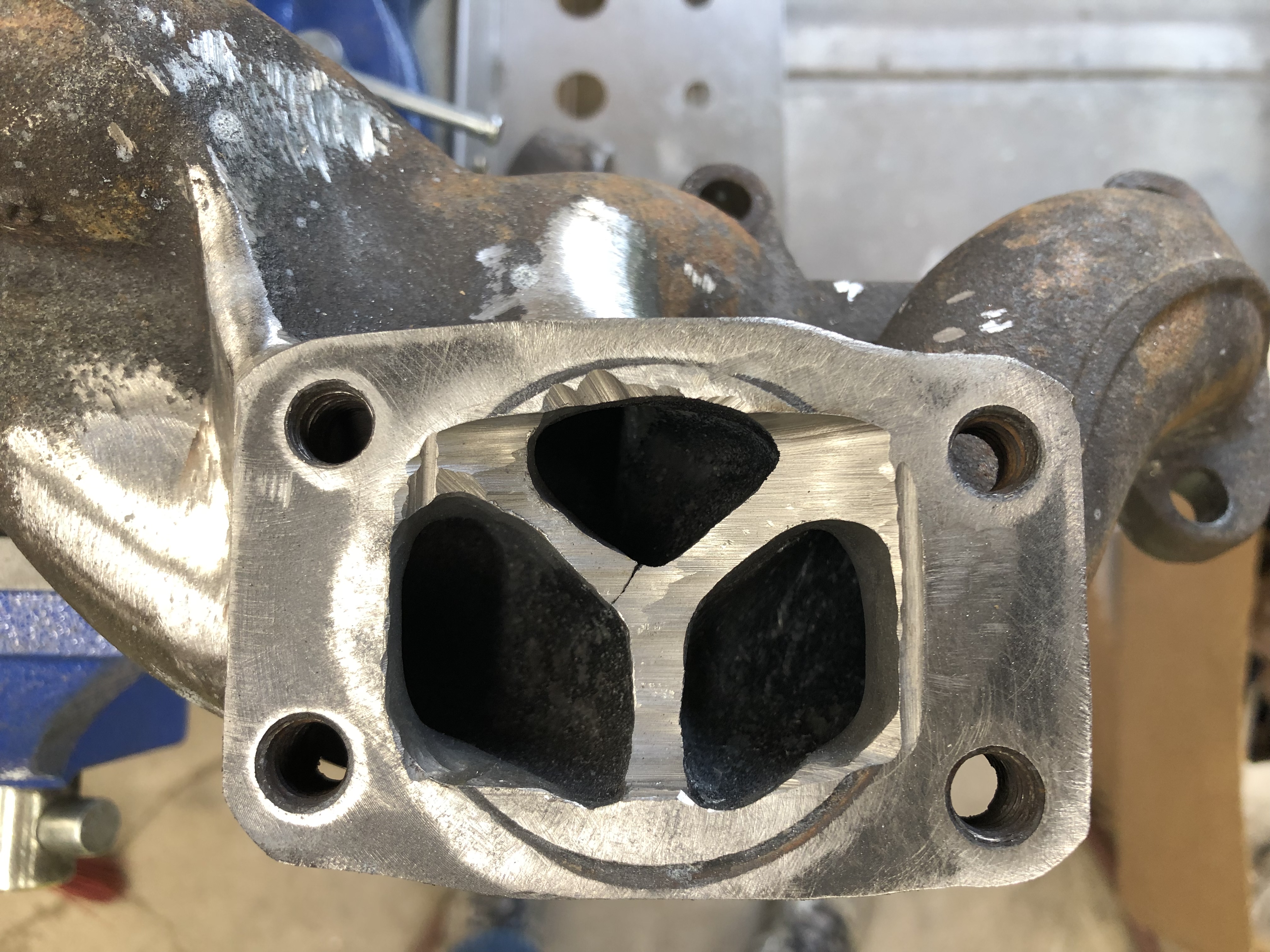

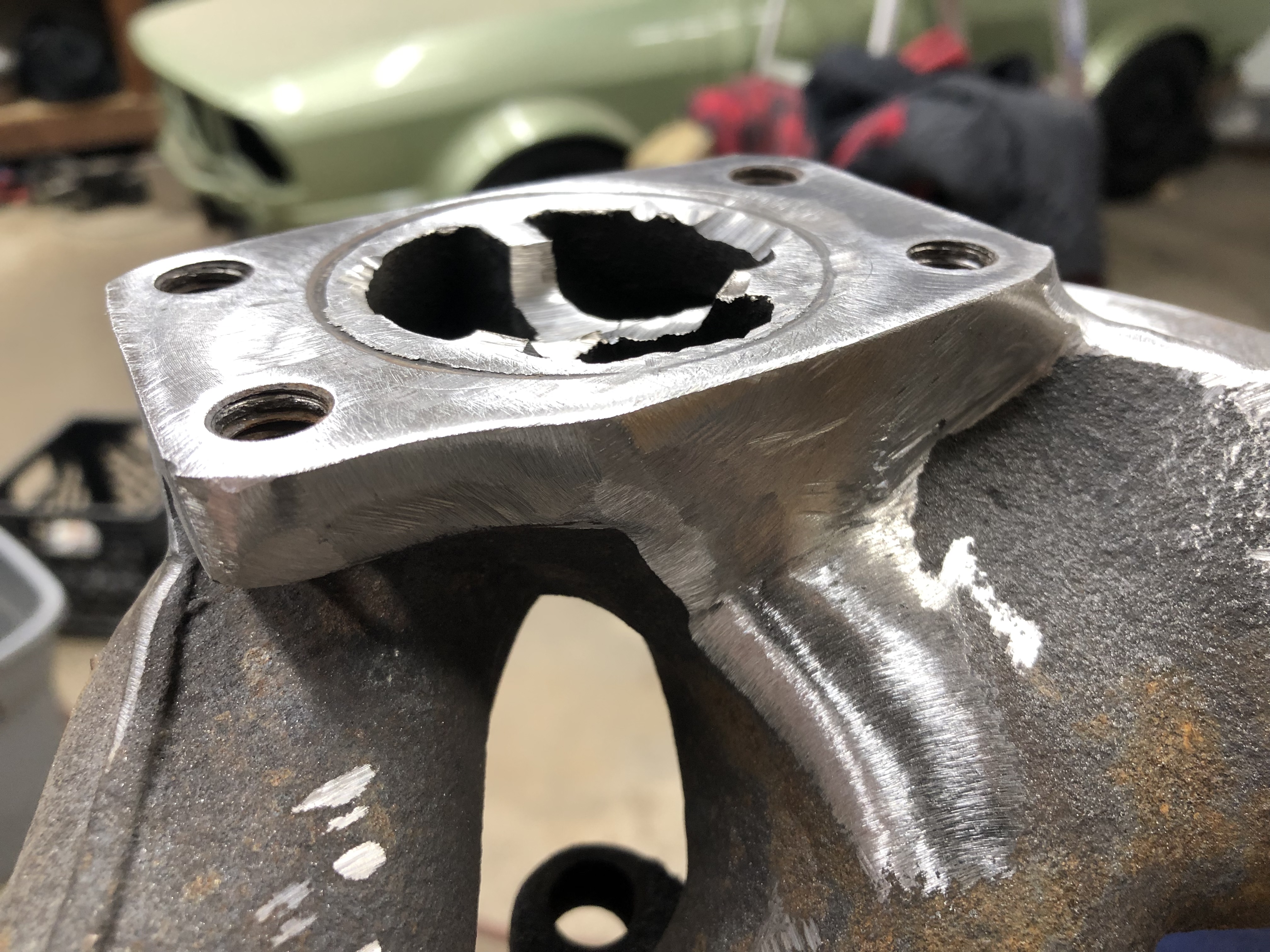

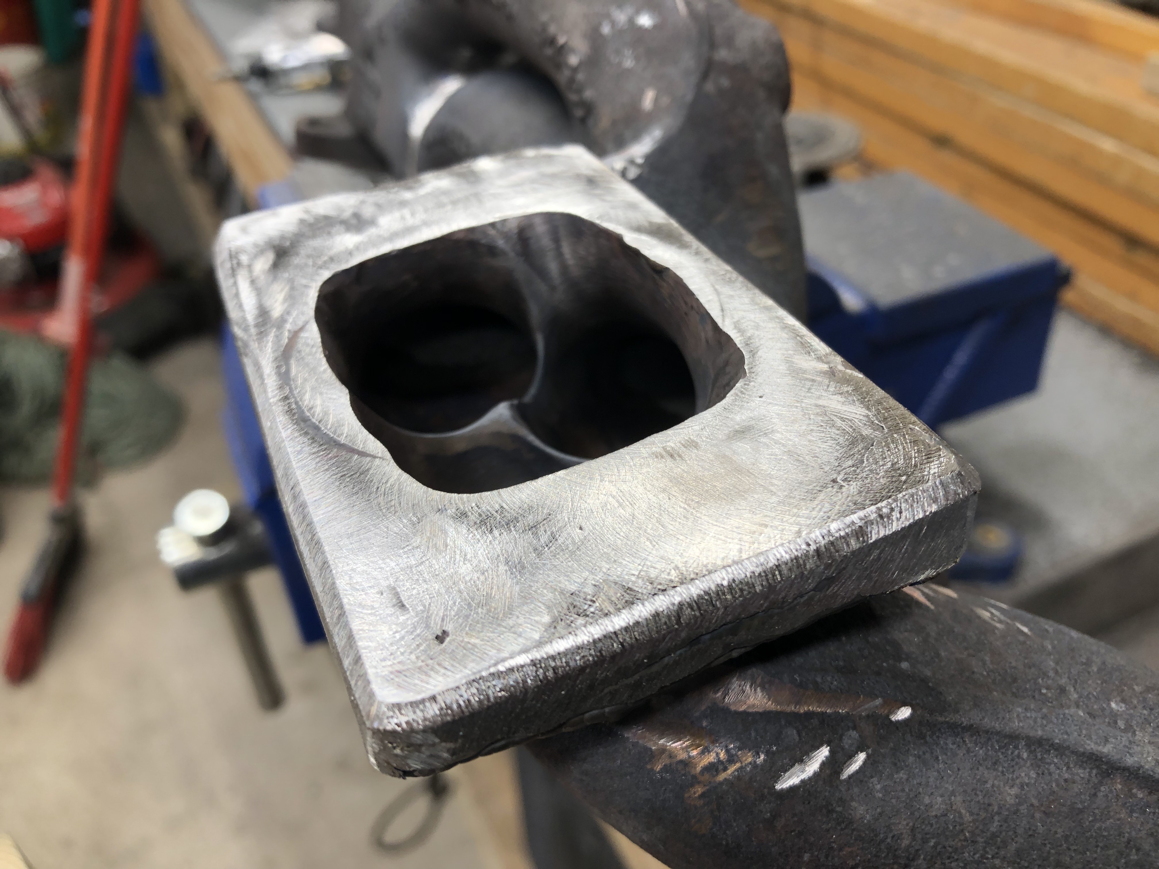

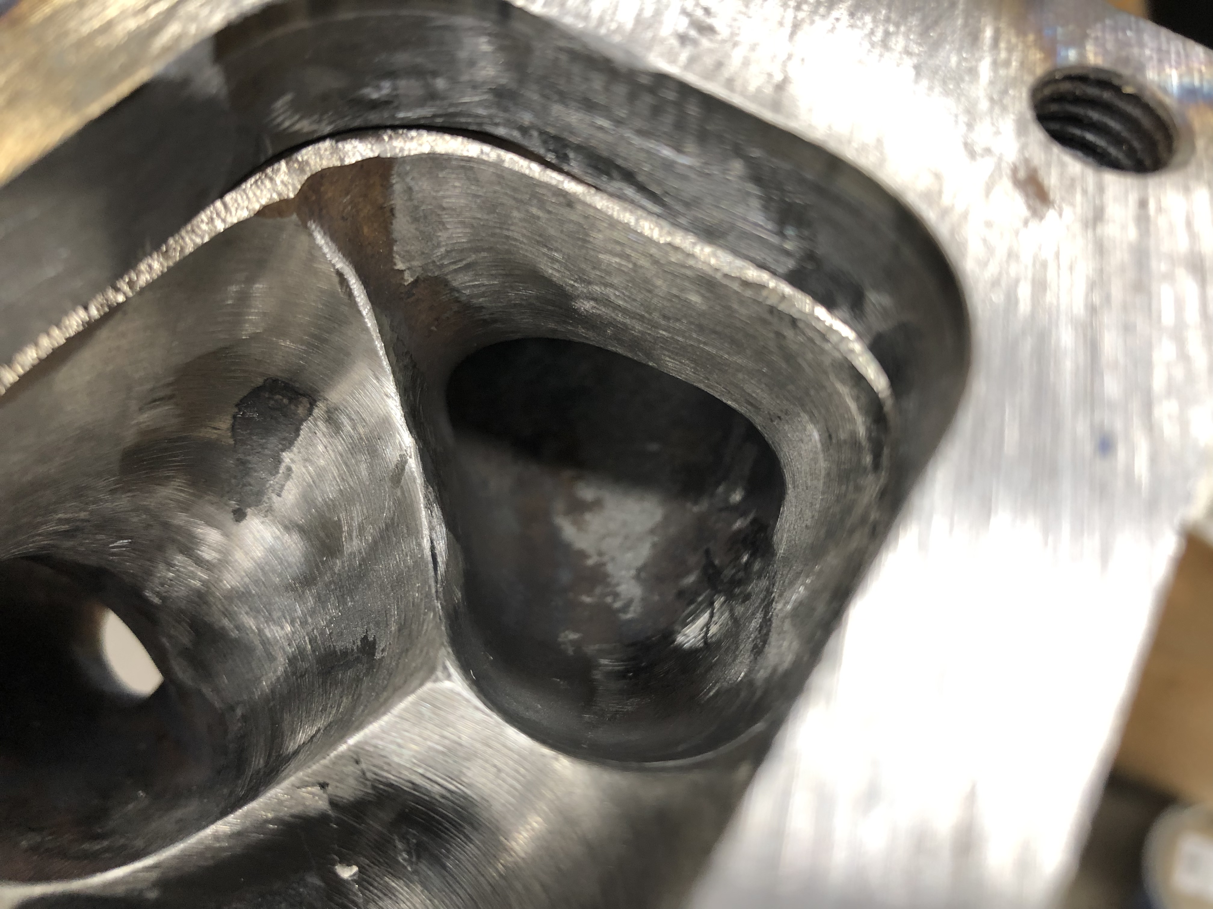

Grinding down the surfaces-up nickel 99 to match the perimeter of the T3 flange exactly.
- 2049BF1C-A947-495A-A5B3-E159233A3855.jpeg (2.56 MiB) Viewed 26092 times
- CEC1A1AD-5AC3-4E2D-B14B-541B7C38269B.jpeg (2.56 MiB) Viewed 26092 times
- 147FBDE5-1F6E-4C45-9D1B-5E7262AEA35B.jpeg (2.31 MiB) Viewed 26092 times

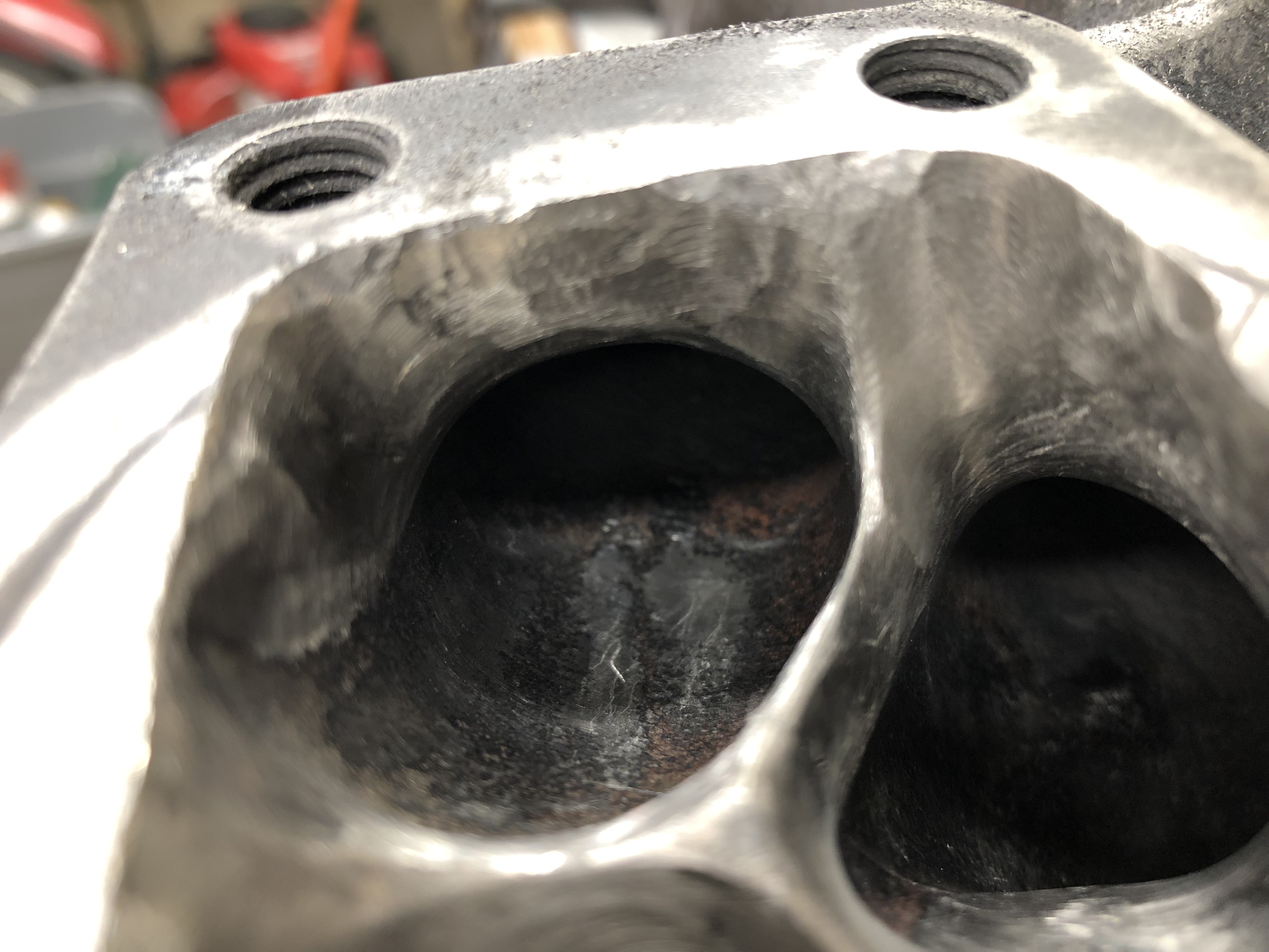

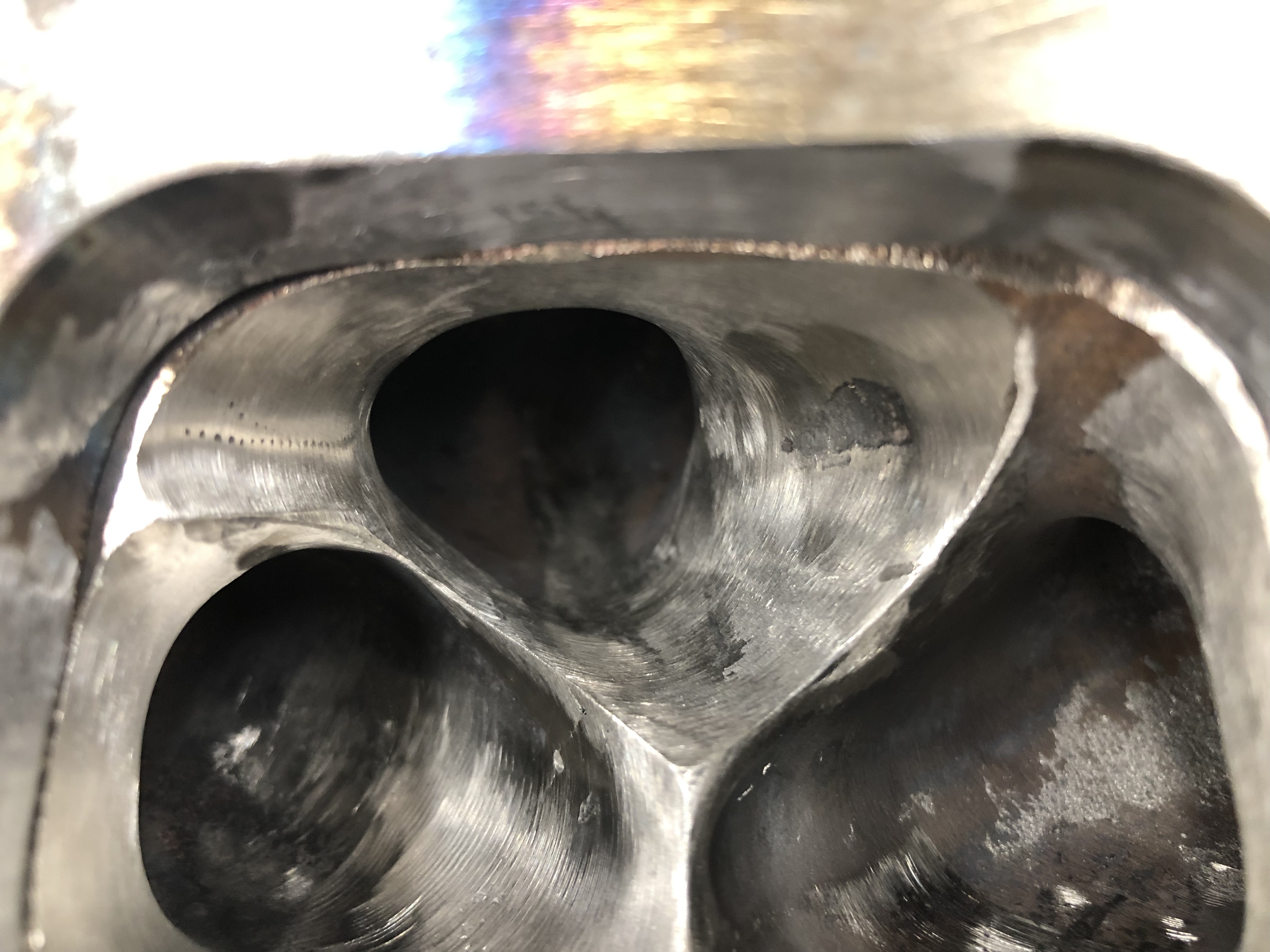

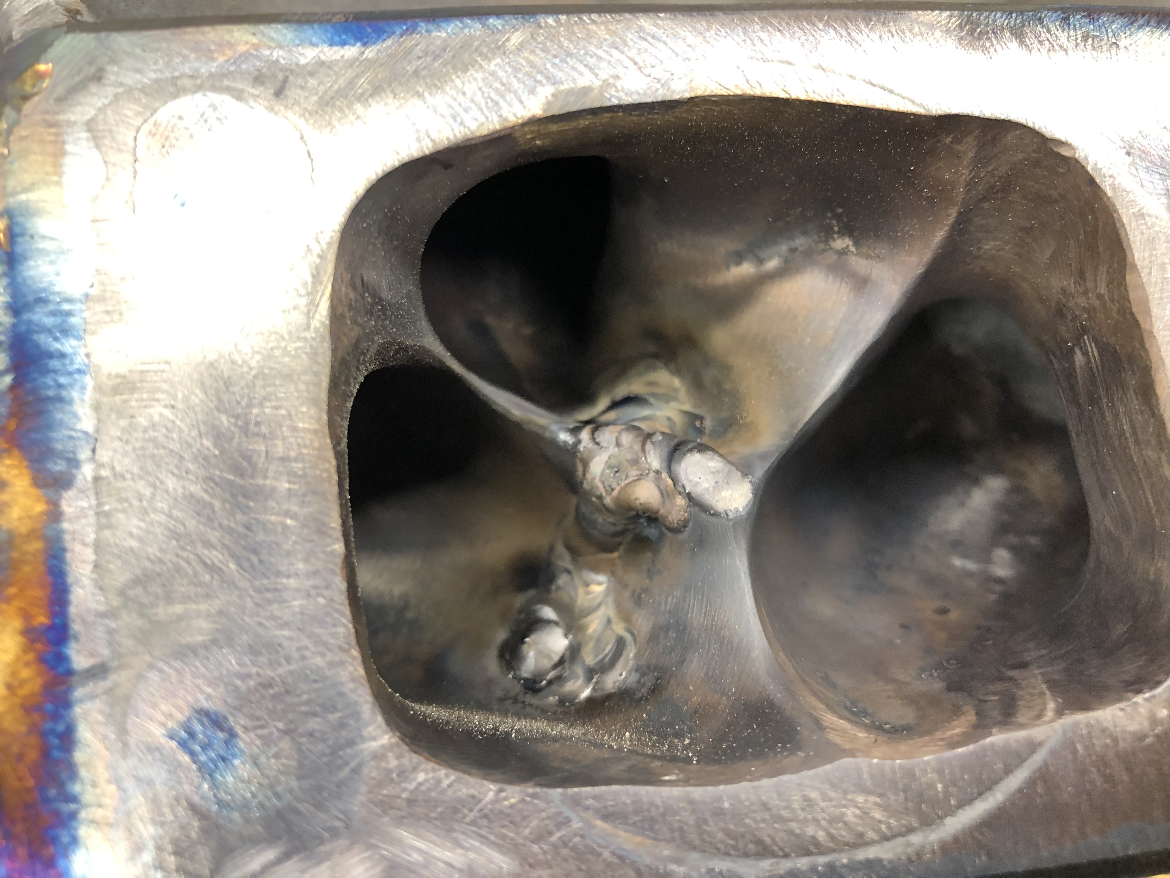

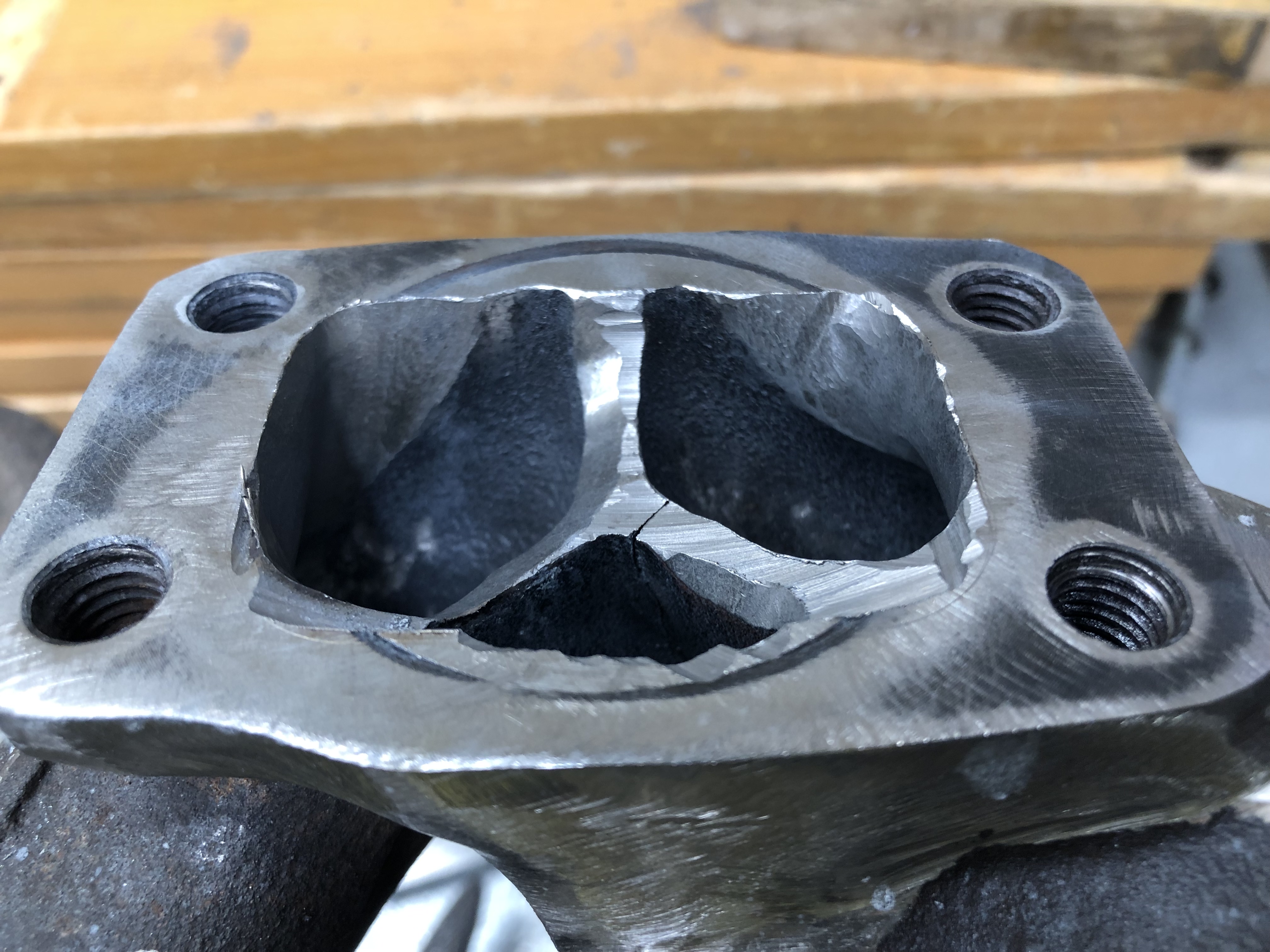

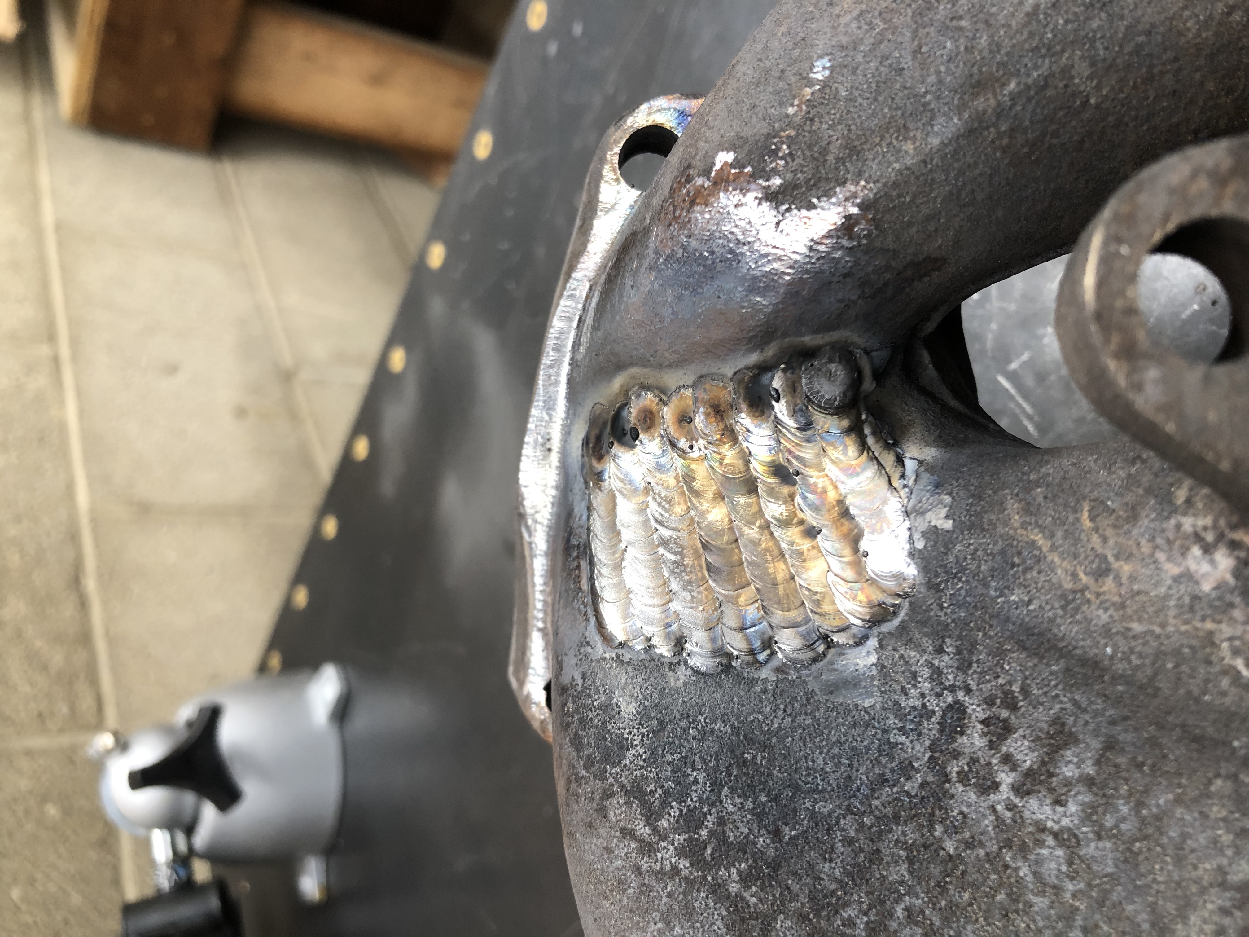

Grooves out and welded the inside and outside of the collector crack.
- 46EA5B42-67DE-473F-95D9-4EF399EB219D.jpeg (2.92 MiB) Viewed 26092 times
- 45C39E54-1664-426A-A49F-0A55E18C6D3B.jpeg (2.62 MiB) Viewed 26092 times

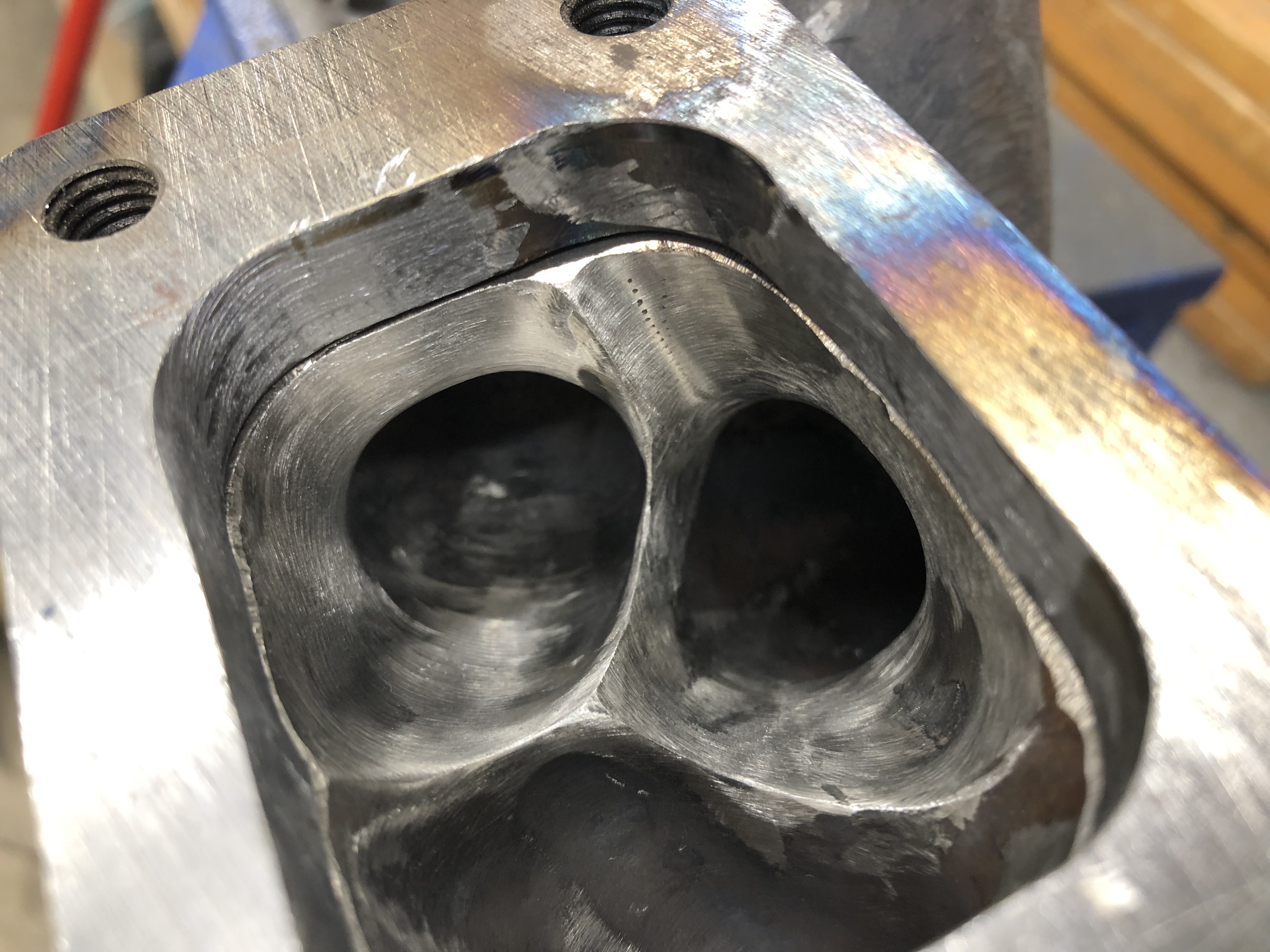

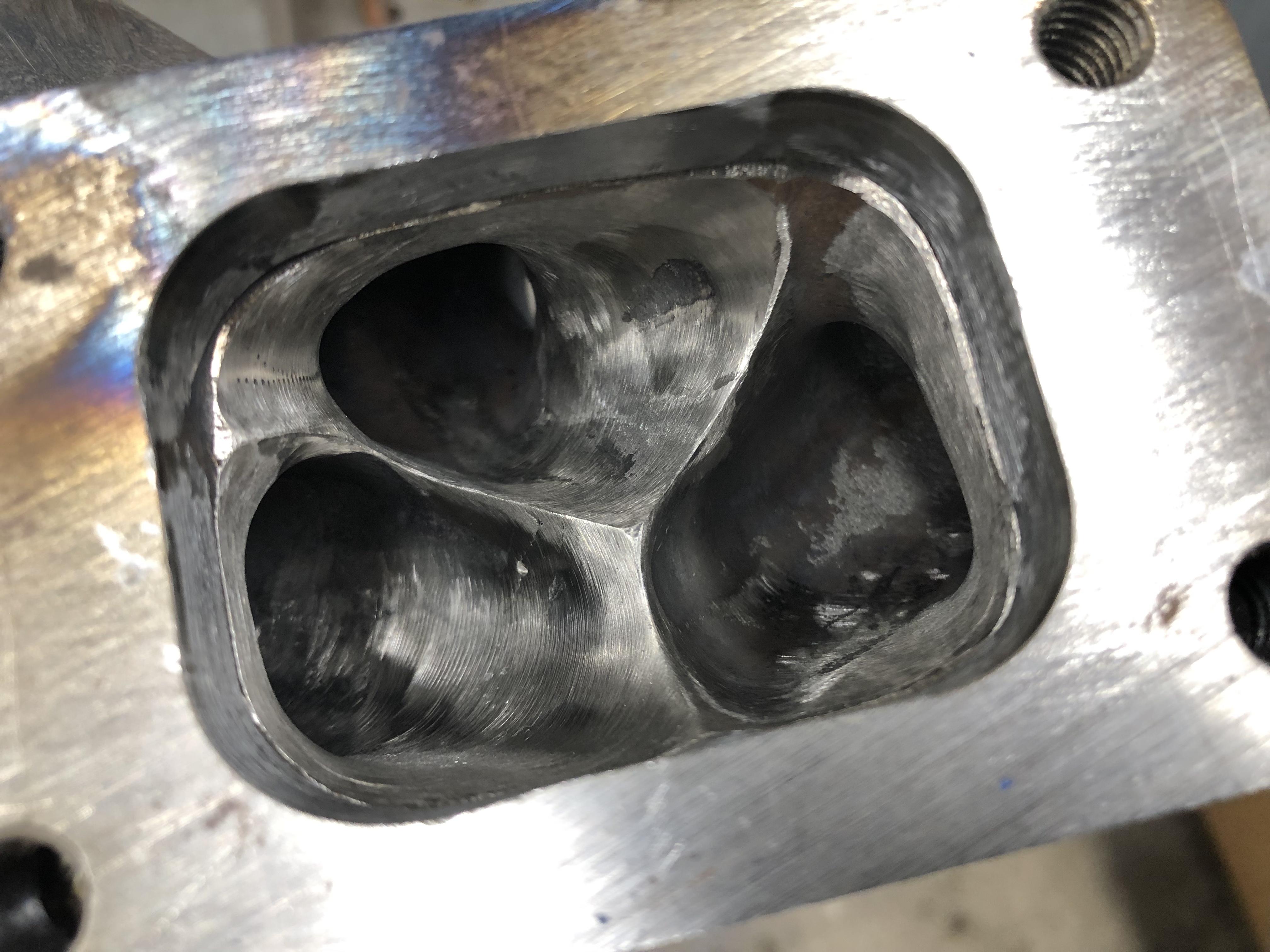

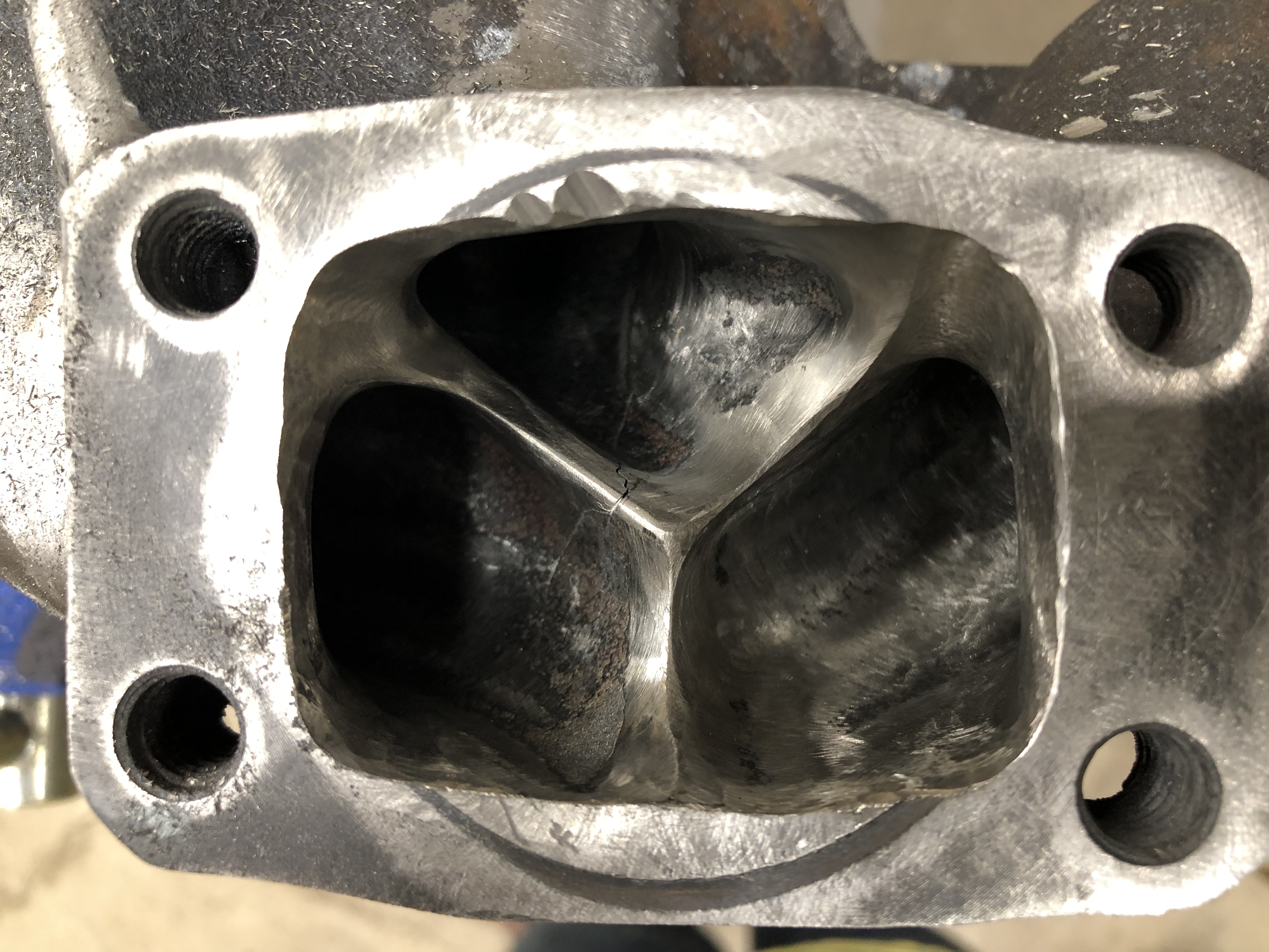

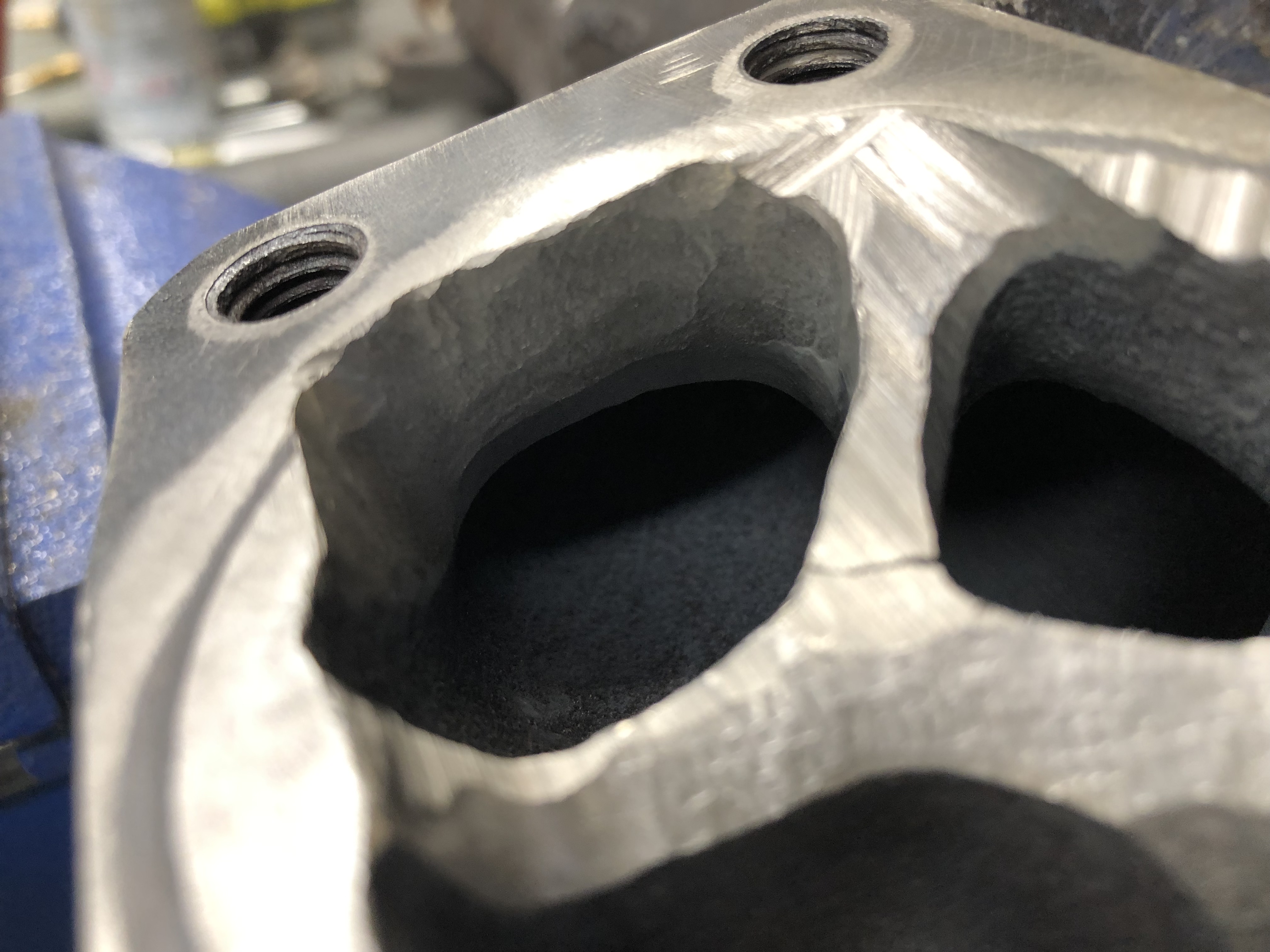

Finalized collector shape.
- B3BBC3B7-ABD7-4033-9FED-C7CA8FB93488.jpeg (2.22 MiB) Viewed 26092 times
- AECE764A-D012-4C6E-A301-CF53F27C670F.jpeg (2.39 MiB) Viewed 26092 times
- 24AA4F95-EA4C-4445-8E5F-806913D5A5B4.jpeg (2.38 MiB) Viewed 26092 times
- A79266DE-ECEC-4EA6-9074-26F978032C66.jpeg (2.16 MiB) Viewed 26092 times
- 11FBFC45-5C08-4D87-AB5D-26CC98A7B147.jpeg (2 MiB) Viewed 26092 times

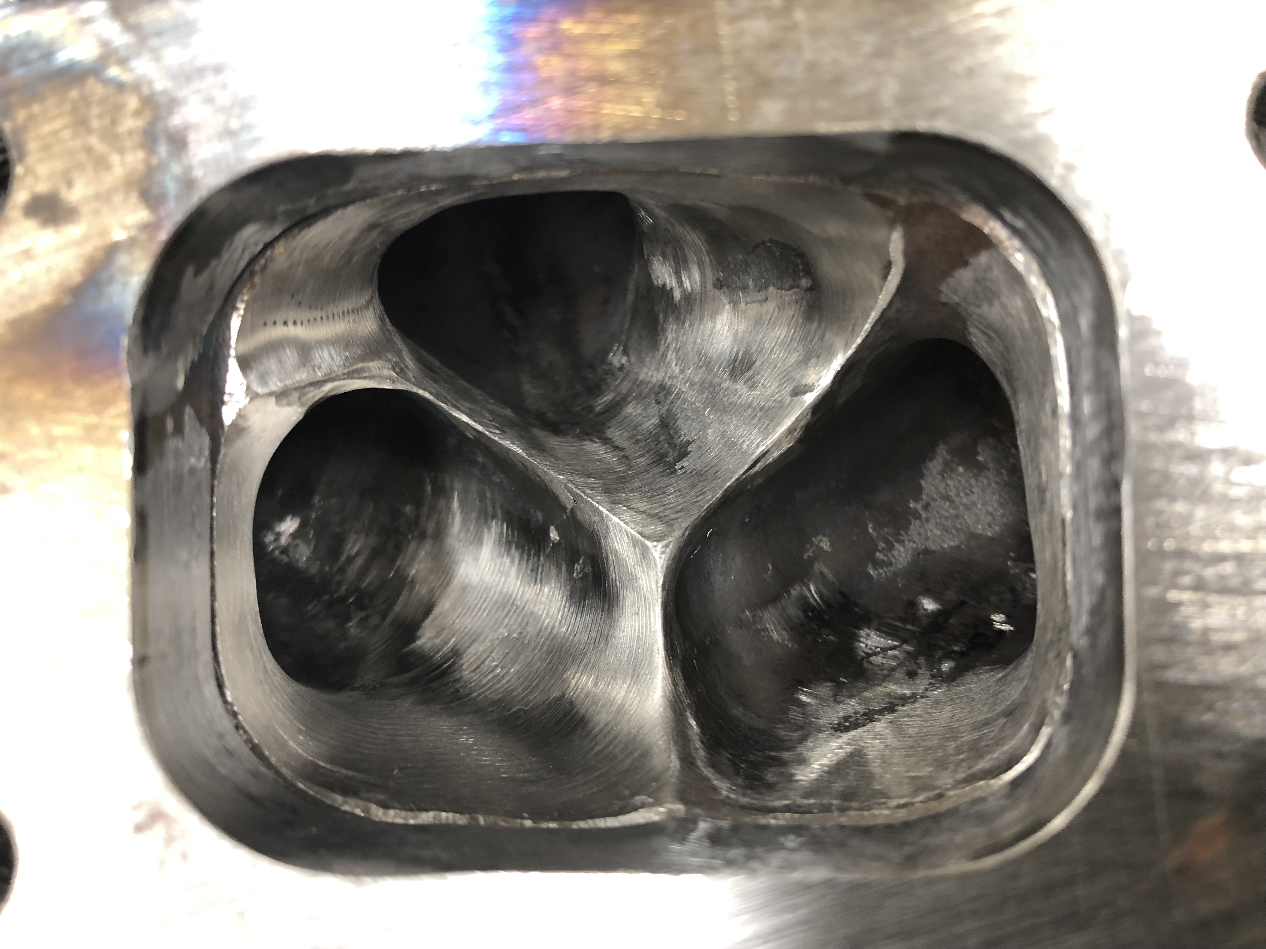

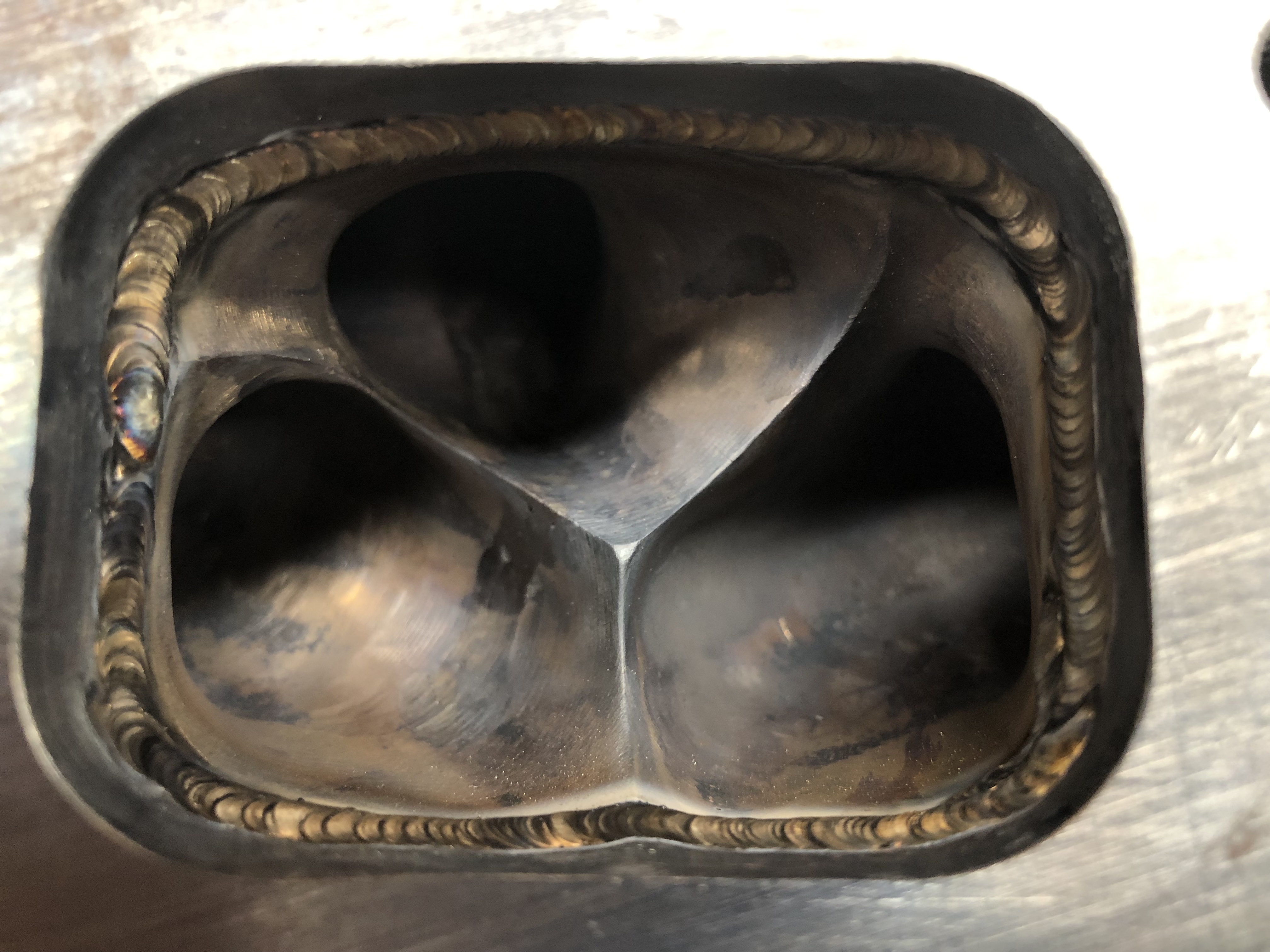

Inside of collector welded up.

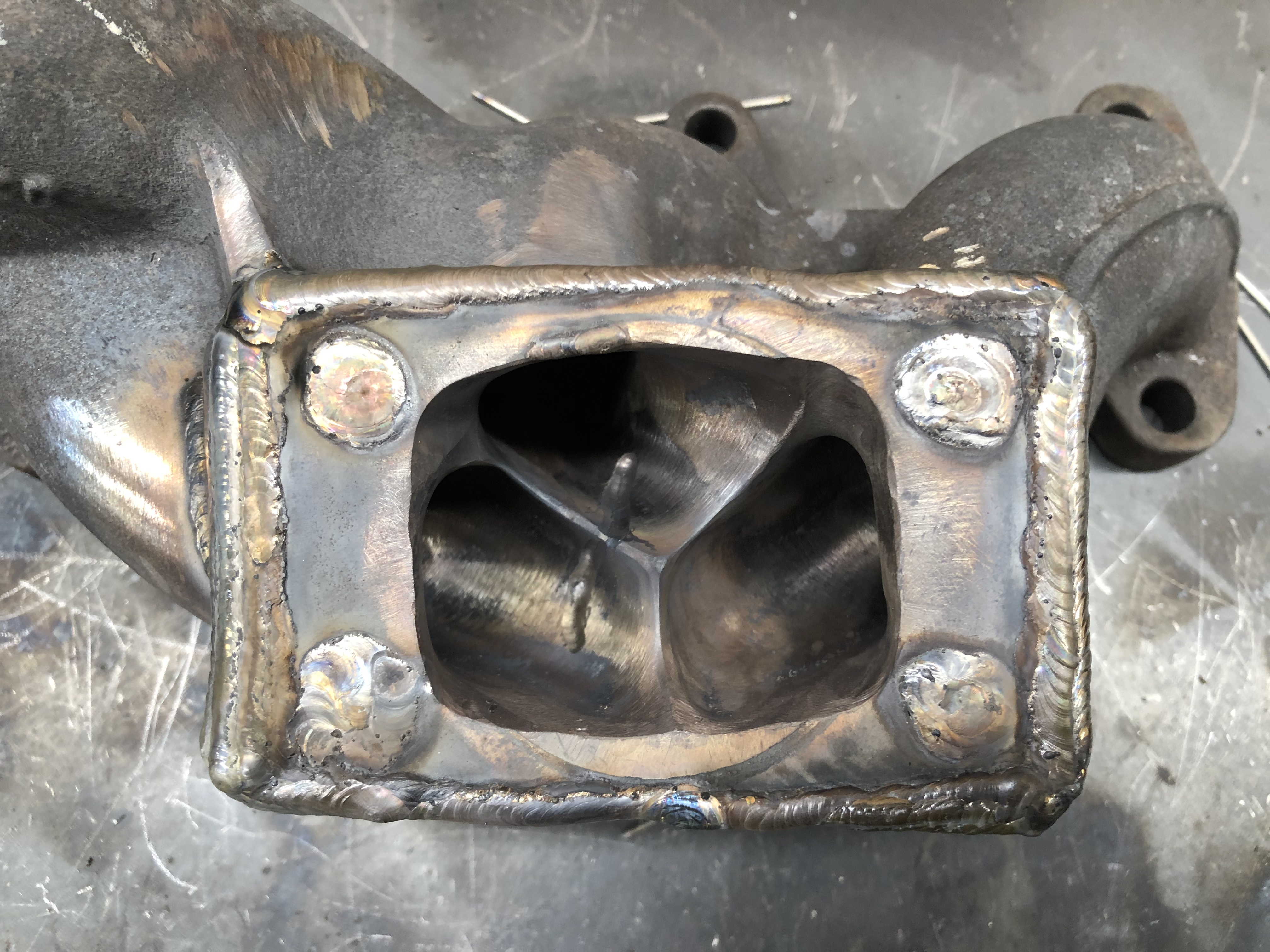

If this isn’t the most extensively worked-over OE 20vt exhaust manifold, I want to see the one that is!
I had some porosity problems on the outside flange welds, so I will be grinding those out and redoing them.
After that, I have to repair the other crack (outside radius of #4 close to the head.
Then I will gasket match the head flange, blend to the best of my ability, and set up a date for flowbenching this against a stock unit.
I have a Holset HY-35 that I plan to bolt to this once ready to install it.
That is a lot of welding done to that manifold. I hope you are pre/post heating, as well as very slow cooling. I welded my single piece manifold a number of years back with good results, at first. It has recently recracked, and it's right along the side of one of my welds around the runner.
I do look forward to your flow bench results. I'm having essentially a stainless log manifold made for factory placement.
Longitudinal
- Posts: 107
- Joined: Sun Mar 03, 2013 1:29 am
Oh, yes. That's cast iron welding 101--preheat, postheat, peen, slow cool.
