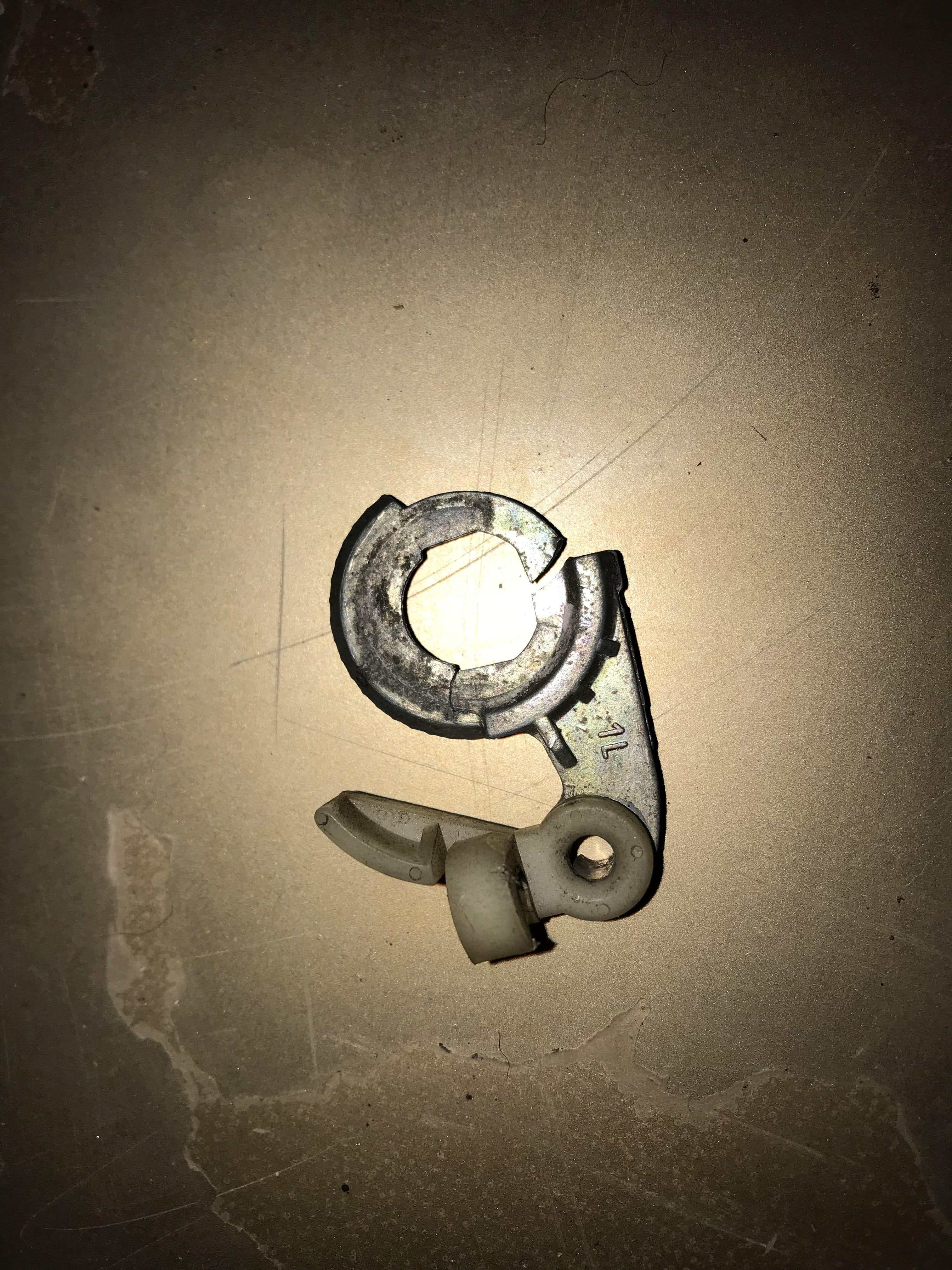

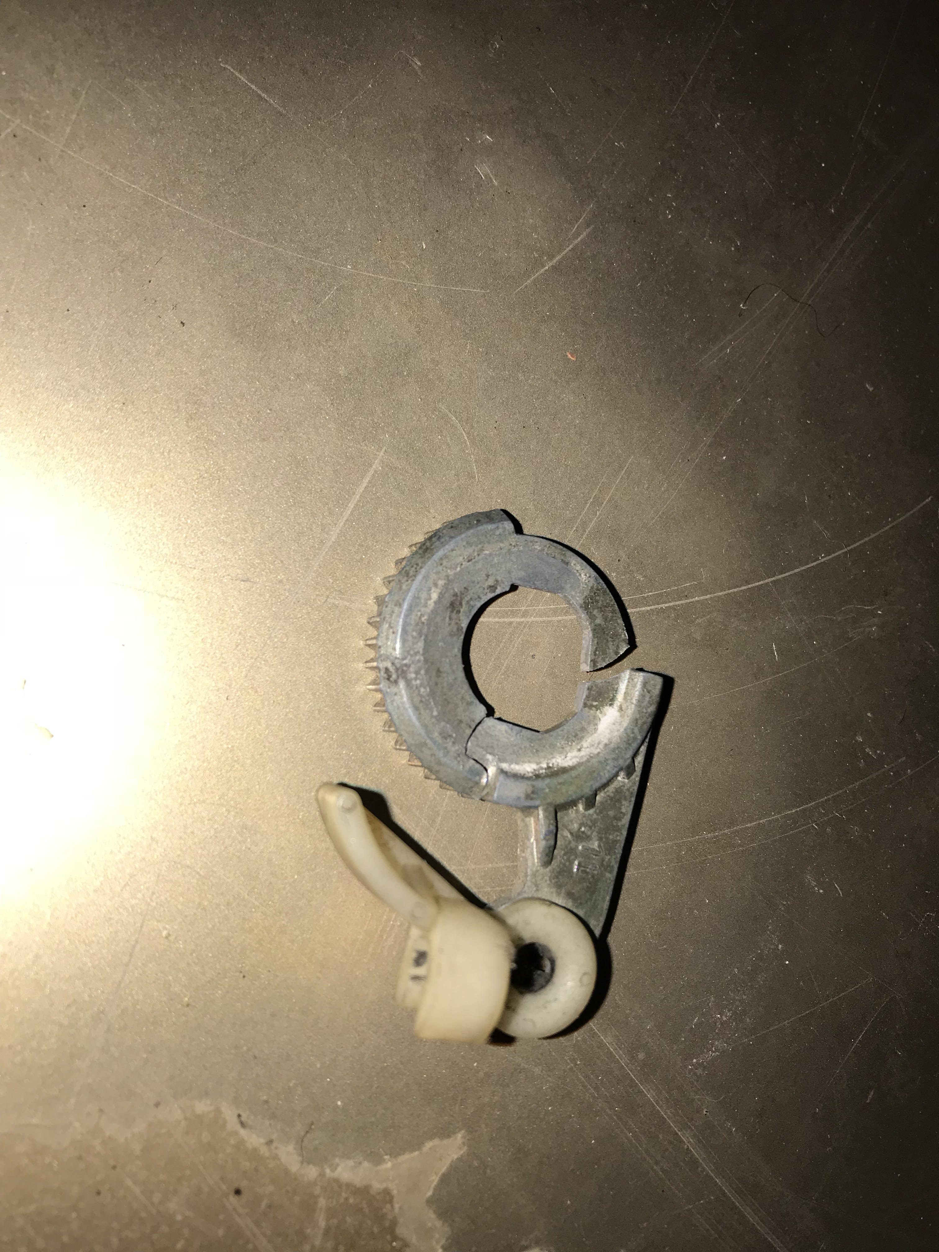

Looking for a driver side door handle for my 88 90Q. I specifically need a gear in the assembly, but if no one will sell me just the gear, I will buy a full door handle along with the gear(with or without the lock cylinder).
Here is the gear I am looking for (albeit a broken example), the only part that I actually need:

Used to be available from Audi, looks like they still are. I had to buy one for my old 90, and for an old 200q20v. Replacement part is stamped metal instead of the crappy cast pot metal original design.
From the old 20v.org, http://20v.org/doorroof.htm
893 837 287 D (driver's side)
893 837 288 D (passenger side)
