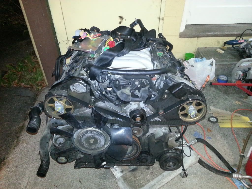

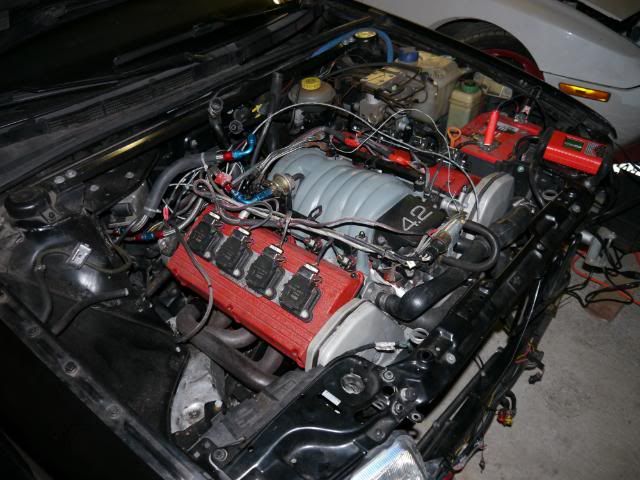

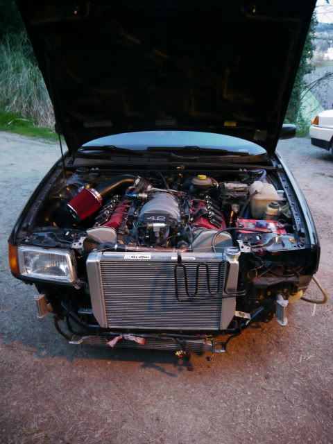

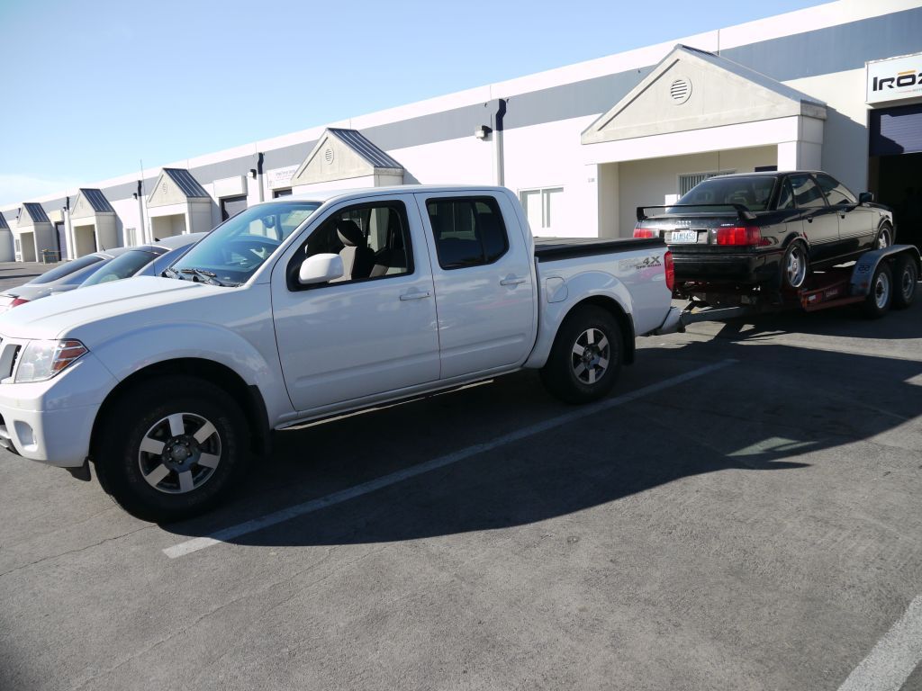

Now for the good stuff, pictures!
When I first towed it home:
Cyclops with the new rad:
Sleeper mode:

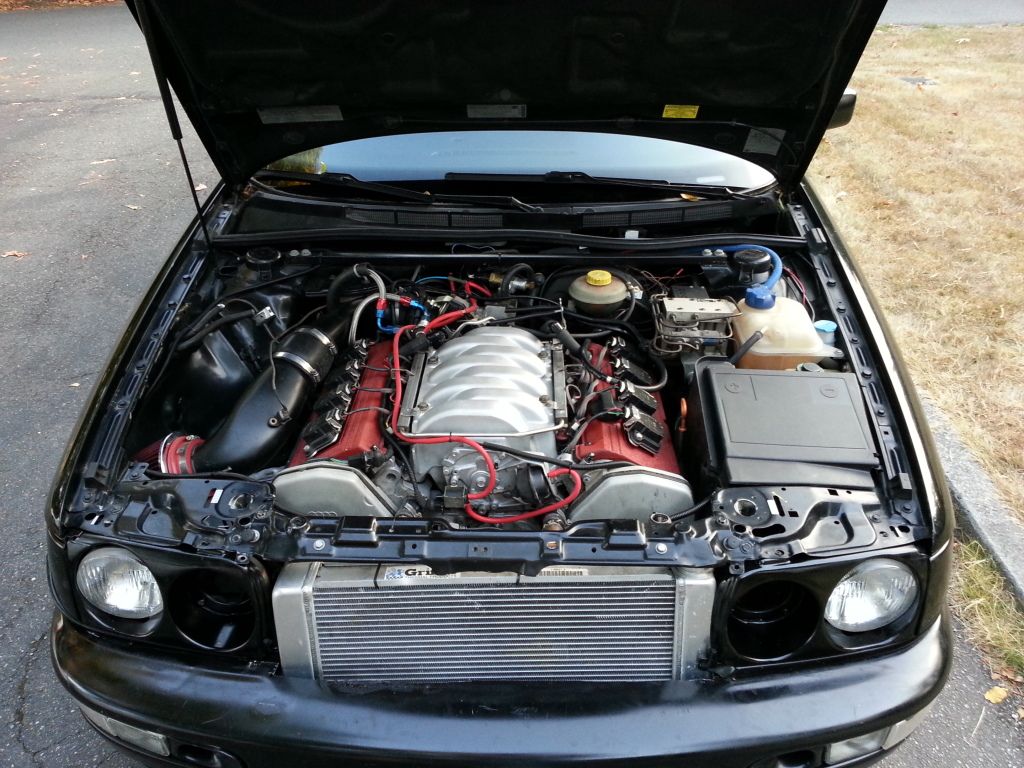

Most recent pictures, right before the Vegas voyage:
Towing home:

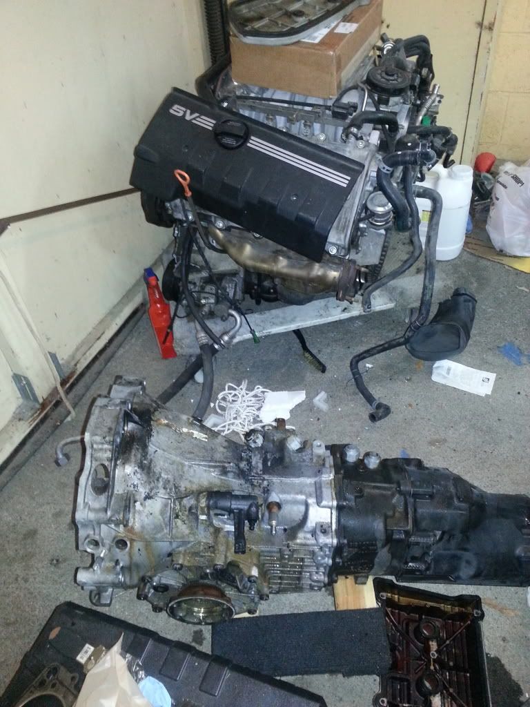

The future heart:
Sleeper mode:
Towing home:
The future heart:

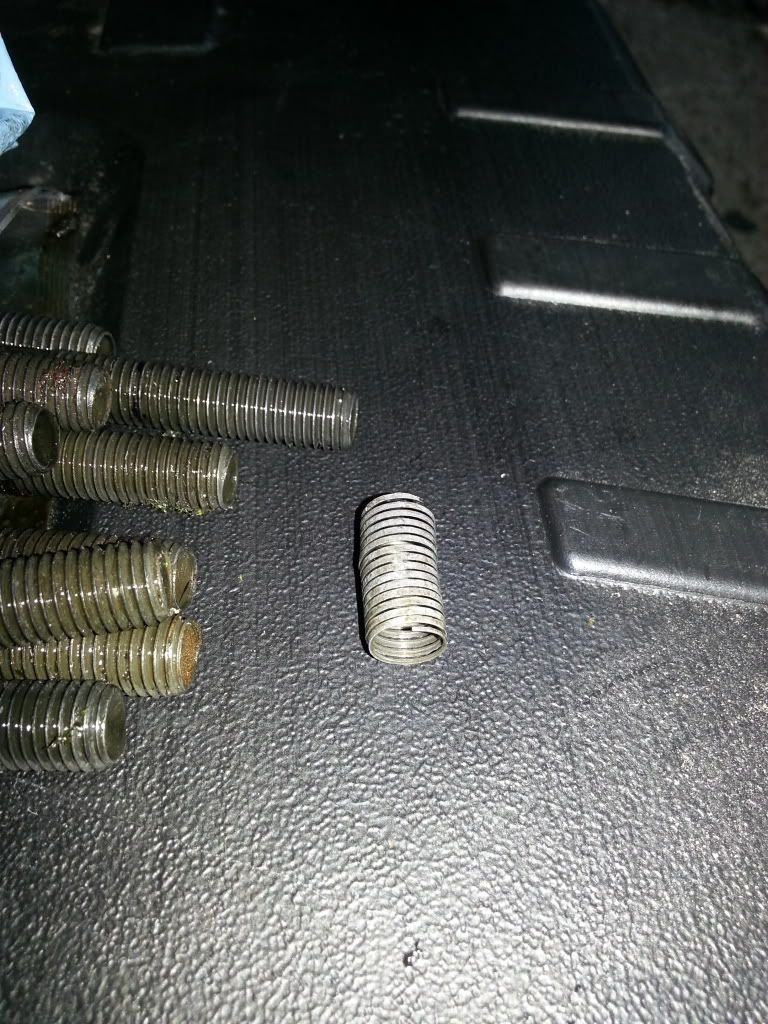

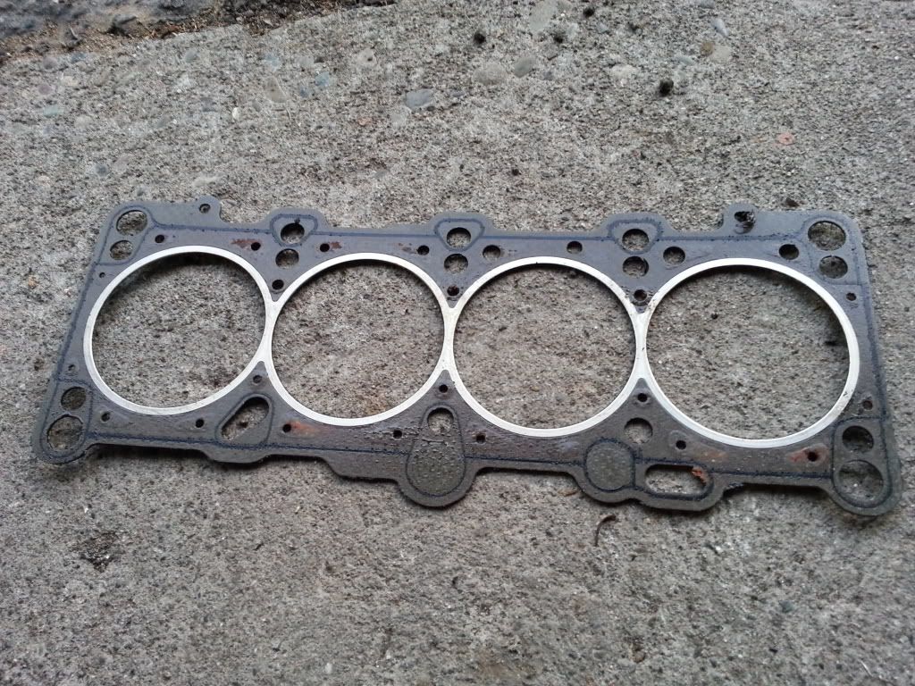

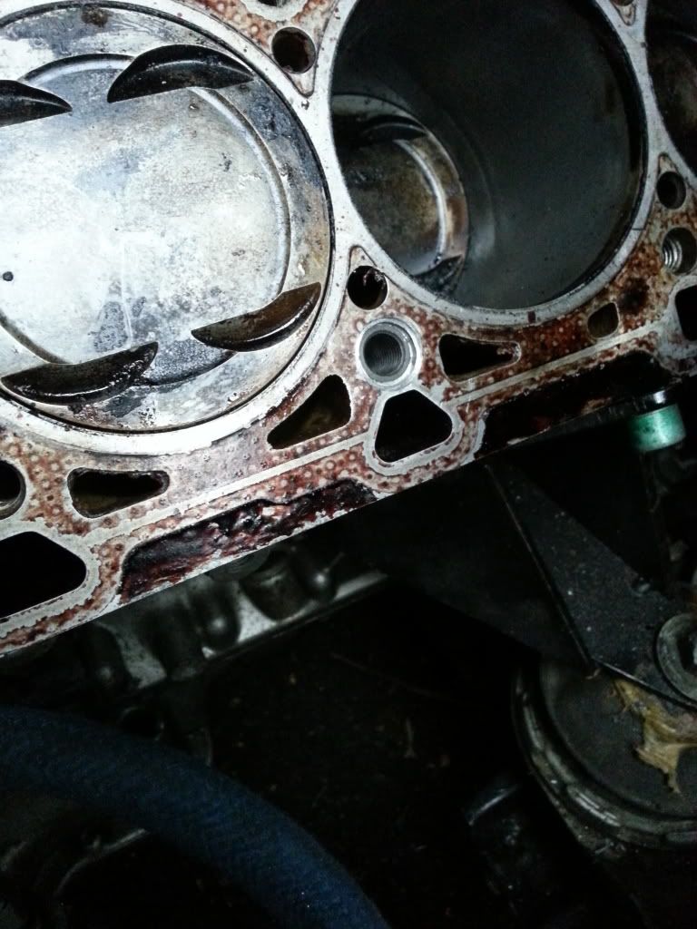

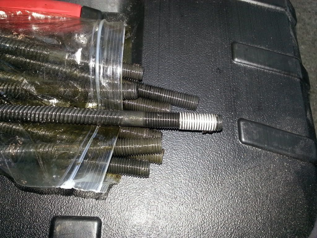

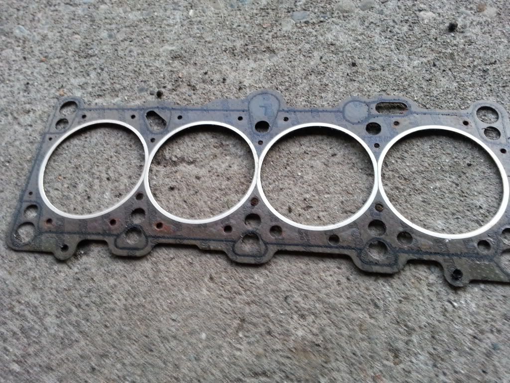

I decided to take a break from bodywork and engine assembly on the Porsche and pull the 90 apart to figure out what failed in Vegas last year. Quick back story, I drove the car from Seattle to Las Vegas for the BBQ and about 8hrs into the 19hr trip I started to have a misfire/stutter that kept getting worse. After a few days of troubleshooting in Vegas we realized the crankcase was getting pressurized. A pull of the valve cover found a stripped head bolt. We assumed this cause a leak in the head gasket which was in turn pressurizing the crankcase.
So, I got the head off today and trying to figure out what happened. The head bolt was definitely stripped (as shown in the picture below). However, the head gasket doesn't have any signs of failure and looks brand new (since it has probably 1500 miles on it). I'm obviously going to fix the stripped thread in the block and put a new head gasket on, but is there anything else I should look at while it's apart? Would a stripped head bolt be able to pressurize the crankcase without an obvious fault in the head gasket?
Head gasket:
Head bolt:
Head gasket:
Head bolt:
Re: Alex's V8 90QS : Mini-Ronin
That sucks Alex...
That's never fun to see...

Stripped headbolt thread has been fixed with a TimeSert (M11x1.5 x 30mm). Waiting on new headbolts and then it'll be put back together. Going to ceramic coat the exhaust manifolds while I have it apart to try and cut down on some engine bay temps.

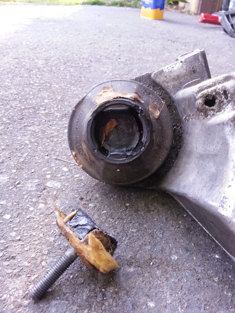

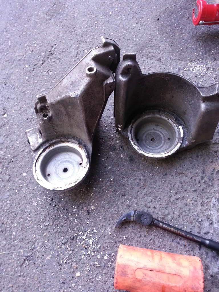

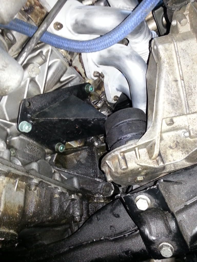

Took off my motor mounts to look at them as I figured they were on their way out. It's a good thing I did, the driver's side was completely separated. B4 are kinda similar to B5, but the mounts are crimped onto the aluminum housing. I decided to mod mine by cutting out the old mount and enlarging the center hole so a mount could be secured through it. I could use B5 mounts now, but I opted for something cheaper. Hockey pucks! 4 stacked together is pretty much the same height as the old mounts. Glued them together and then drilled them and mounted them. I should probably fab up some heatshields for them too. Took me visits to 4 different stores before I found a place that had pucks in stock this time of year. $30 later and I had a set of mounts.

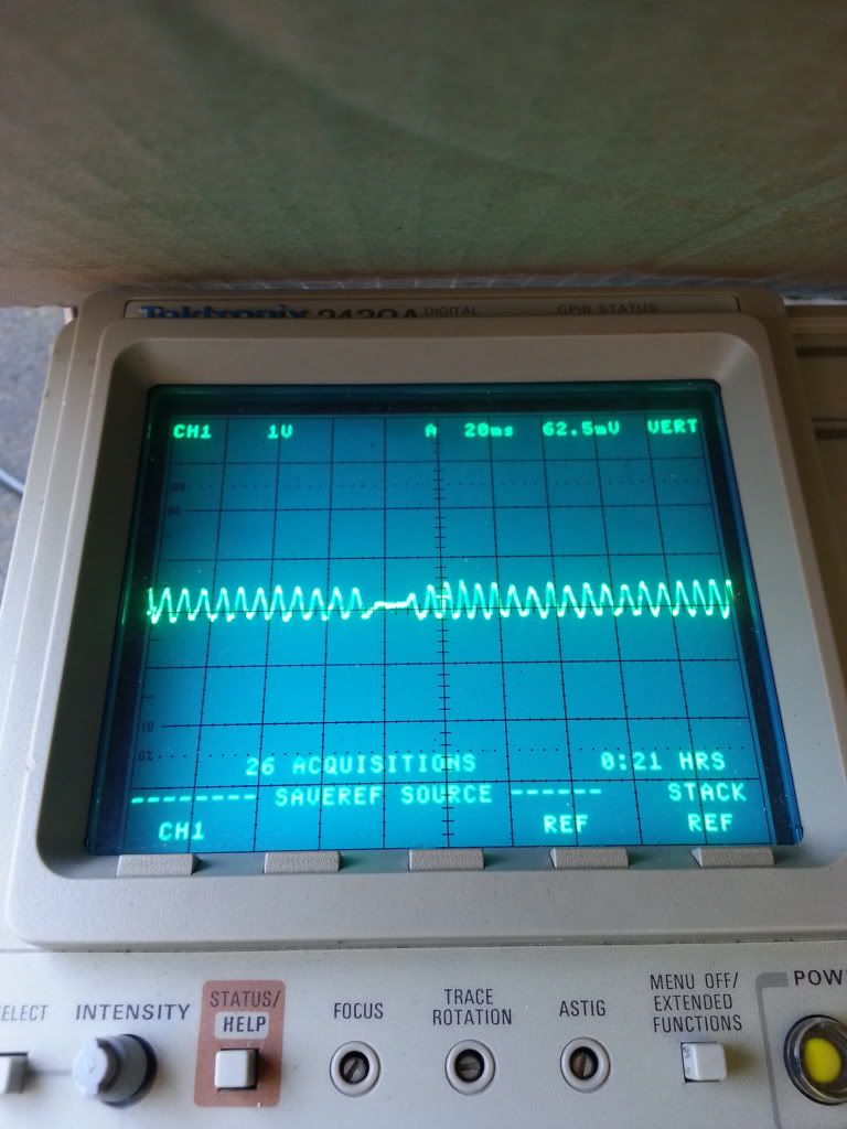

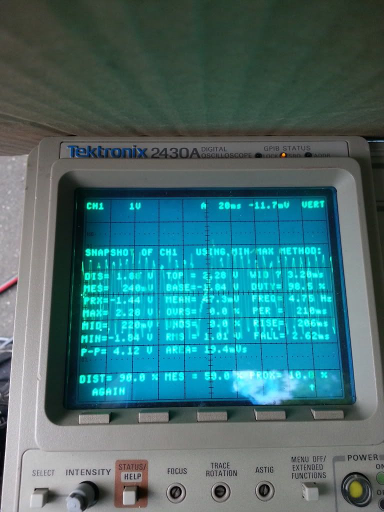

Re: Alex's V8 90QS : Nearly ressurected...DAMN CRANK TRIGGER

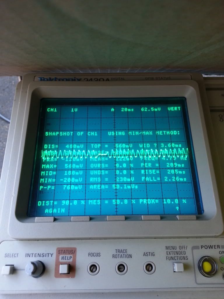

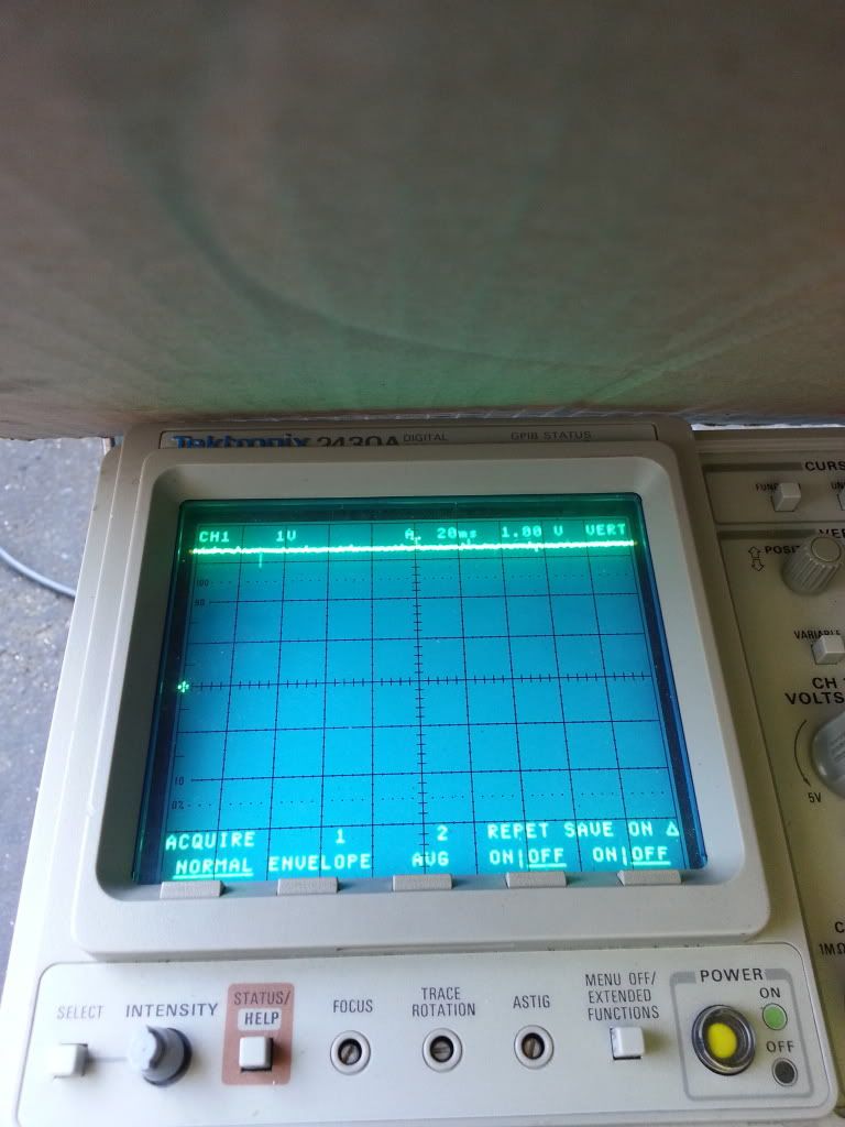

What I've done:
-Checked wiring. All is good from what I can tell. I redid this last time I had problems with aviation shielded wiring.
-Checked grounds. Redid ECU ground just in case. All good
-All coils and injectors working fine.
-Scoped trigger. Waveform looks good and is ~+/- 2Vppk
-Swapped polarity, but this didn't help. Set correctly and verified by scope.
-Sensor was new last time I had this problem. Measures ~1k ohms resistance.
-Gapped from 0.005 to 0.100 in steps of 0.005
Sensor set to 0.025" gap.
Measured at the sensor connector and at the ECU connector; both were the same.
4Vppk and correct polarity.
It looks like the wheel still has some runout (or the mounting on the crank is off), but it seems like it should be good enough right?
If this is the signal the ECU is seeing, why do I not see this on the software diagnostic scope and why am I not getting triggers?
I don't know what else to check.
Xpost in case any EE's or Marc have any ideas...
So, the past sensor measurements were without the ECU being plugged in (one at the sensor connector, one at the wiring harness ECU connector). This gives me 4Vppk.
When I plug the wiring harness into the ECU and then measure at the board connector or at the J3 VR jumper, I get a 0.760 Vppk signal.
If I measure at J4, I get a 3.3V DC offset upon key on and just noise during cranking.
Bad amp bringing the input down and no output?
TheArchitect wrote:Since you are so adept at running your scope, take the probe ground an put it to the power ground lead (big black wire on the PCB) and capture the wave form on the VR jumpered point on J4.
This is the post amplifier version of the VR sensor.
Set the trigger at 1v high to low transition with 1v per division Y axis setting.
This will tell us what the CPU sees as the trigger.
Also, have you tried disconnecting the coil/injector harness while cranking to see if those drivers are somehow to blame for lack of what looks to be a quality trigger signal?
