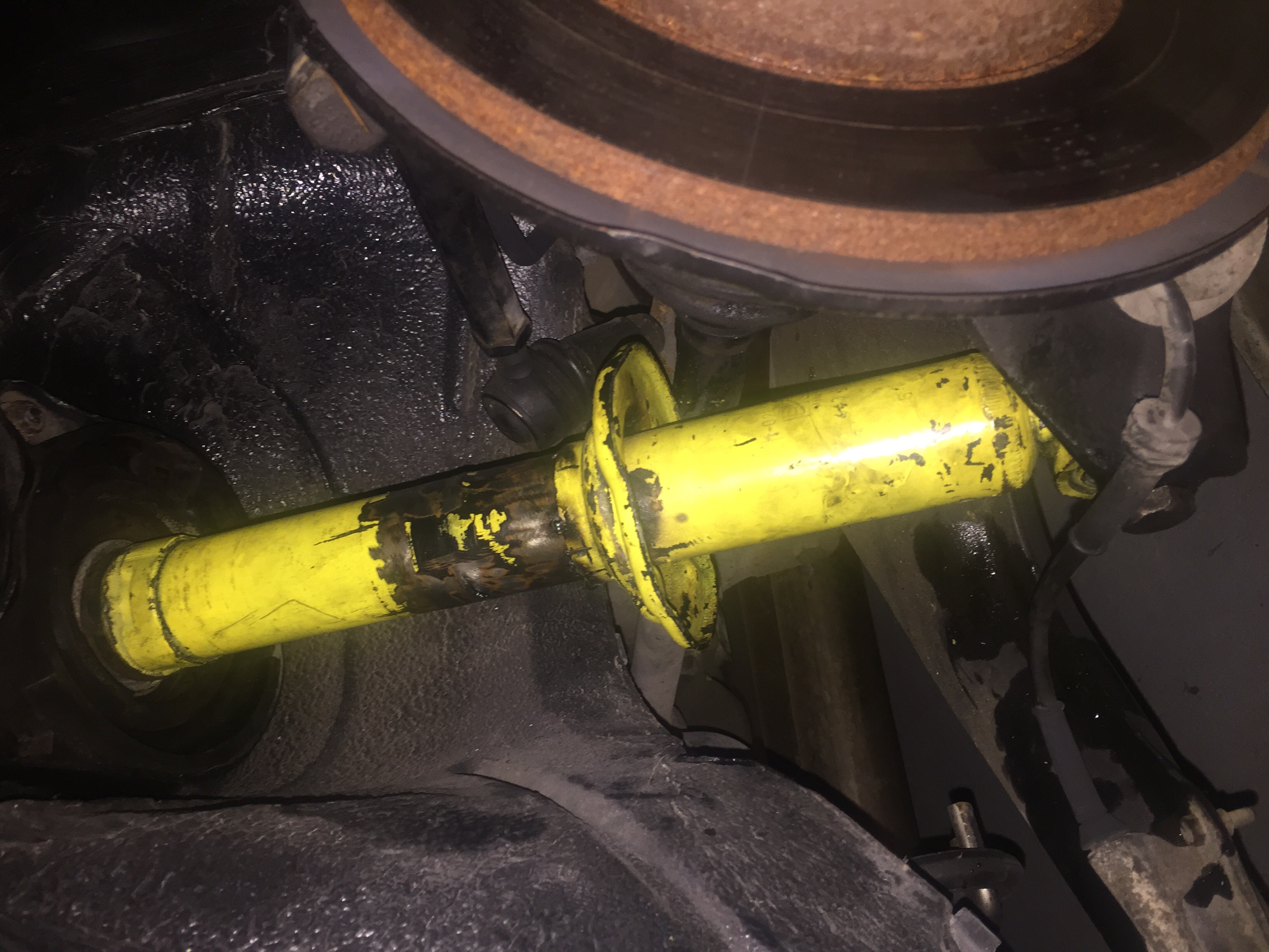

Here it is on the car

was that the shortest shock you could find? It seems that this shock would be close to constantly riding on the bumpstop. I am looking for a solution for the rear of my car. I put the shock in and raised the suspension up the the exact ride height I wanted to make the car level with the front and my rear shock is basically bottomed out. I need a shorter shock body. any suggestions... It seams like the part number you gave is only 1/2" shorter than factory
