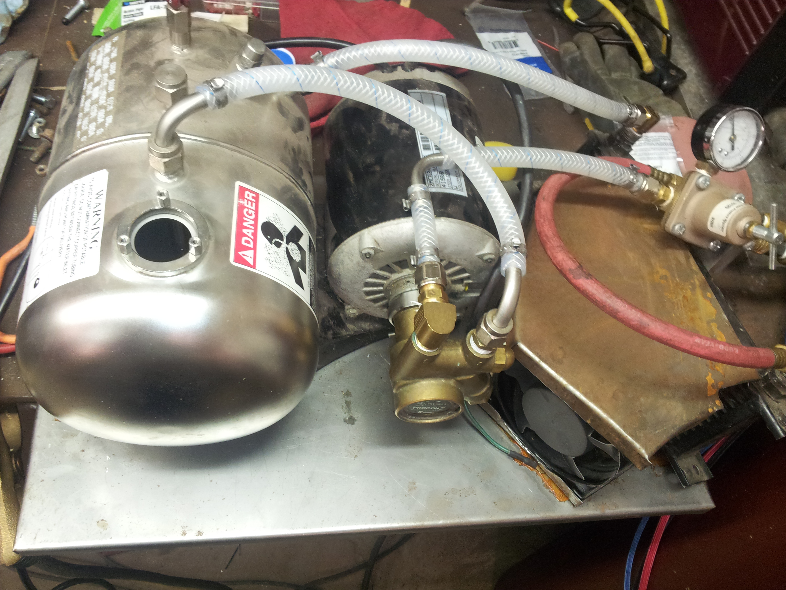

Here is a couple pictures of a homemade tig torch cooler I'm in the process of building. its actually functioning now but need to finish the case for it and mount everything, I found a few versions of this online so figured it couldn't be too hard.

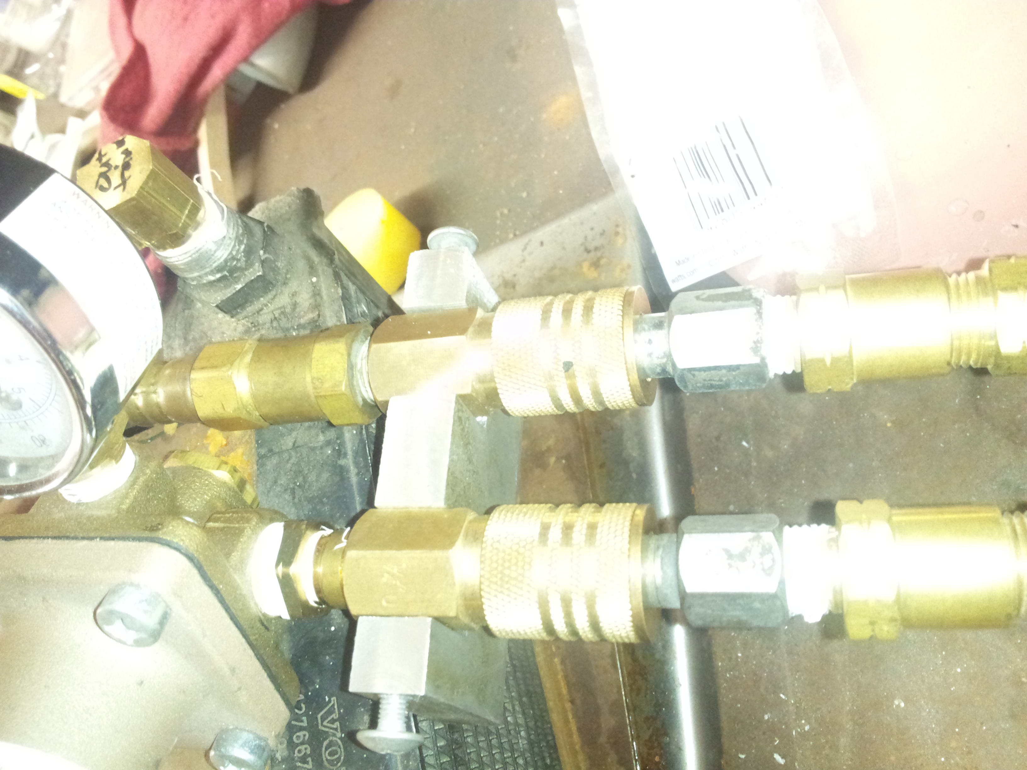

its built out of a fountain machine carbonator using a 740t oil cooler as a heat exchanger. i just used air disconnects on the lines with left hand thread adaptors, considering a miller coolmate cooler is 500+ this is going to work out perfect. I'll post finished pics in a week or so hopefully.
A little bracket i made on the bridgeport quick.  its going to mount to the back panel of the enclosure
