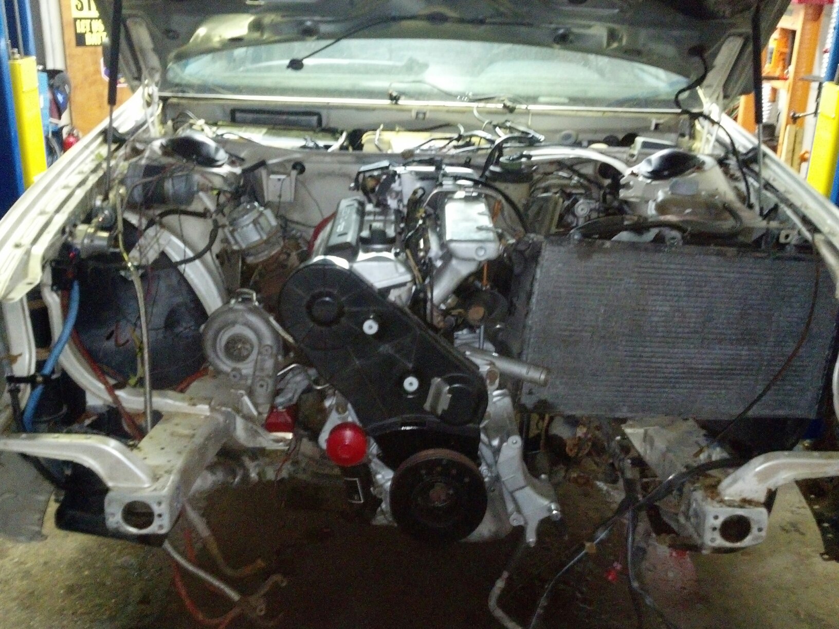

I guess it's time I make a thread on here.
Car:
1987 Audi 5000CS Quattro
Engine:
NF bottom end
7A head and cams
7A oil pan with extension
60-2 rear crank seal (no provisions for the factory sensors)
VEMS ECU
aaaand I guess pics...

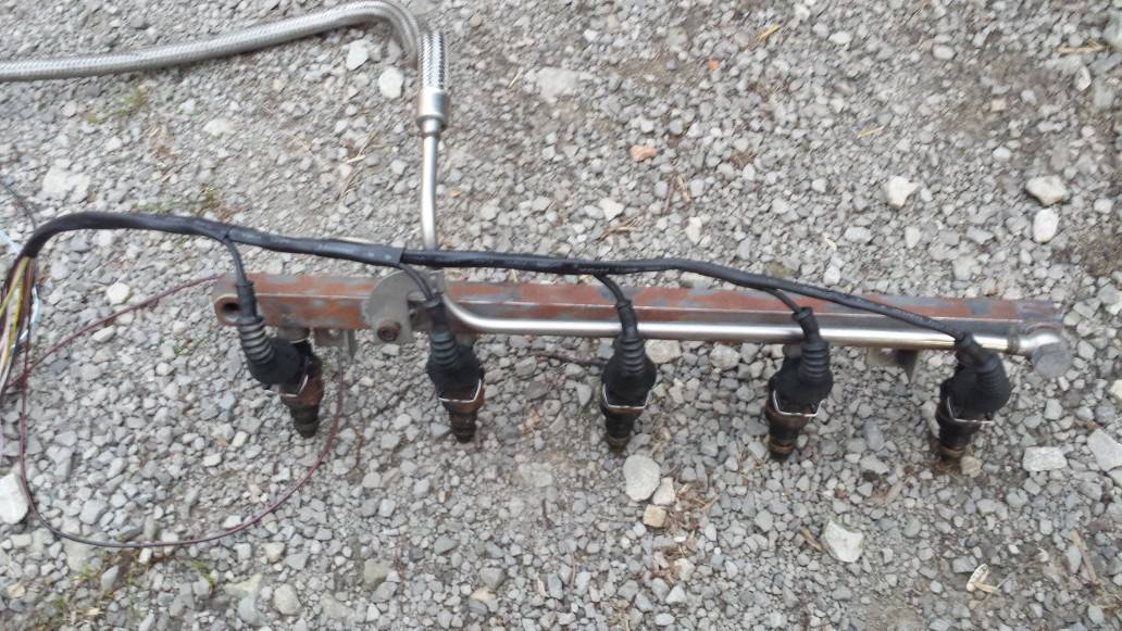

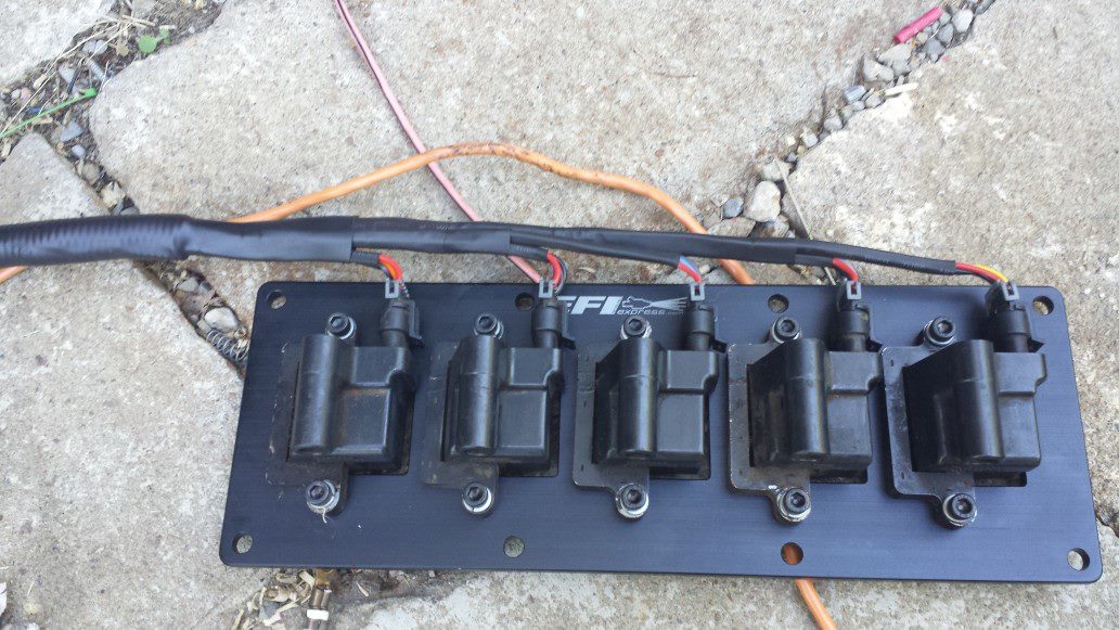

Which knock sensors should I buy to use? I can grab one off of a parts 5k for now/mocking up. Just wondering where to buy from.
Aaaaaand wiring progress. All I have left is ECU side and the crank sensor.

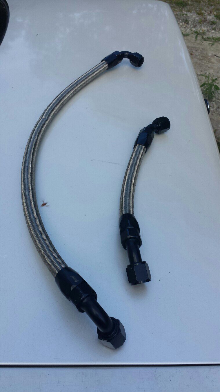

Baby's first braided lines. Oil cooler lines, specifically.
Sent from my SCH-I545 using Tapatalk 4
Re: Gtn116's 5k 20vt
Dem purdy
