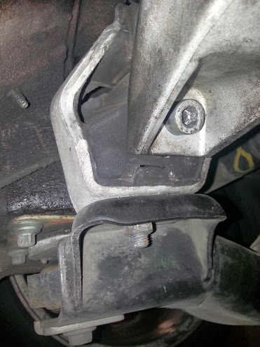

So I think I found the root of the grinding noise i'm getting at low RPM's. I took a look at my transmission mounts and this is what I found....
bad trans mount.jpg (52.88 KiB) Viewed 53801 times
Both sides are completely shot. Luckily was in the seattle area and saw a craigslist ad for a guy selling his 034 track density mounts. I will be installing them tomorrow. Anybody have experience with these? Is the NVH really bad? Either way it will be a huge improvement.

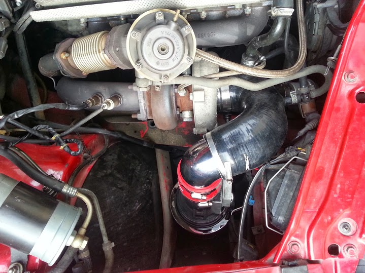

In other news I installed clear corners, messed with building an intake that I think should work, blacked out the grill (not sure if I like it) and played around in the snow. :thumbsup:
Not sure how much I like this intake set up. Looks kinda crappy, but the location of the filter seems good and it sounds great too... :D
I will upload pics of the trans mounts out of the car tomorrow and update if that solves my noise issue.

Are you guys recommending the stock box based off aesthetics, or performance? I remember reading once on 034's website that the stock box becomes pretty restrictive when you get into higher horsepower. Is there truth to this? If so do you think our airboxes would benefit from something like the Darintake mod the b5 s4 guys do? Do most people end up using a cone filter intake setup since they run different exhaust manifolds and cant use the stock box?
Re: 93 Red URS4 Build
The stock airbox is not restrictive at all and provides a TRUE "cold air" intake, pulling air directly from the front grill. It also provides much better air filtration than a crappy cone filter.
At higher power levels, the MAF becomes the most restrictive part of the intake. The airbox can actually build positive pressure at speed due to a "ram-air" effect of scooping air from the high pressure area in the front of the car.
PS - don't believe anything you read on 034's website :)

BLAKEnwURS wrote:Are you guys recommending the stock box based off aesthetics, or performance? I remember reading once on 034's website that the stock box becomes pretty restrictive when you get into higher horsepower. Is there truth to this? If so do you think our airboxes would benefit from something like the Darintake mod the b5 s4 guys do? Do most people end up using a cone filter intake setup since they run different exhaust manifolds and cant use the stock box?
I think they are recommending it due to the fact your air filter is pretty close to your turbo without any shielding. It might flow more then the stock intake box setup, :idunno: But if the in coming air charge is significantly warmer then you aren't gaining much. The veterans will correct me if im wrong
If your staying with the 3071, Id say use the stock intake box with a K&N drop-in filter.

Thanks for the tip. Stock box it is. I looked on 034s website and it would appear as though they removed that claim in their ad for their intake setup. :lol:
Sent from my GT-N7105 using Tapatalk 2
If you have a header/turbo setup that prevents the airbox from fitting, then it's time to come up with an alternative solution. Otherwise, keep it as long as you can. I ran a 3071 on an RS2 manifold with the stock airbox, no issues.

EDIGREG wrote:If you have a header/turbo setup that prevents the airbox from fitting, then it's time to come up with an alternative solution. Otherwise, keep it as long as you can. I ran a 3071 on an RS2 manifold with the stock airbox, no issues.
Thats what I figured. But the inlet hose was trimmed when the turbo was installed according to the recepits. Which apparently led to it having very poor fitment for some reason. I tried multiple times to get it securely mounted but it slipped off. So until I get a new hose, or come up with a new solution, this will be my set up for the next couple of weeks.
Here's a picture of the fitment with the stock box. As you can see its about to slip off the turbo and the maf.
