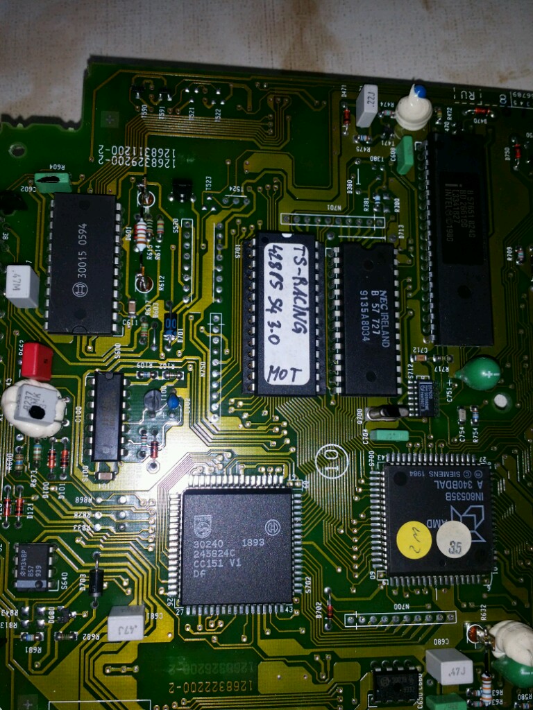

For starters you must have a modified ECU that has chip sockets installed to do this. I posted in this thread what you have to do to get setup and socket you ECU.
[url]http://www.s2forum.com/forum/showthread.php?t=63826"]http://www.s2forum.com/forum/showthread.php?t=63826[/url]

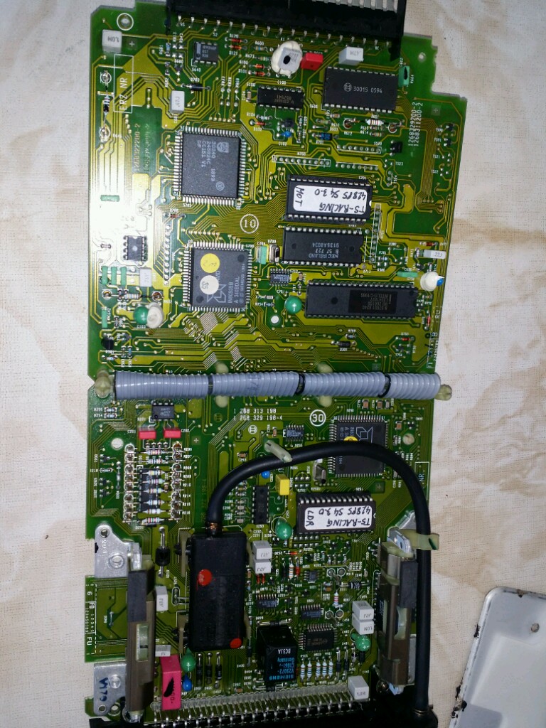

Hey, first of all i want to apologize for may bad english ;) I am from germany and followed you post very interested, here and in the s2-forum.
I now have installed a WOT-Box, but i either generate flames nor boost, just about 0,5bar at around 6000rpm. notice, i got an S2 Avant with RS2 Step and some more around 420hp. K26/27 hyprid, Borla exhaust and decat. just like yours :)
I think i can solder this, but i got some general questions:
- Is it sufficient to replace the socket only for the fuel/ignition part?
- Its an RS2 ECU with 300kpa MAP sensor and Chiptuning.
- Is it possible to read from the old chip, modify this and write to the new Chip?
- Where is the plug located? The photo looks like it is around the ECU? but i dont got such a plug around my ECU (Reminding installation of the WOT box) -> maybe i have to cut into my harness, do you know which PIN at ECU?

KevinRS
Posts: 16
Joined: Sun Jun 28, 2015 4:07 am
Location: Germany
Re: Motronic 2.3.2 ignition cut launch control
Post by KevinRS »
So, i opened my ECU, and what i see is, there is already a solded socket for the fuel/ignition. Isnt it?
I got 2 photos, it must be the chip where's written MOT
EDIT: this chip is an Atmel AT27C512R
