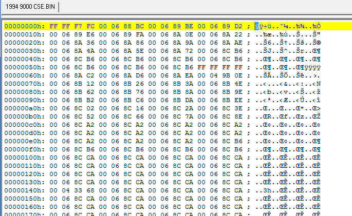

This is the procedure i use to correct the checksum for the boost chip. The first thing your going to want to do is go download a copy of HxD hex editor.
Here's a link to the download page for it, pick the language that suites you best.
http://mh-nexus.de/en/downloads.php?product=HxD
once ya have that open your modified 32k boost chip BIN file in HxD. highlight from 0x0000 to 0x3FFF. next you'll want to click analysis up top and pick checksum. with the little window open pick "Checksum-16" and make sure the region radio button is highlighted. and say OK. after that a window will pop up showing the 16 bit checksum.
That part of the checksum goes at at offset 0X3FFA and ends at 0X3FFB. now for the next 2 sets of bits in the checksum. these have to be inverted and to do so you must take the checksum you calculated with HxD and subtract it from FFFF. once you have those values input them into offset 0-3ffC and offset 0x3ffD. Oh and the last to sets of bits ar ethe ECU's internal number. To do this math easily you can simply use the calculator in windows. To do that open it up, click view and than programmer. once that is up make sure you click the radio button on the left for HEX and your good to go to calculate the second half of the checksum.
Here is the example from RS4BOOST. These example are from stock bainaries for so you can see what is exactly changed.
xx = 16Bit Checksum of the complete binary file
yy = binary complement of xx => FFFF - xx
zz is an internal Bosch build number of the file
Here different examples for the last 6 Bytes (xx yy zz):
Audi S2 - ABY - M2.3.2
895907551A* *- 0261203145 - 1267357519
...F9 D9* *06 26* *A1 47 => FFFF - F9D9 = 0626
Audi S6 - AAN - M2.3.2
4A0907551C - 0261203601 - 1267358644
...0A 96* *F5 69* *A2 45 => FFFF - 0A96 = F569
Audi RS2 - ADU - M2.3.2
8A0907551C* - 0261203543 - 1267358647
...AA 37* *55 C8* *A2 53 => FFFF - AA37 = 55C8

To actually read (and write) the chip(s) you need something called an "EPROM programmer". It hooks to your computer and has a chip socket on it... you plug the chip in, fire up the software on the PC, tell the software what kind of chip it is, and hit "read" and out comes the data.
But that's where the real fun begins. The program may have been created in a common programming language like C++ (or more likely C) but what's in the chip is not readable programming language. It's just a bunch of bytes like this:
At that point either you or a specialized piece of software has to go through all those bytes and figure out what's going on. And there are a lot of them... many thousands.
I'm also using the term "bytes" a little generically. If the CPU in the ECU is 8-bit, it processes one byte at a time. 16-bit CPUs access them in pairs (usually sometimes), and 32-bit CPUs access them in groups of 4 (again, sometimes but not always).

What year 900T? Or more specifically, first-gen or second?
For a second-gen car (with Trionic engine management) you don't really "burn a chip", the data is in flash memory. And there's a whole web community dedicated to reprogramming Trionic... take a look at http://ecuproject.com/index.html.
If it's a first-gen car with LH engine management, there are a few people out there doing chips for them that I can give you info on if you want. But that system is pretty limited - if you want crazy power (and don't mind replacing transmissions constantly ;) ), you might have to upgrade the engine to Trionic. But that's not a small task.
