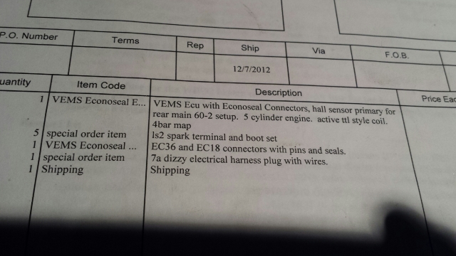

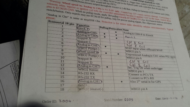

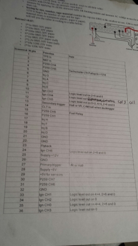

I didn't get the serial number yet but he sent me these pictures.

actually the serial number is in the second picture at the bottom, i just realized it. its 6505.
