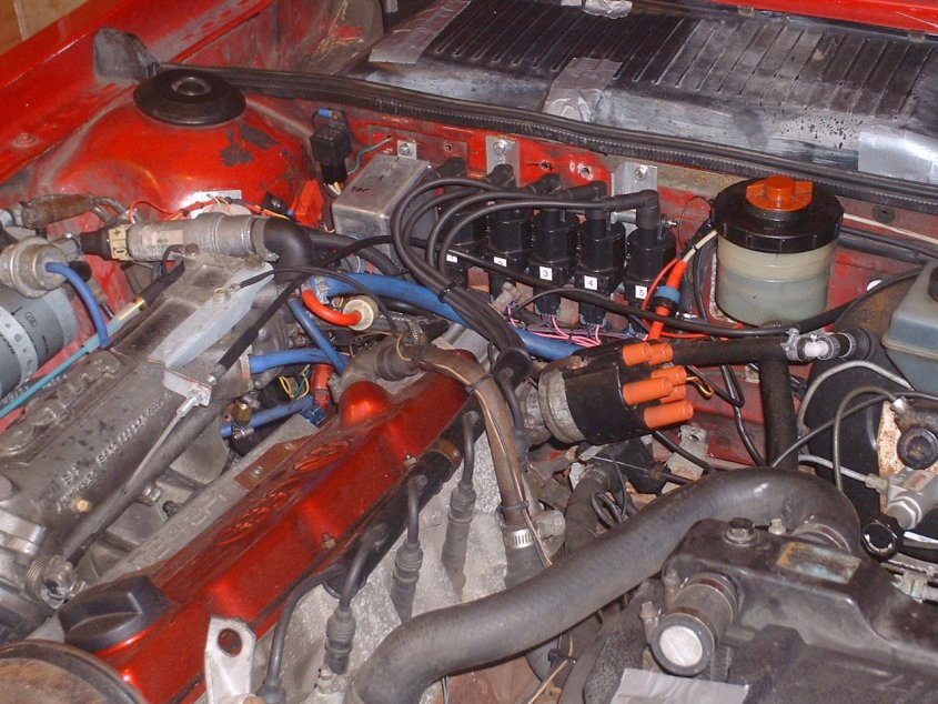

elaw
Posts: 853
Location: MA, USA
Re: Other factory management options for AAN.
Post by elaw »
Keep in mind that as far as the engine management system is concerned, "coil per plug" is the same as "coil on plug"...
Eric Law

elaw
Posts: 853
Location: MA, USA
Post by elaw »
Yeah one thing I failed to mention that I found amazing when I first built the setup is the Audi wires fit *perfectly* onto the LSx coils. I was all worried about having to cut the wires up and put new ends on but they just worked as-is.
Eric Law
