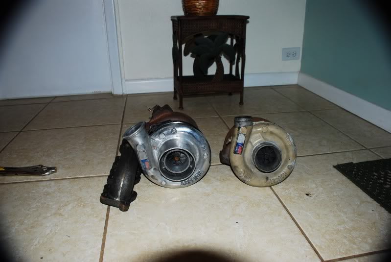

My friend Nathan and I picked up another H1C the other day for his Honda. Found it on craigslist, and when we got there I was pretty surprised. I've had both the big and the small H1C, but I guess I forgot there was a medium one. Mine is 56mm comp wheel inducer, the medium one has a 50mm inducer. The exducers are both 82mm on the comp wheel though, and of course the exhaust wheels are identical.
Here they are together
