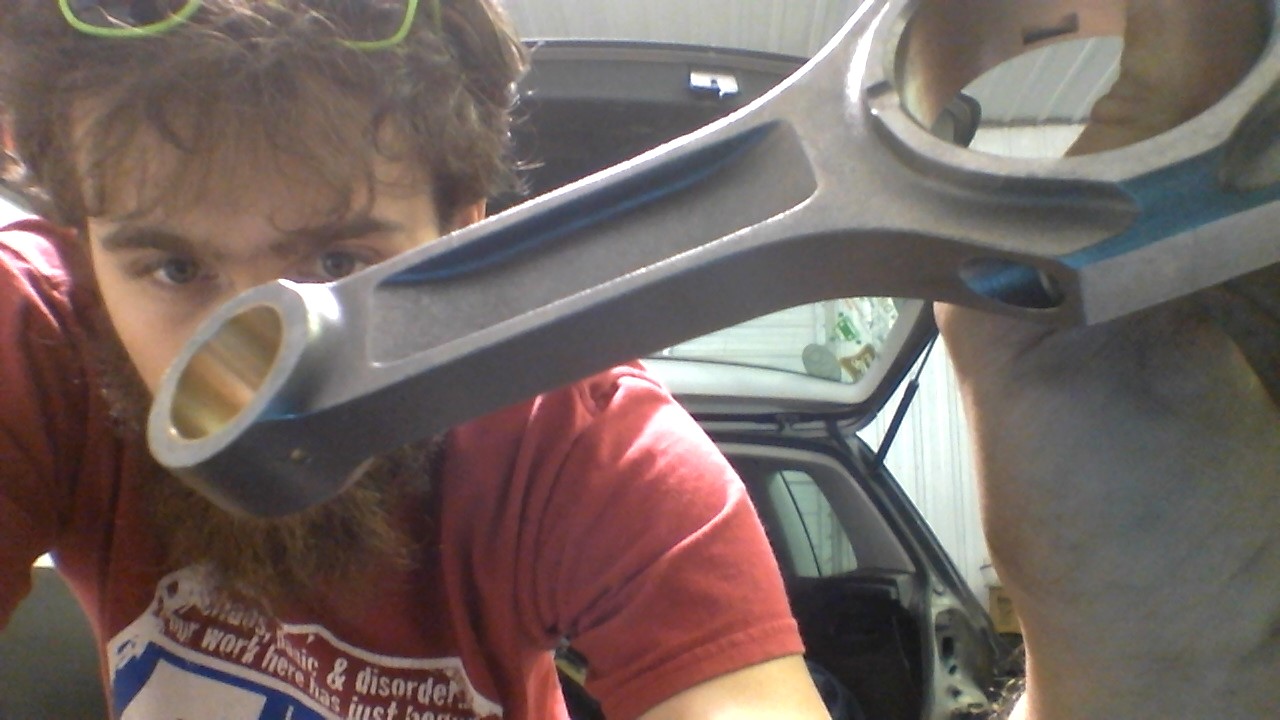

Rods
Rods

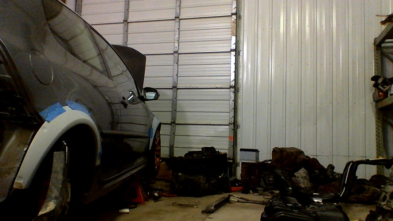

Flares test fitting
Flares test fitting

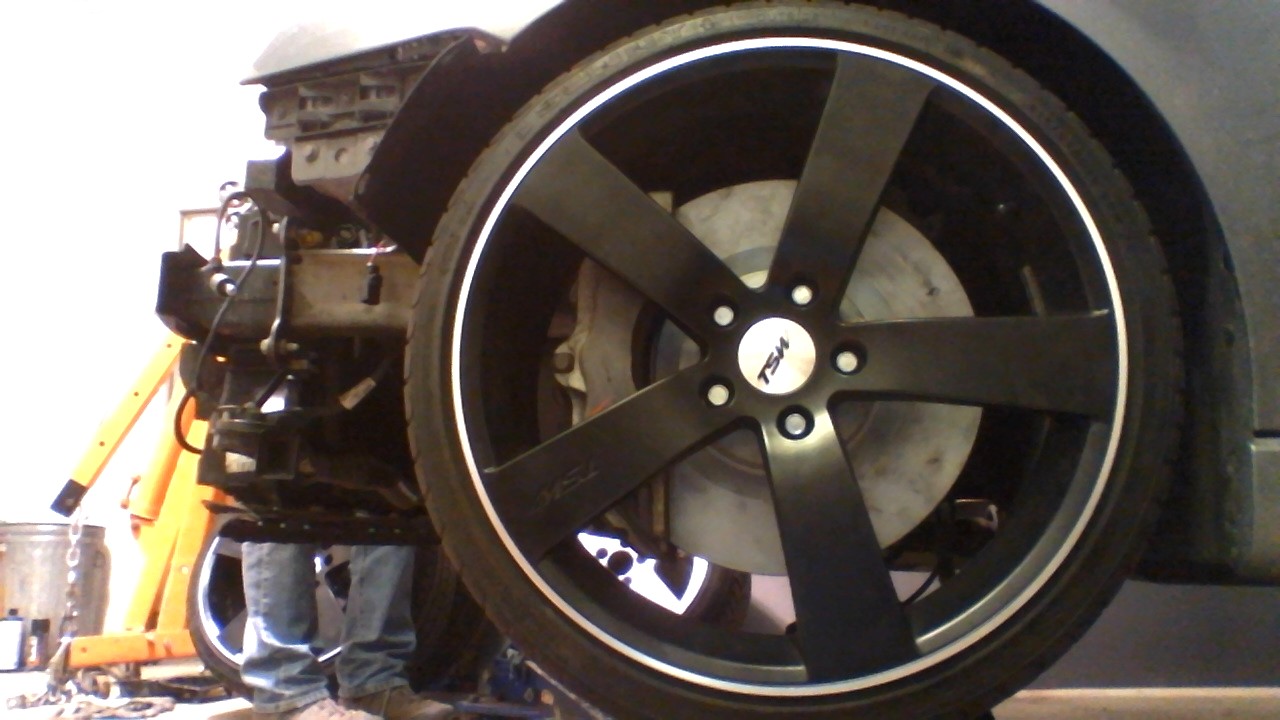

18z brakes under TSW wheels

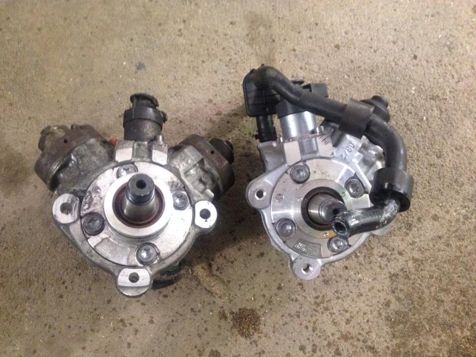

well got some more work done, seems the new fuel pump will work quite nicely once i build a small spacer shim to move it back, but the gear and everything swaps straight across from the VW pump. So I should have that issue resolved, next figuring out the fuel lines on the new rail.
CP4.2 from duramax next to the cp4.1 from the VW notice how much bigger it is.
