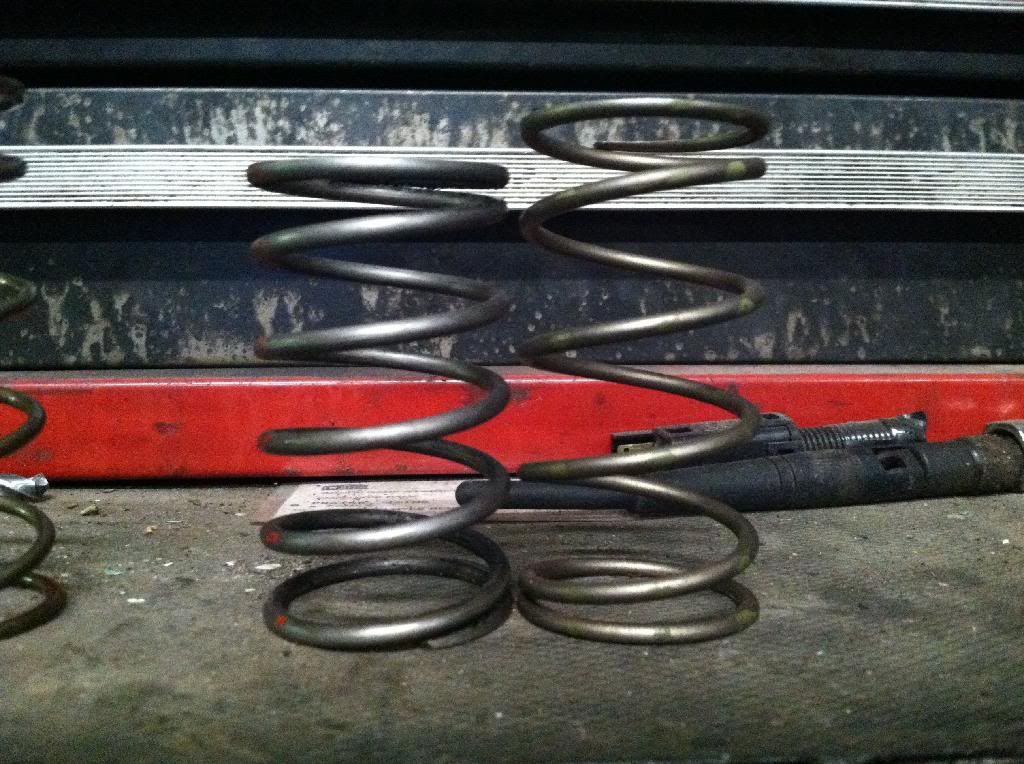

So, I have this WG spring, and really dont know what it is. It was sent to me with a couple other known spring, but this doesnt seem to match any other spring I have looked at. Its hard to tell from the pic, but there are actually 3 lines of the green paint down the spring. Othere than that, it is just raw metal.
the spring is 3 3/32" long, 1 9/16" OD, and 1 3/8" ID. that is all I can tell you about it. I dont know if this is a stock spring, or some random other spring. I can say that it is longer than the 2 1.8bar springs, that I had, but it doesnt feel quite as stiff.
Thanks for any help.

Thats a 1.9 bar spring. the yellow paint marks indicate that. it should be a little shorter than a stock AAN wastegate spring and bit stiffer.
yellow paint marks indicate 1.9bar and red ones indicate 2.2bar.

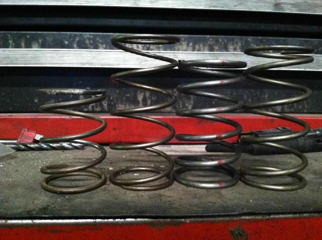

here's my spring collection for reference.
from left to right
early 20v------Stock AAN/3B------2.2BAR-------1.9BAR
84 4000S quattro-AAN swapped
83 UR quattro
95 URS6 avant
95 URS6 sedan
90 90 sedan-AAN swapped
91 200 20V turbo
92 GTI VR6
92 GTI G60 X-flow turbo
86 16V jetta coupe

Interesting, I had found a post on MG that said it should be a stock 20v spring. Hmm... I guess I will just put it in and find out.

you can see the yellow paint in this picture better. i run the 1.9 bar in my S6 and the gate doesnt open till around 12psi vs the stock spring that would open at like 6psi. you can take an air compressor, air pressure regulator, spare wastegate if you have one and build a rig to see what boost the valve starts opening at. thats how i tested all of mine.
