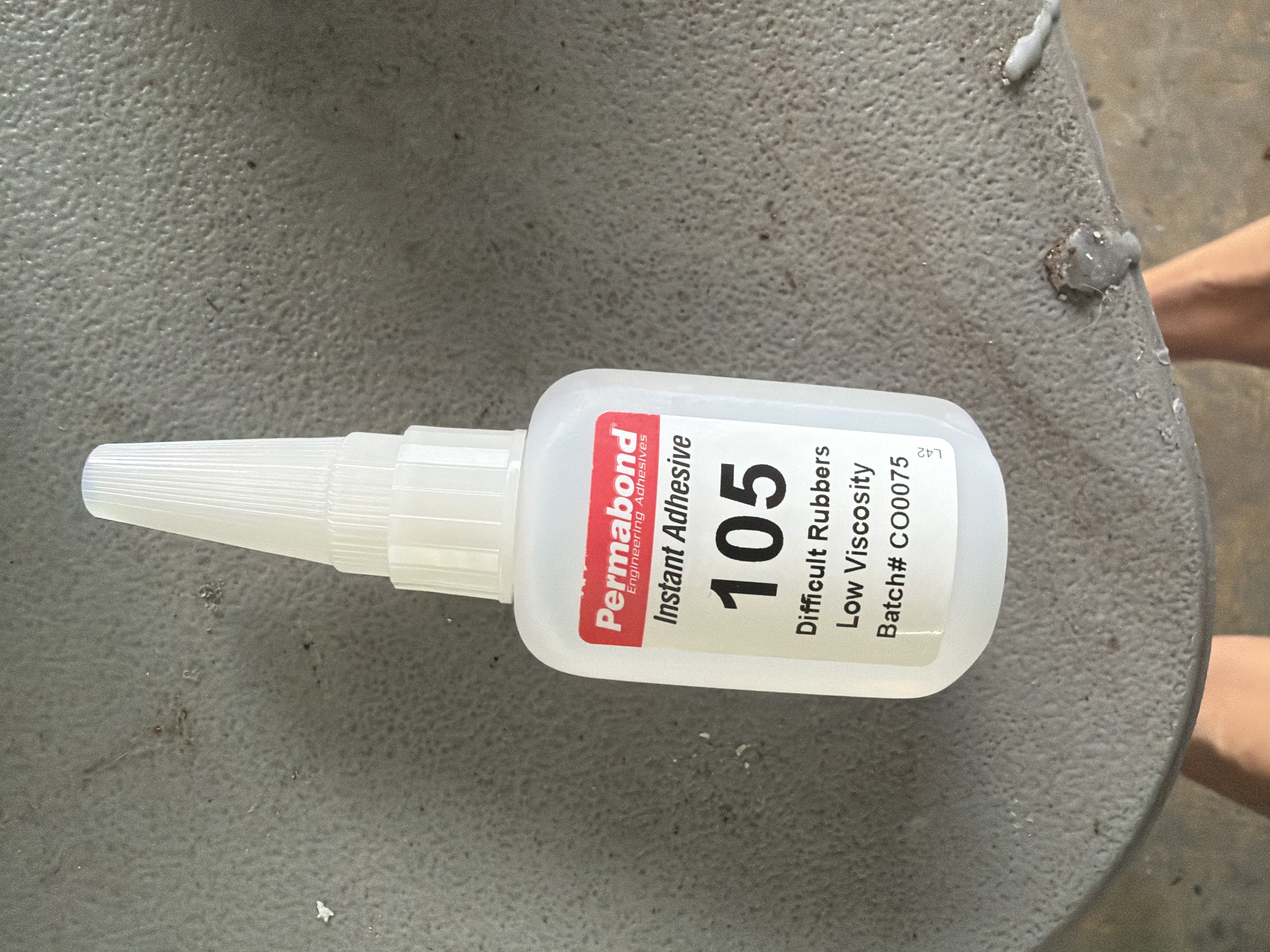

1.9 bar / 13.5 psi or 2.2 bar / 17.5 psi?
That is the question
If I was to guess the intake hose at the throttle body popping off is its weakest link.
Bonding silicone to aluminum:
Permabond
Polyolefin primer
Permabond cyanoacrylate 105
