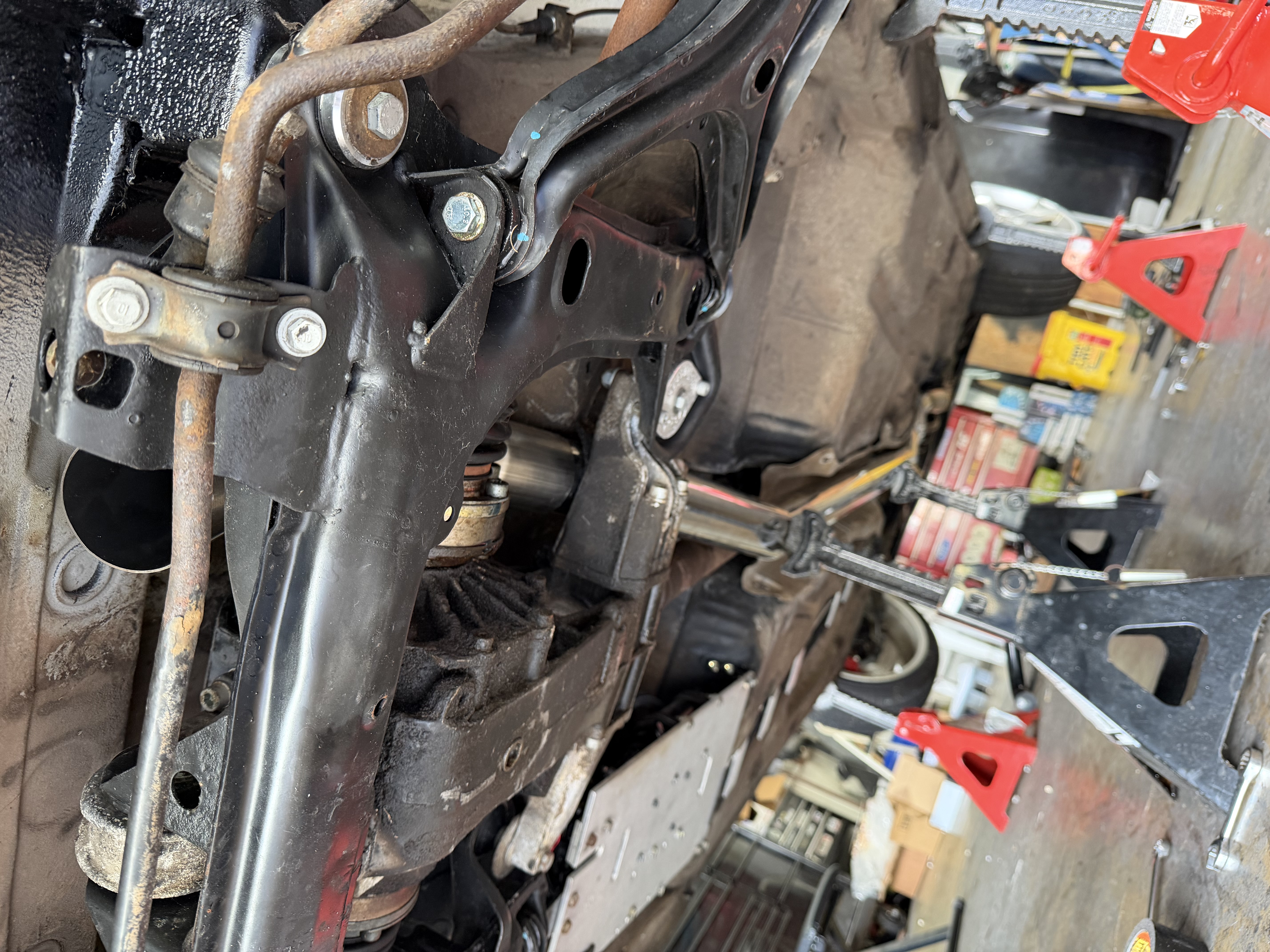

I shortened the downpipe a little to fit this
I hope haha. Wish me luck. 3” oval tubing. More ground clearance and will leave more room from melting the axle boot

Here’s progress so far. No oval tubing. Can’t get it to fit 😞 do you all run 3” tubing? I’m worried about ground clearance and melting things?

1 3/4 roll cage tool and a serpentine belt alignment tool to merge the wastegate into the downpipe

I’ve got 3/4” clearance from the drive axle boot. Heat wrap and a custom heat shield

Got the downpipes all welded up. Had to take a little off the subframe pinch weld. Doing the heat shields and secondary support bracket now
