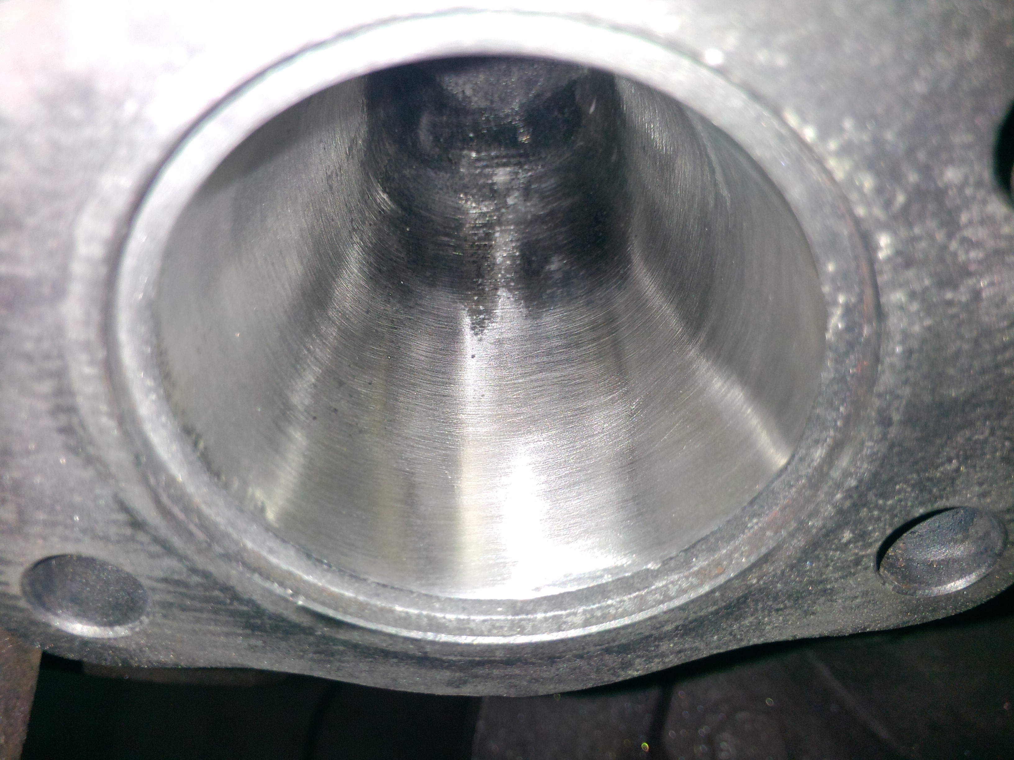

got mine good and started.
- tmp_IMG_20130923_123100-211603951.jpg (1.99 MiB) Viewed 28269 times

What did you use? Or did you just hand sand it?
Re: Taco's 4KTQ 20vt Swap: The Red Baron - DEATH TO CIS!!!
Posted: Tue Sep 24, 2013 12:20 am
by scubadave
6 inch long shank (flame) cutting burr. 60 grit tapered sanding cones, and 120 grit flapper drum. thats not done yet either. it will be a mirror if I have the time to do so. I got maad skills.
