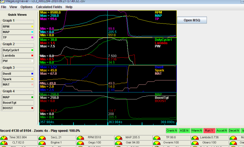

sure, but its not anything in my tune I promise you
when it was running right
(I picked a rich portion just to show you that its not because its too rich or something since this was a good run)...haven't been able to fine tune yet because of the bad coil

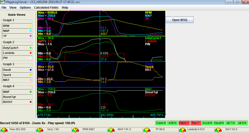

when it wasn't

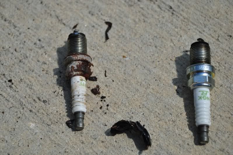

So when I went to go change out my plugs I found this on cylinder 2...same cylinder that improved for a bit when I switched coils last week.
WTF!!!!!!!???!?!?!?!?!?!?!? Craziest shit I've ever seen lol
I then put a new BKR7e in and it ran even worse. Weird...
Threw some old FR5DTC or whatever and it ripped like I've never felt it before. Like holy poopy its fast! I didn't stay on it for long though because I didn't have my laptop with me to read AFR and I'm sure its running a little lean now that its actually making power.
FINALLY

I have these EXACT same problems on mine. I was using NGK's (cant remember exactly which ones) and the worked great for about 2 months, then i couldnt pull any more than 15-16psi. It would miss like crazy and just fall on its face. So i put the old, used, worn out boschs back in, that i had taken out, and it ran like a champ! The next day i ordered a set (100$) later and havent had the problem since. Dont know why they are like this, but they obviously are! :P
