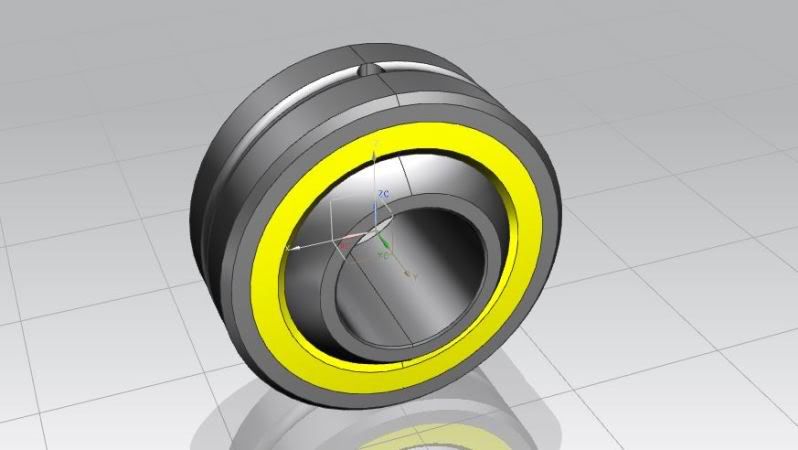

I think I have found the bearing I want to use. Ready to go in an assembly in CAD. This is fun
I have gotten in touch with someone at Aurora to discuss further. He's gotta call me back though.

haha actually...after speaking to Bilstein directly about that dimension just now, I have been able to choose a better bearing which is Ptfe lined and doesn't have that oil hole and groove.
