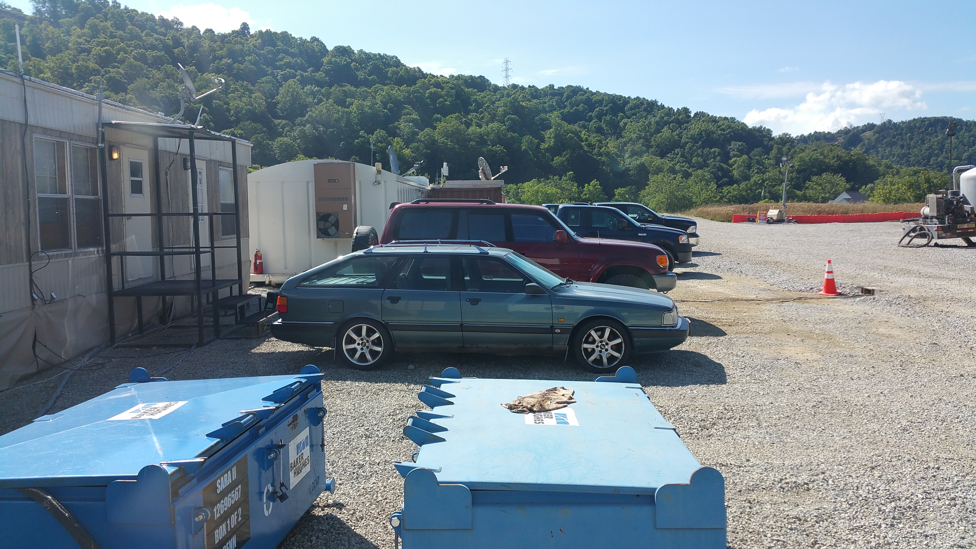

In the meantime, here's a picture of the ole wagon in its broken yet still gettin-it-done state.
Posted: Fri Jul 01, 2016 10:50 pm
by Aktapod
Even broken, it still looks badass!

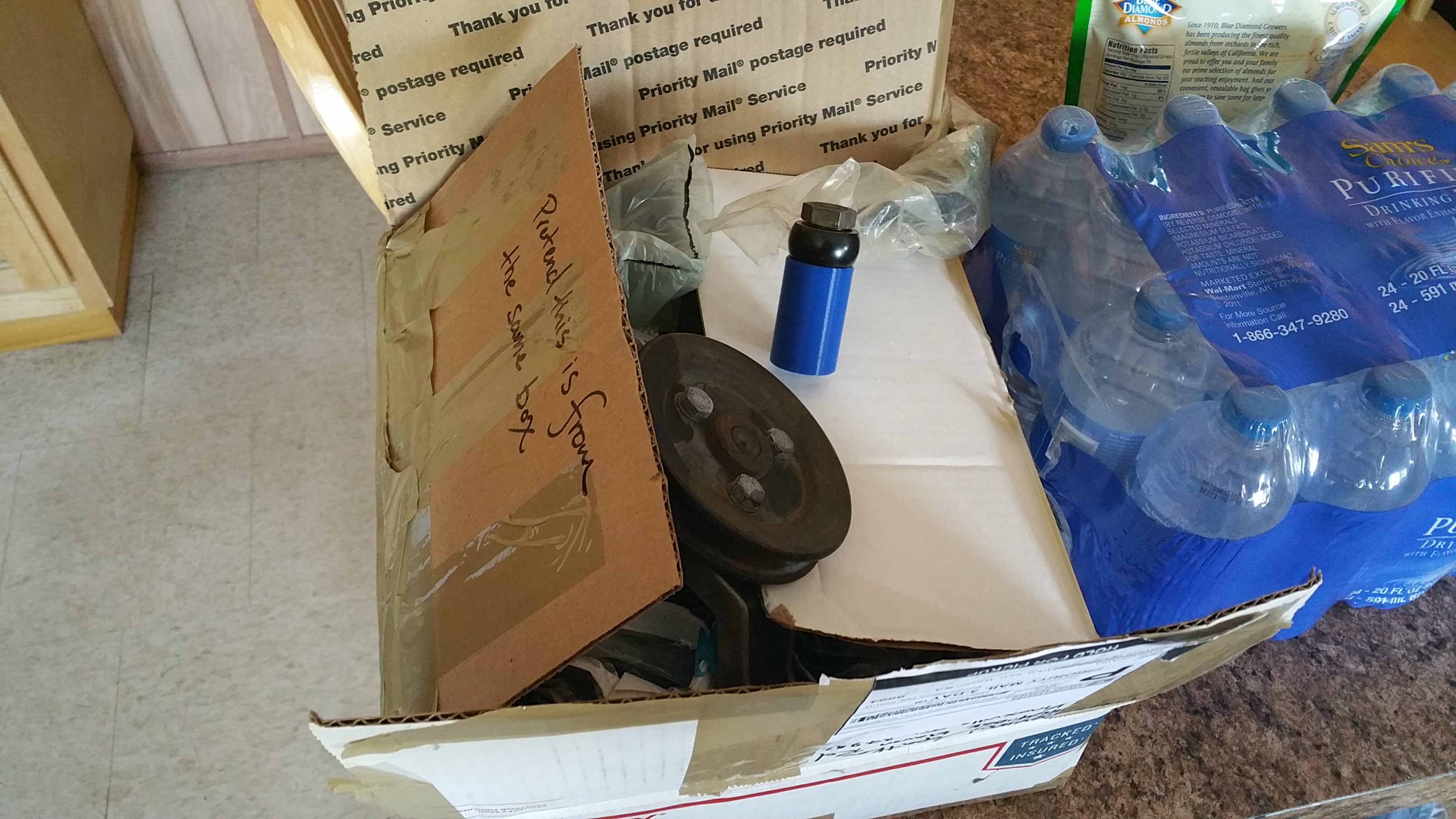

Just got the pumps today along with some of the other parts. I can't thank you enough Kevin!
Love the box lol

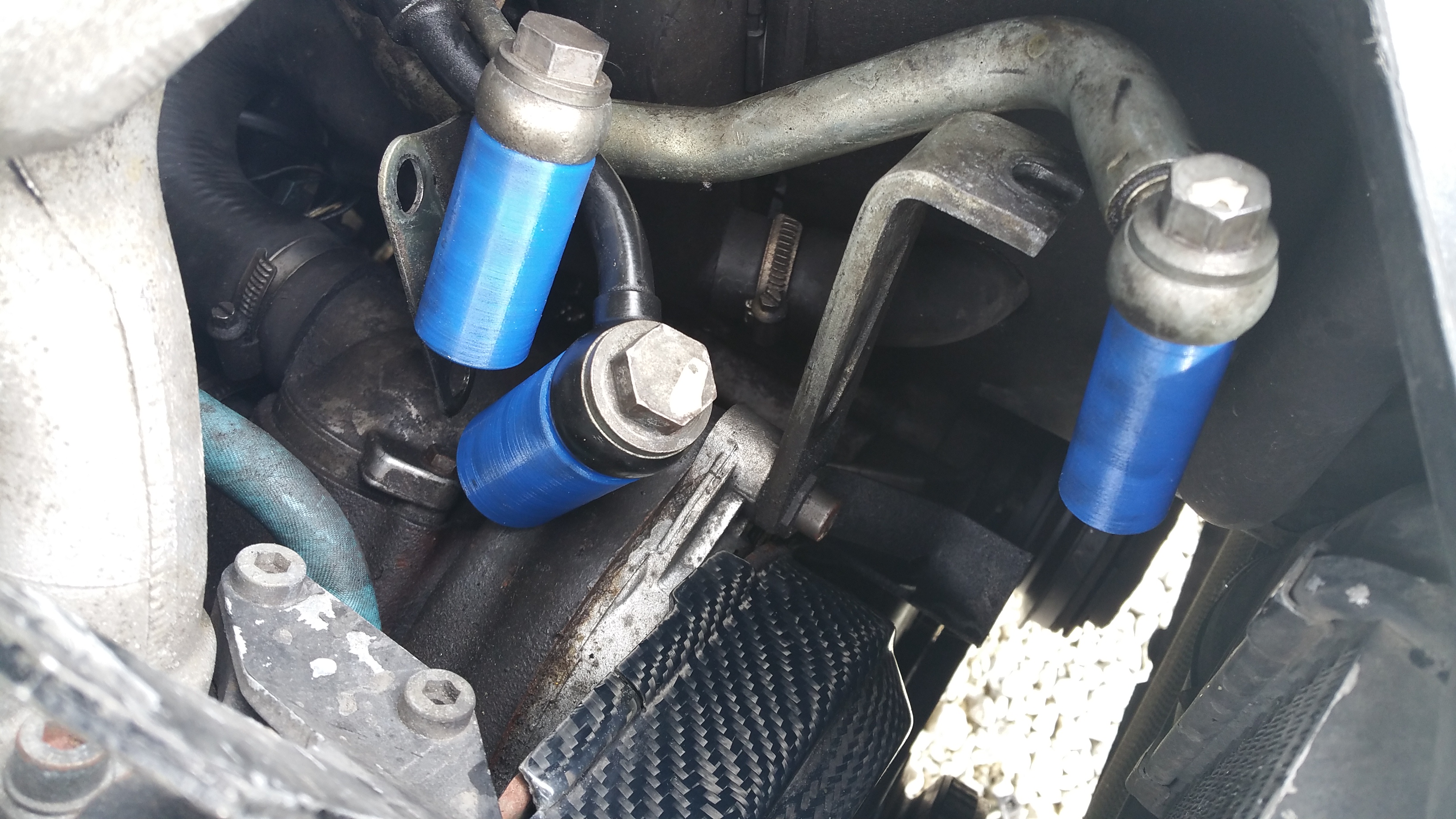

You can also see one of the temporary banjo plugs (blue) I made on the 3d printer so I could plug the lines in between getting the pumps swapped out. I love that printer!

Good as new. It seems like there might be a little air in the system because the steering is a little bit... What's the word... discrete? It has a notchiness to it, but I think it's going away. I think it is quieter than the other pump too. Thanks Kevin, you're a lifesaver!
Good thing I got a few options for backup too becuase only 3 out of 6 packages I had sent to that post office for general delivery actually got there and stayed there long enough for me to pick up... Don't ask. :bangshead:
It was pretty easy using the 5k pump on the 200. All went smoothly, especially with the steering line caps. If anyone wants some let me know and I'll print some!

Those banjo caps are pretty nifty, though. Probably beats the classic let-fluid-dump-all-over-everything method
