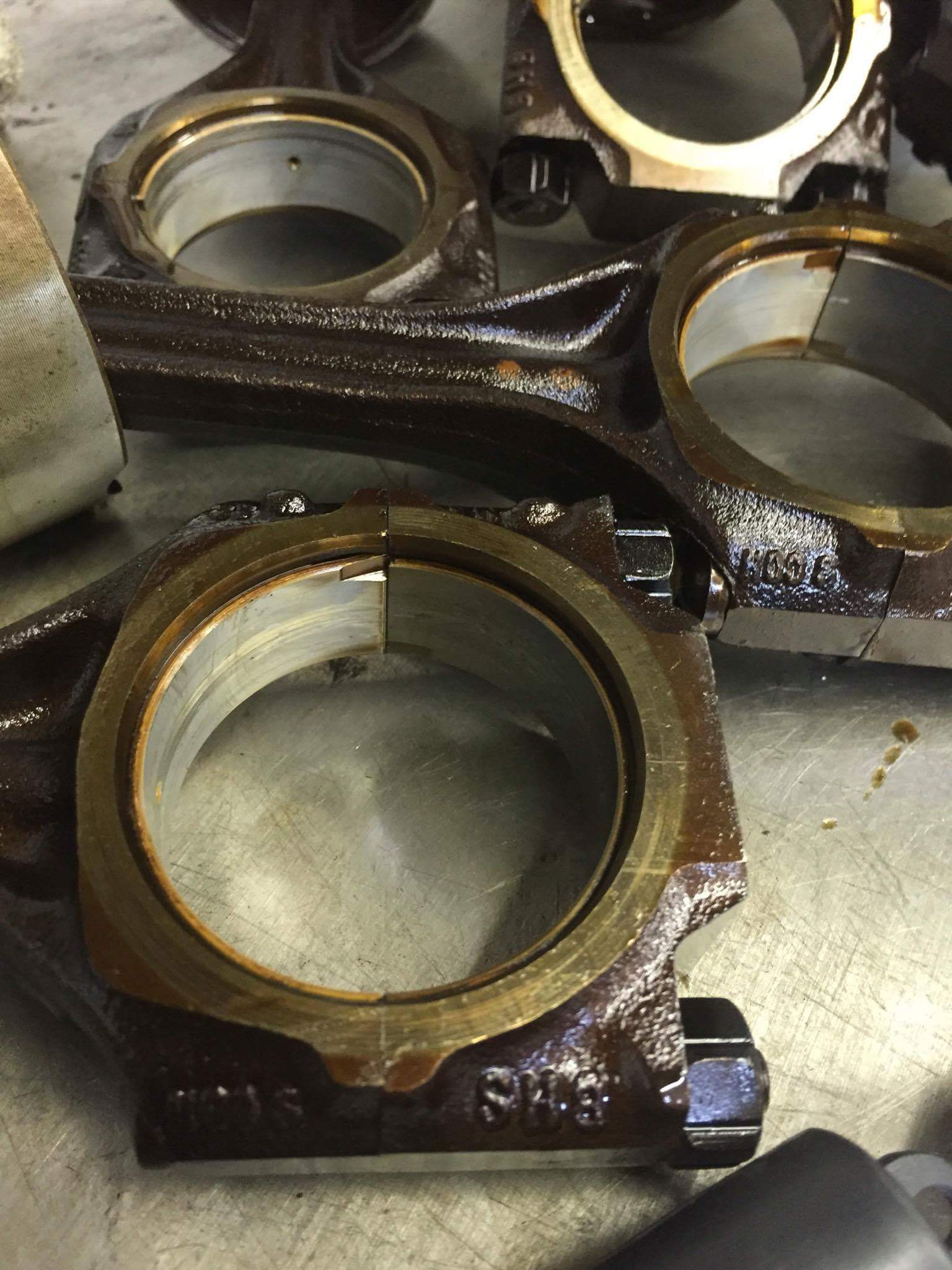

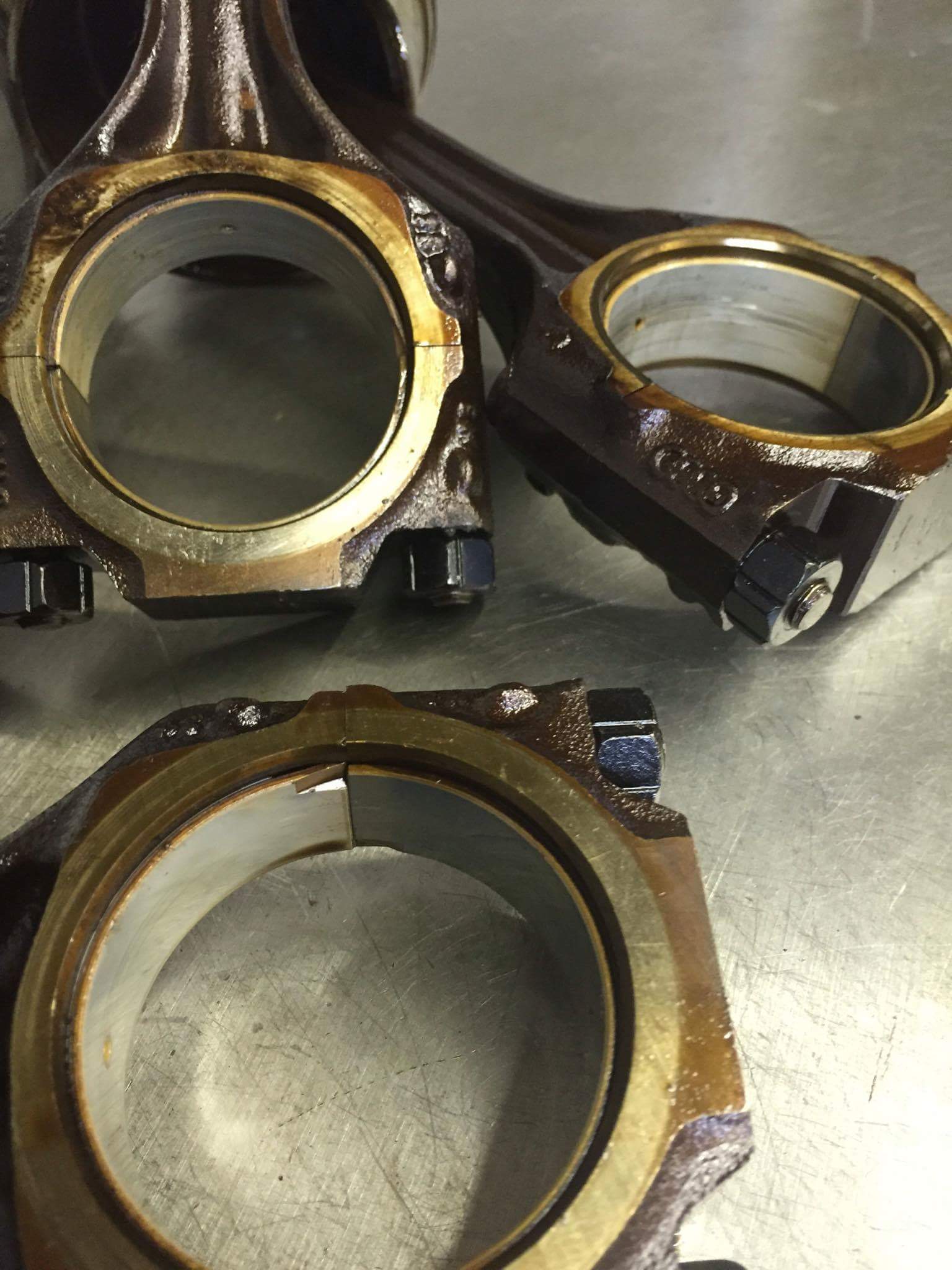

No word on the head parts so far, and not sure about rods either. Pistons are OK, no signs of det, but Marc says the stock gaskets can let go even at the slightest sign of it, so it's not totally ruled out. Doesn't matter though becuase it will have a dyno tune when this is done anyway.

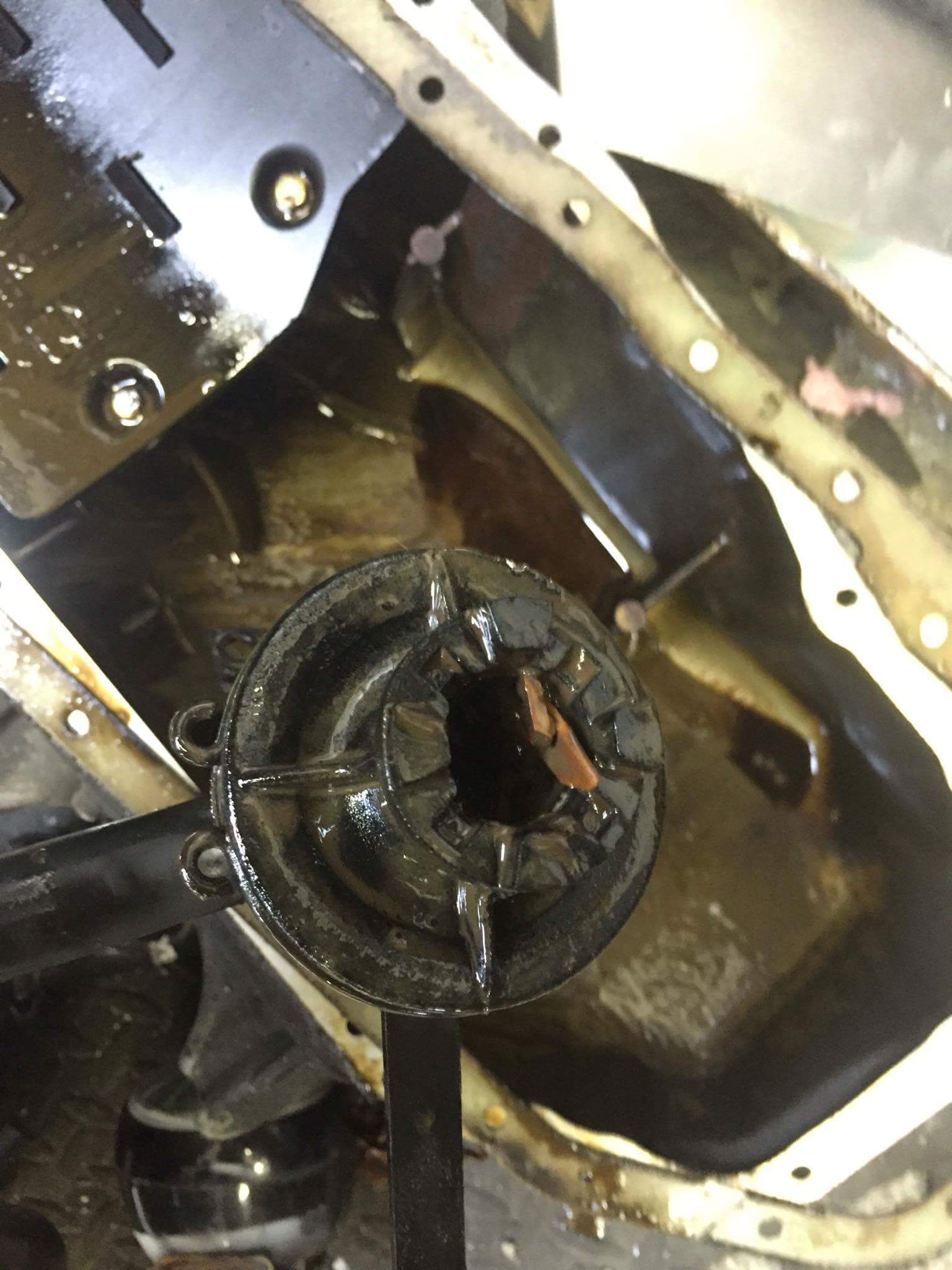

They did find something else interesting though. Someone here or on fb was talking about finding pieces of the valve cover plastic splash shield in their sump. I have always been leery of those things and was actually thinking of removing it next time I had the vc off (like I did on my sedan). Well, they found pieces of that clogging the oil pickup and scoring on the big end bearings, so it's likely that it would have spun a bearing soon anyway. So whether the gasket let go or not, this would have had to happen! Now I don't have to feel guilty about putting the efr on and blowing it up lol.

Re: Chris' 200 20v Avant - RENNWGN - Blowed Up
Hmmmmm... that happened to me a while ago. So I guess I'm due to verify Marc's findings when my engine explodes.
But seriously, it'll be nice to have the peace of mind that your engine is well-sorted now that it doesn't have the rods as a weak-point. Plus you can get rid of that stock paper filter!
My spare motor had that crap in the pickup too. Kevin made me feel better about it though lol. I'm am absolutely leaving that thing out of the VC this time! My solid one is starting to fracture in areas and has actually broken in half at one place so it's retiring now
