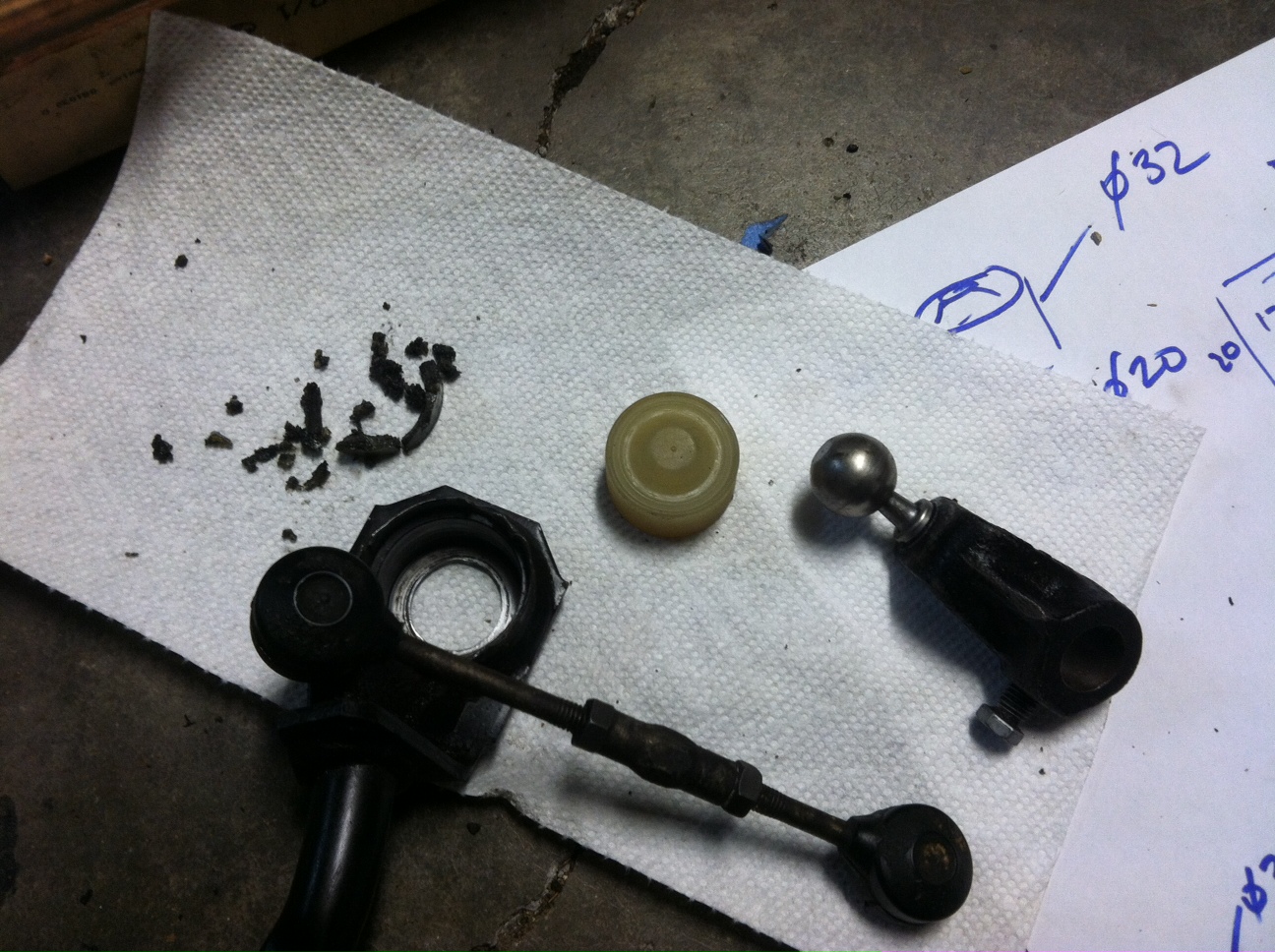

I used white lithium grease to do my shifter bushing the 2nd time after it deteriorated with CV grease after 2 years. It's recommended for that material!

Depends on whether you still have the PROCON-10 bracket on the trans or not. Without it, it'd be a breeze! With it in place, the worst part is finagling the linkage out of there. Took me about 2 hours start to finish when I did it in January, with the majority being trying to get it back under the bracket. You could maybe do it on the car, but I thought it'd be much easier to pull it out of there, replaced the bushing and press it on the ball, then reinstall the rod. I can do a little write-up if you're interested!
Knowing what I do now, I think I could do it under an hour now. It's not too bad, other than the tight space. For the lulz, old vs. new bushing:
