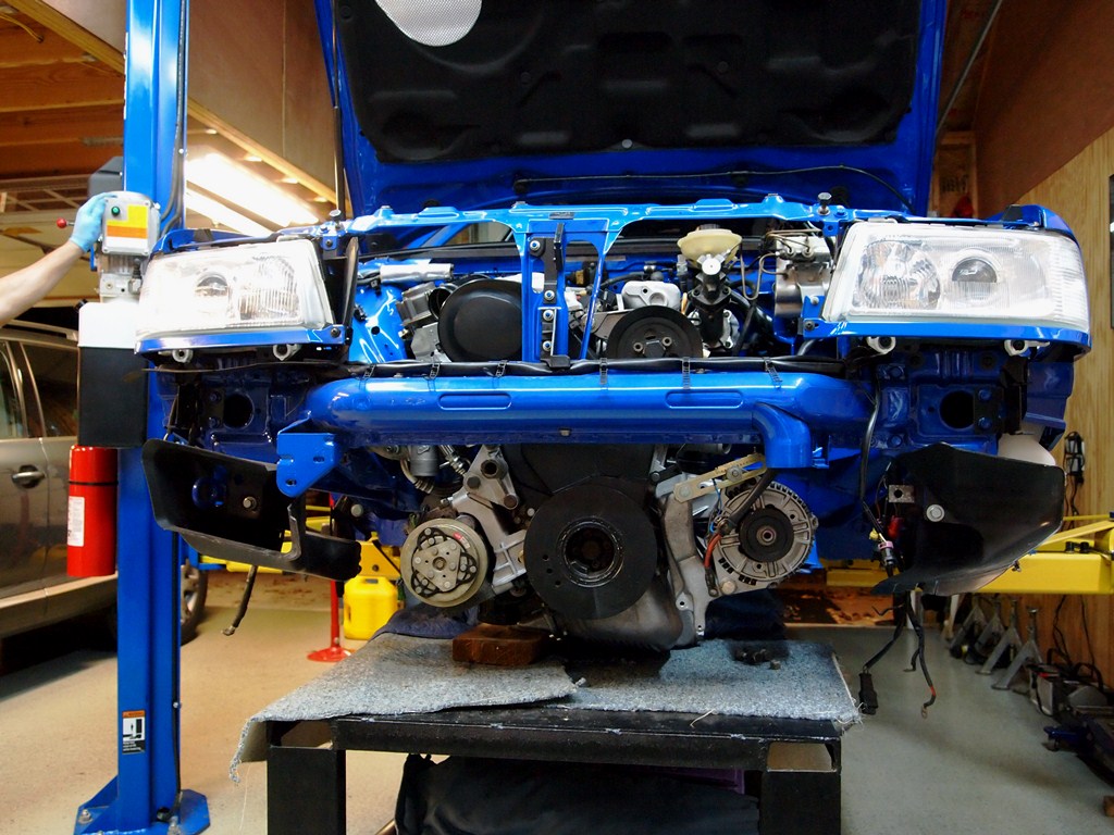

This will not work with a side mount rad, so Audi moved things on the ABY/ADU:
Saltinot's RS2
Saltinot's RS2
