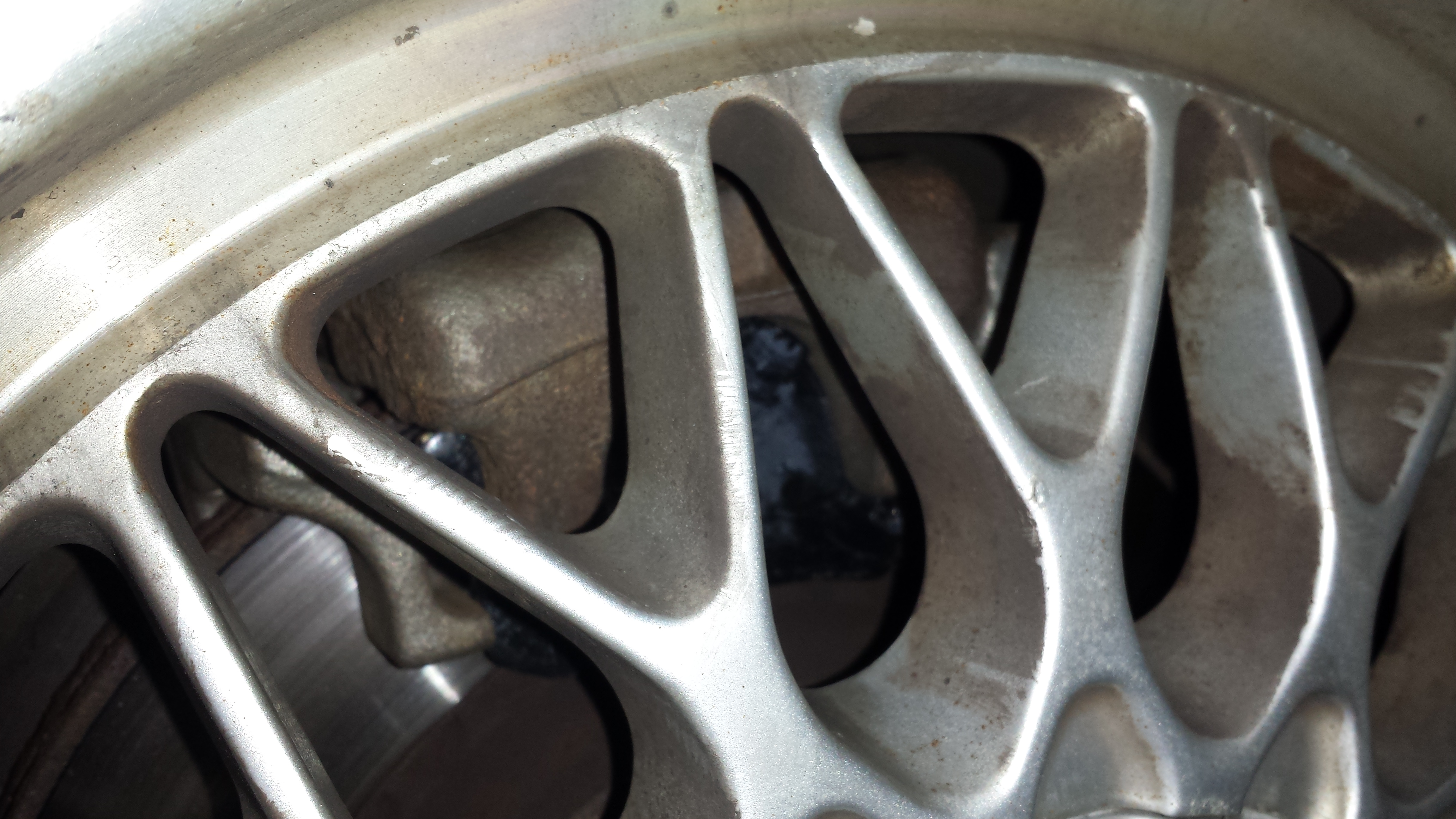

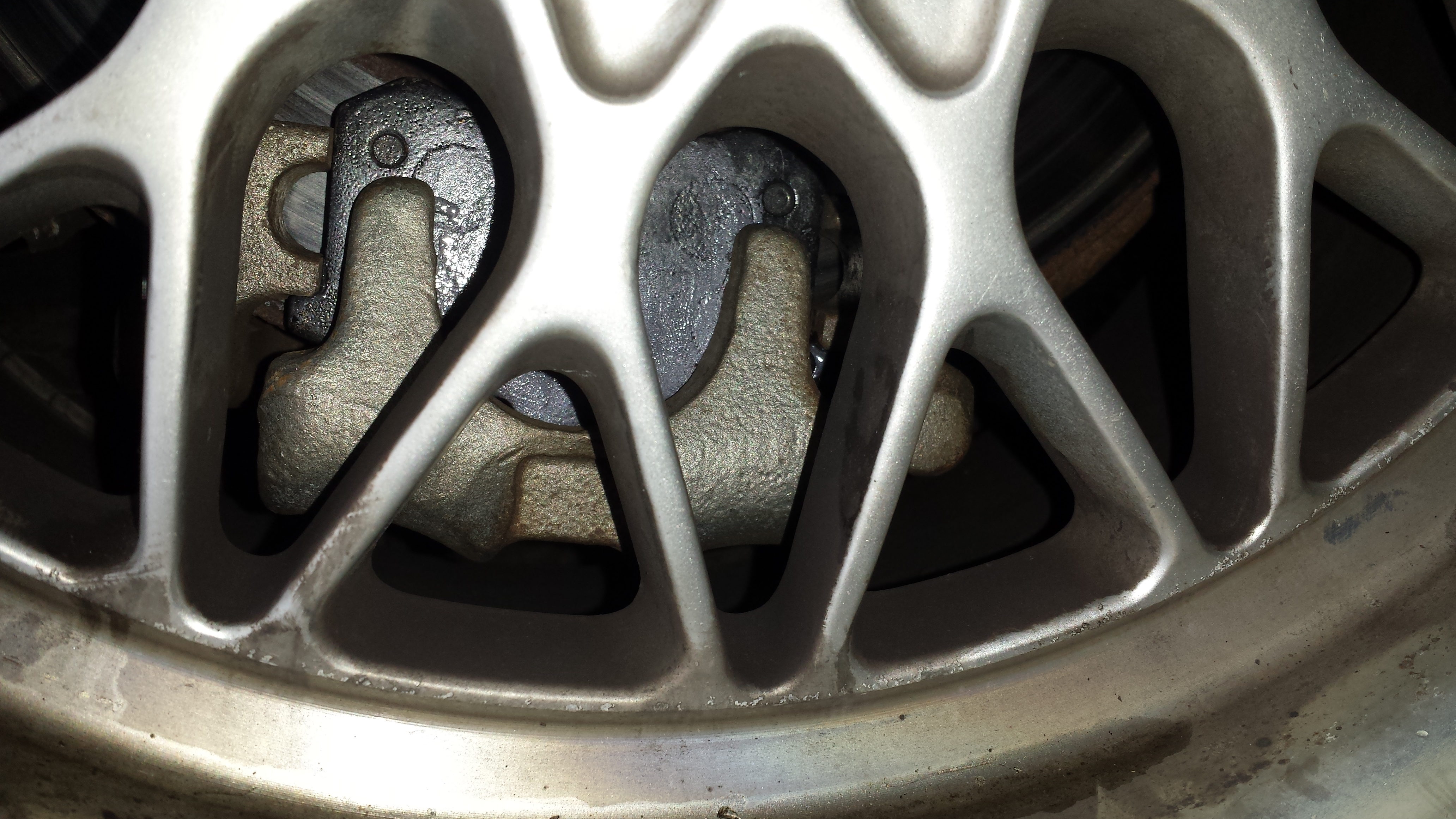

Posted: Wed Oct 21, 2015 11:27 am
by 88a5tq
While I haven't measured the caliper jaws just yet, they do look really nice for being used. Very free movement of pins and pistons. I'm impressed with their scavenging abilities and prep work
Posted: Thu Oct 22, 2015 7:41 am
by 88a5tq
These are in great shape. I have never had such good brakes until now. When I bought the car it had seized rears and the wrong ones soon after that. Work great now :) Now I have ceramic pads all around too. With the wrong calipers, I was using one used up organic pad and one ceramic. Aweful braking like that!

It try is amazing what good working calipers will do or your braking ability! I thought it was just the ebrake that didn't work on the bandit until I replaced the calipers. What a difference.
Posted: Thu Oct 22, 2015 11:47 am
by 88a5tq
Ya I never put much thought into the brakes honestly. It might seem most obvious with me using half a set of new pads back there :lol:
I'm a little confused as to why more people haven't brought up "whose Shokan?" I've only seen people say they can't find the right 20v calipers from the FLAPS. Well anyway for the others in that situation, go to Shokan in NY and you won't regret it. No cores required!
