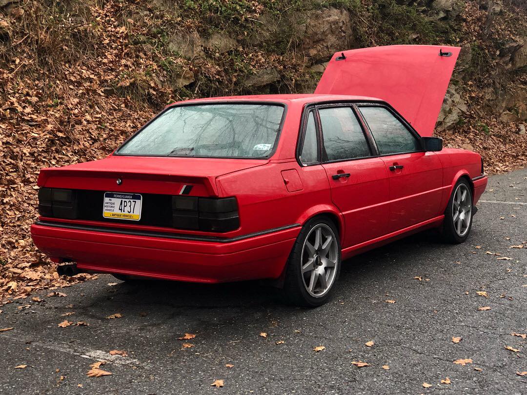

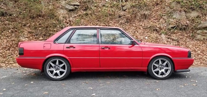

Re: Andrew's Audi 4kQ 20vt (For Sale)
Post by Ruyck »
The 4000 is for sale! I'll likely regret this... but the car doesn't get nearly enough love anymore. I plan to make a more formal post in the near future.
1987 Audi 4000CS Quattro
Located In Philadelphia PA
Originally Owned By my2000apb - Purchased in 2011
https://www.motorgeek.com/viewtopic.php?f=6&t=25432
My original MG thread is here:
https://www.motorgeek.com/viewtopic.php?f=6&t=44093
~85k mile 3B bottom end installed in 2011
Rods And Bearings from Hank (ShavedQuattro)
ARP Headstuds
AAN windage tray
7A oil pan
VEMS Standalone Engine Management (Swanson Harness)
Holset HX35 with .63 T3 Exhaust Housing (Ceramic Coated)
Wagner Exhaust Manifold (Ceramic Coated)
3" Stainless Turbo Back Exhaust
Tial Wastegate
Dahlback Racing Bpv
Carbon Timing Cover
Iroz Motorsports Forward Facing Intake Manifold
SPEC "Stage 3+" Clutch (Resurfaced Flywheel)
EFI Express Fuel Rail
60Lb/Hr EFI Express Fuel Injectors
Aeromotive FPR
Audi V8 Coil On Plug
Wilwood front big brakes
2 Bennett Coilovers
Solid Mounts Everywhere
Rear Mount Battery
Walbro 255 lph Fuel Pump
Recaro Seats
Sport Quattro Front Grill and Headlights
2 Bennett Front Lip
Aero Catch Hood Pins
Technomagnesio Wheels
Tablet PC Dash
Momo Steering Wheel
Quattro Script Rear Seats
I'm sure there's another 20 things I'm forgetting...
The car is solid. Pulls like a train. Tuned originally at Addict Motorsport Design in Seattle on the old K26/HX35 Hybrid where it made 310 horsepower and torque. We were pretty severely limited by the tiny hot side housing. The car hasn't been put back on a dyno since swapping to the larger housing. The engine setup should be happy for more power, but it's already pretty silly. The exterior isn't perfect, the hood and rear bumper could use a re-spray. There are some rock chips, etc. As is, this car could be driven and enjoyed every day, and with just a bit of work, this could be one of the nicest 4000's out there.
PM me if you have any questions to set up a viewing.
Here's a couple pictures from an event a few months back.
