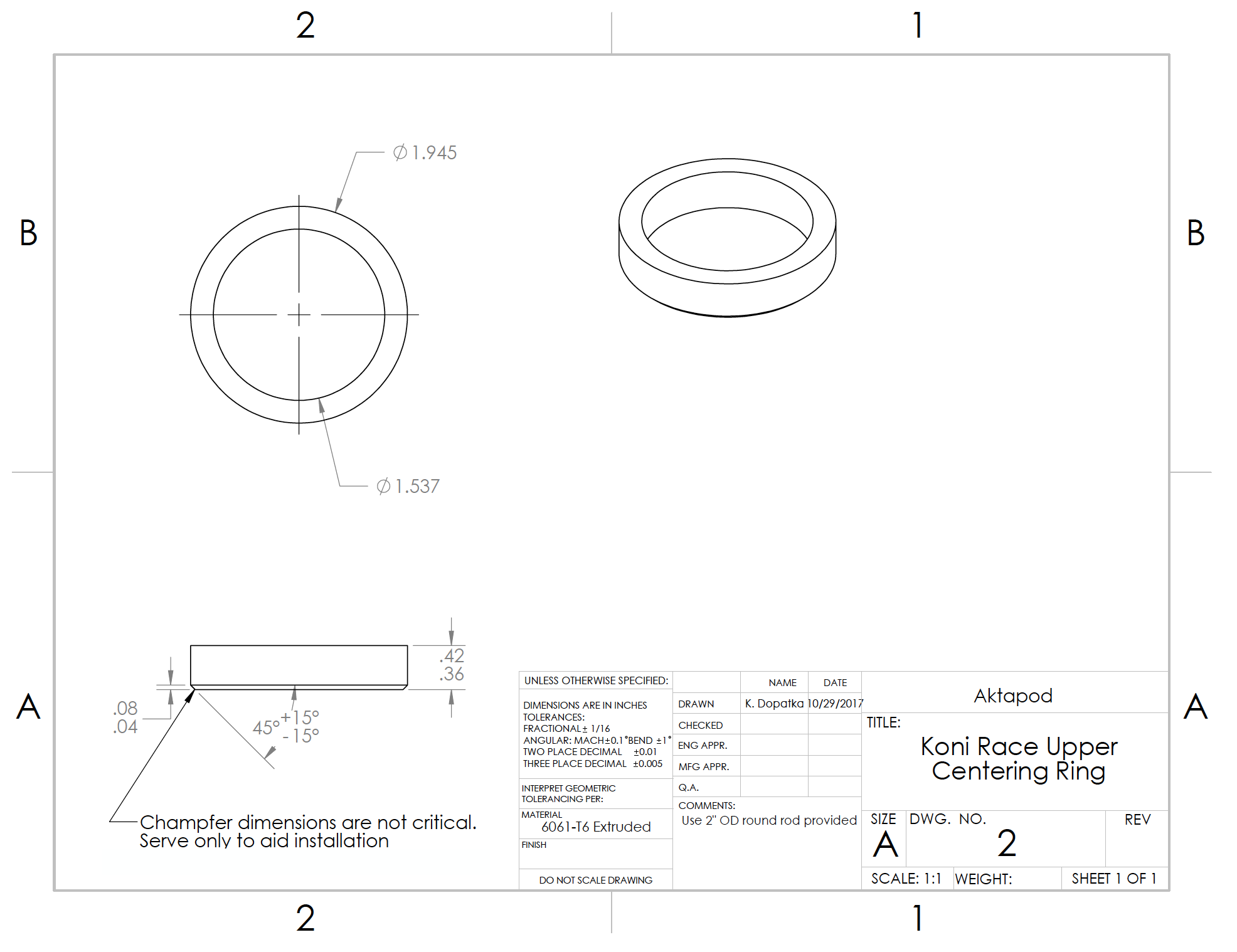

Mine were a little oblong when I measured, ranging from around 49.35 - 49.8mm. Koni supplied an upper centering ring for stock-sized sport struts, which has an OD of 49.6-49.7mm, and it's definitely a bit of an interference fit, at least on mine.
That being said, I mocked up a drawing for an upper centering ring for the Koni 8610/8611 Race series, if they happen to be the ones you're dealing with. I'm currently having the first set made, so no guarantee of fitment, but see attached if you're interested:
Koni Race Upper Centering Ring.png (209.88 KiB) Viewed 17421 times
Unfortunately, I won't be shortening the housings, so I'm also having a lower spacer/centering piece made as well. I think these two parts together will be all I need, since the stock setup only contacts at the top and bottom anyways.
