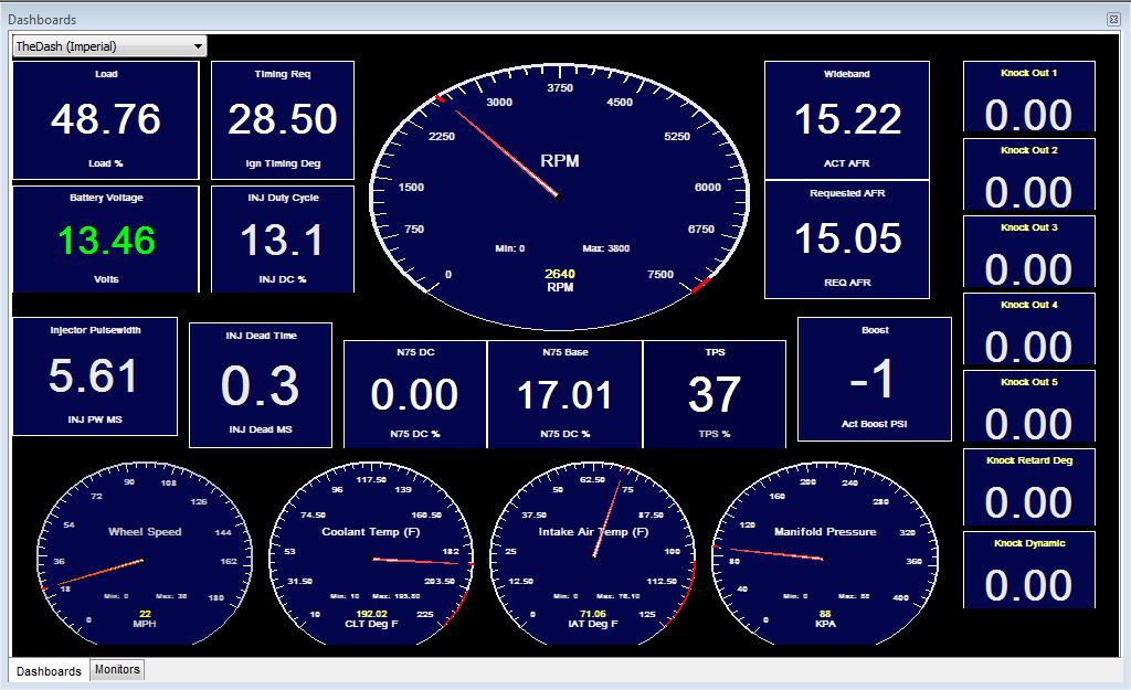

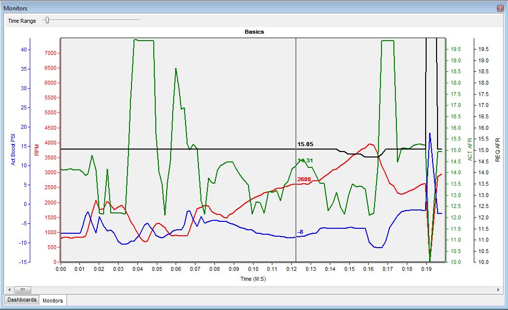

Here are screen shots of the dash i made for tuner pro and the monitors. i also forgot to mention that all of the logging variables are 100% free for you to configure how you like. if you want to make your own dash you can, if you want to add monitors you can. its all about personalization and customization to make it comfortable for you to tune your car.

I recently modified PRJ's winlog device file to have imperial units of measure now too. I also rearranged the dash a good bit to make it easier on the eyes. if you are using PRJmod with the current official winlog dash and metric variables you can just switch to my DLL file and dash for imperial units of measure. the link in the first post takes you to my public google drive folder where you will find the necessary files in the Winlog imperial units folder. I also added logging on and off buttons that are attached to key strokes. when you press the Z key it starts logging and when the X key is pressed its stops the logger.
A picture of the revised dash for Winlog.
