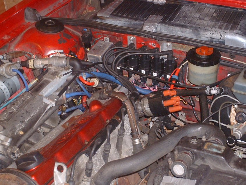

Keep in mind that as far as the engine management system is concerned, "coil per plug" is the same as "coil on plug"...

very true! thats a nice and neat setup too! find one of the tuna can's from an early AAN engine for the distributor and you'd have the perfect layout.

Yeah one thing I failed to mention that I found amazing when I first built the setup is the Audi wires fit *perfectly* onto the LSx coils. I was all worried about having to cut the wires up and put new ends on but they just worked as-is.
