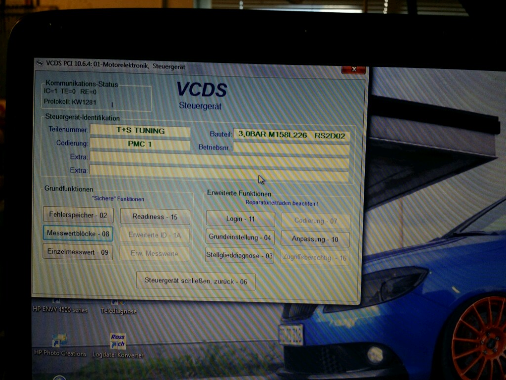

Okay. Mhm i used VAG COM / VCDS.
Have a look:

KevinRS wrote:Okay. Mhm i used VAG COM / VCDS.
Have a look:
The attachment IMG_20150628_164401-1024x768.jpg is no longer available
They changed the info string that had the software part # in it. well the only other way to tell if its 551B or 551C is if it has the string of code for the immobilizer in it. the 551C will have immo code and the 551B wont have it.

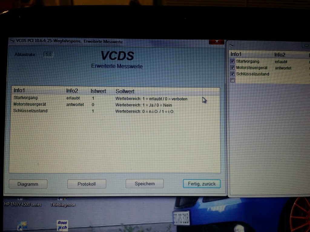

Okay thanks a lot. My chip reader is on the way. I got an ECU for immobilizer. He's a photo:
With connected engine ecu starting would be allowed. But with disconnected engine ecu starting would also be allowed.
So i think the engine ecu doesnt play a role for starting, only the car-keys. In that case i could use every fitting ECU without breaking-in the ecu to the immo.
But maybe its different because ist not the original ECU and immo was disabled/not used in this ECU.
Have to wait for the chip programmer to know for sure.

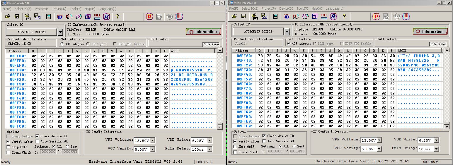

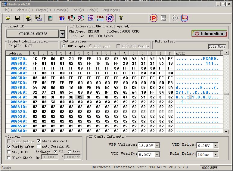

So, programmer has been delivered today. Now i have read the chip.
Here is an image of Offset 00008605, i dont know what to say about the immo. Offset 0000A610 is empty.
S2 01.JPG (159.9 KiB) Viewed 76946 times

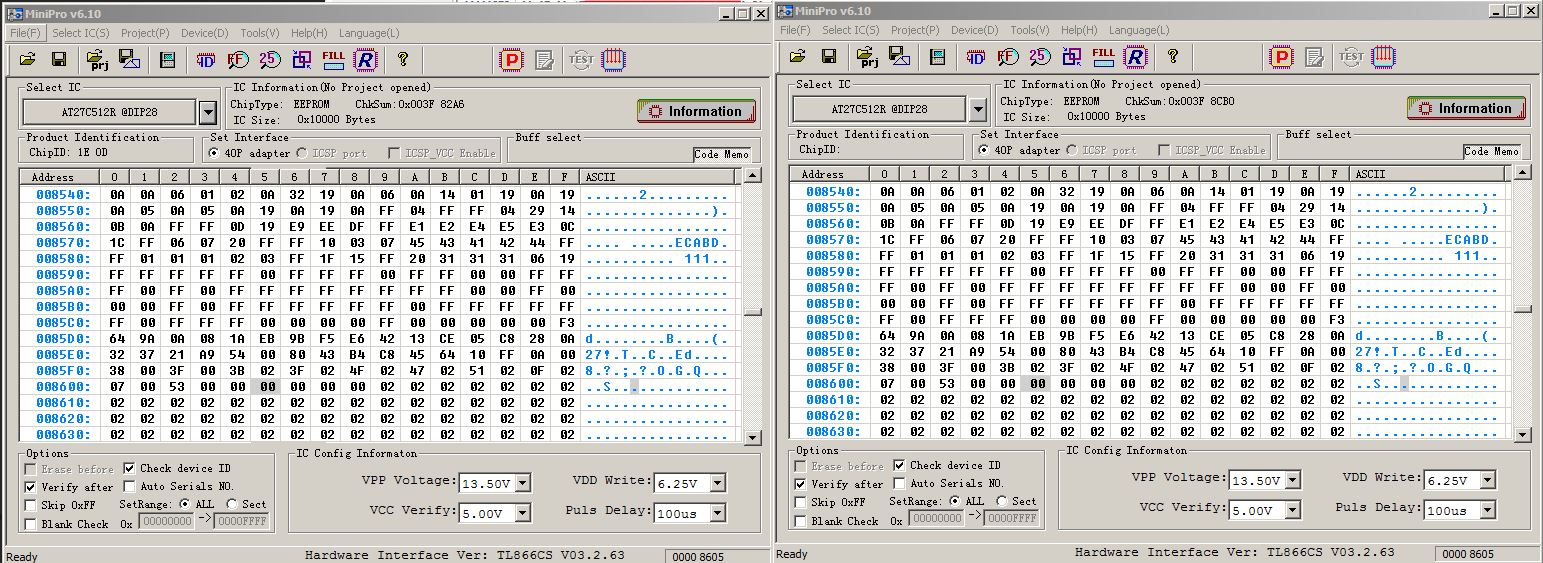

I downloaded your RS2 File 551B and compared it with mine, seems to be the much same:
Right is my BIN and left is your RS2
S2 02.JPG (304.4 KiB) Viewed 76945 times
S2 03.JPG (304.41 KiB) Viewed 76945 times
Please read the BIN with TunerPro. Ignition seems to be the same as OEM RS2. isnt it?

by vwnut8392
its an RS2 551B file. there's some pretty decent changes in that BIN. they dont edit all ignition maps, just the main map.

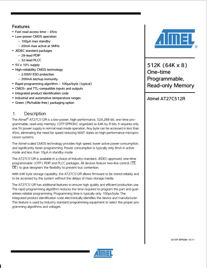

Why do think these Chip (ATMEGA8L-8PU) isnt suitable?
What? Really? The Atmel 27C512R ist e-erasable? I just searched for the Datasheet of the Atmel 27C512R and there is written the chip is only one time programmable.
S2 04.JPG (99.14 KiB) Viewed 76890 times

by vwnut8392
thats what i originally thought. the SST27SF512 is your only hope or to find more one time programmable chips.

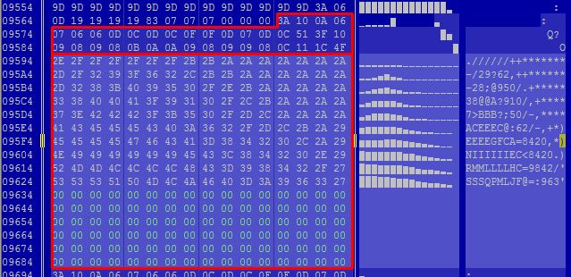

Tested today, but no luck.
I did the change in the map at 0x9594 (ECU is a 8A0 907 551AA with 8A0 907 551B software).
When giving ground to the mentioned pin on the coding plug (or ECU pin 39, double-checked that),
the car obviously does not switch to the launch control map, and revs freely to ~7000.
The software is not OE RS2 btw, it's a modified chip, checksum is OK too (I let WinOLS do the job)
Any ideas, what the reason for this could be?

Okay, did you copied your driving map to this map (beginning at offset 9594) and then corrected the ignition timing at certain RPM?
Re: Motronic 2.3.2 ignition cut launch control
Posted: Wed Jul 22, 2015 4:40 pm
by martin6
Yes, my map looks like this:
As you can see, my map starts at 9594, and is zeroed from 9634 to 9693.
Here the same map, with rpm factor:
Can you confirm that 551B "launch control map" is the 9594?
Maybe this is the wrong map and therefore it doesn't get active with Pin 39 to ground?

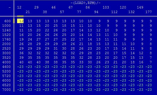

@vwnut8392:
I got another question. Whats about the rev limiter. If i want to set the rev limiter to 7500rpm, no Problem with the wot box.
But i want the ignition to be late @ 7500rpm, just like the launch control.
But my table in tunerproRT ends at 7000rpm, what could i do?

by vwnut8392
the rev limiter in the wot box is useless to you, its not enabled when run in the global setting. what i think your getting at is you want an ignition cut rev limiter which wont happen unless you write custom code to the ecu to make it do so instead of interrupting the injector pulse. this is far more complicated than what i've done but i have looked into it.
