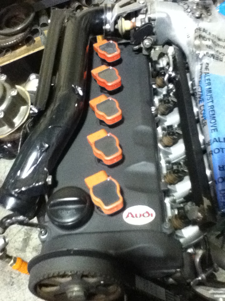

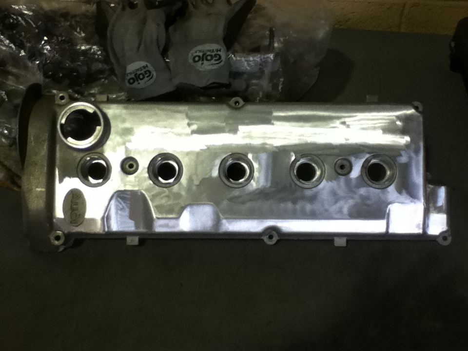

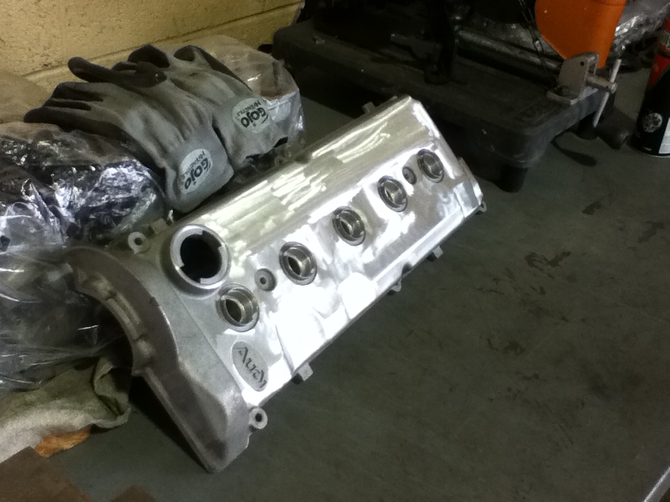

Valve cover reworked for coil on plug , thanks to chris for the help there, alot of grinding to get the raised lines off
Re: My audi CQ 3B S2 build
Posted: Tue Mar 12, 2013 3:00 am
by araipilot
looking nice and shiny

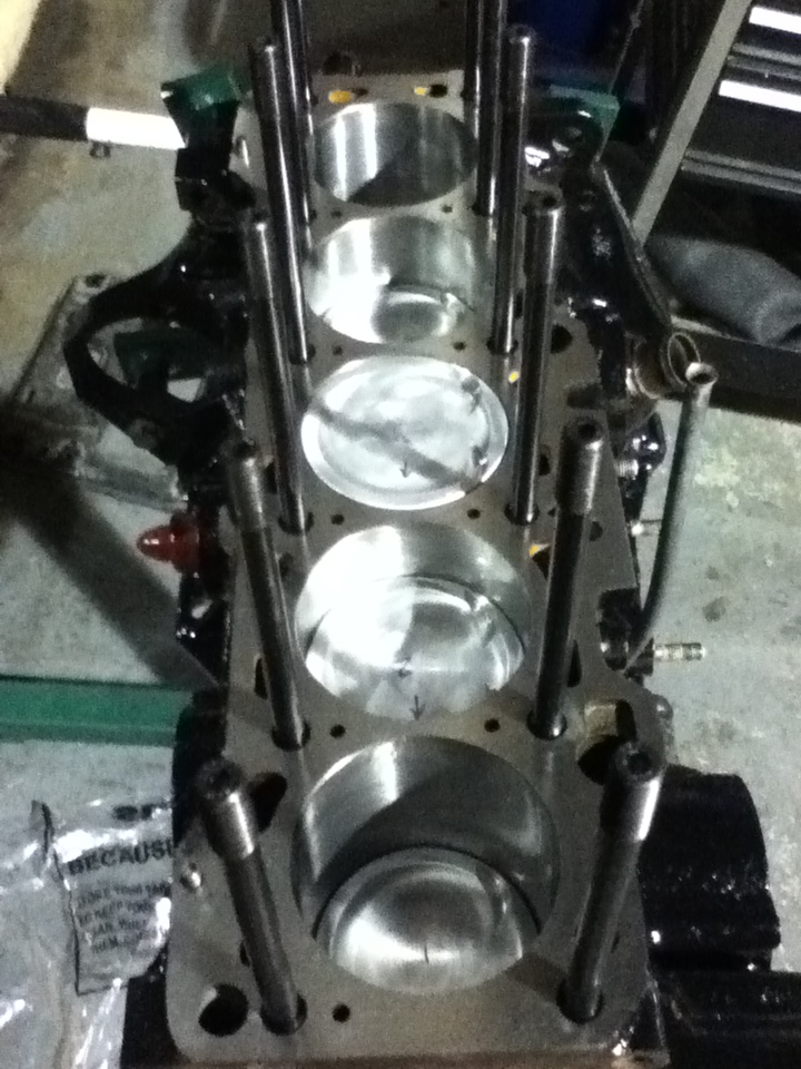

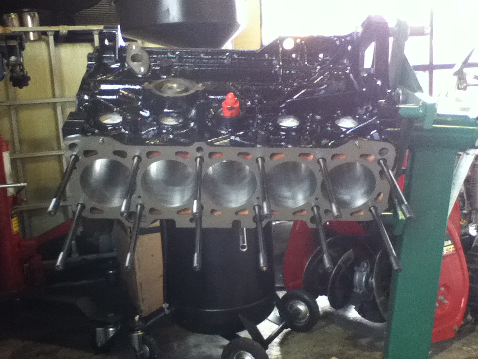

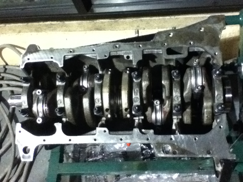

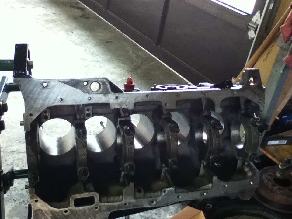

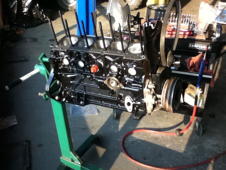

Block is back and was oversized by .5mm for the 81.5mm JE pistons also the block was line boared, decked and cleaned. Almost ready for assembly

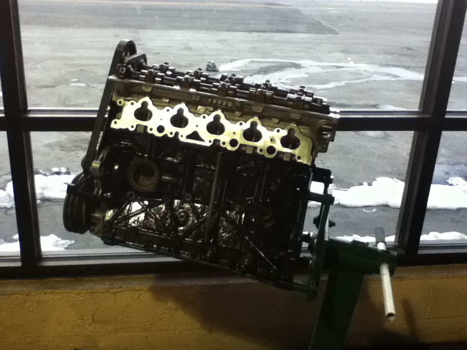

From the bottom

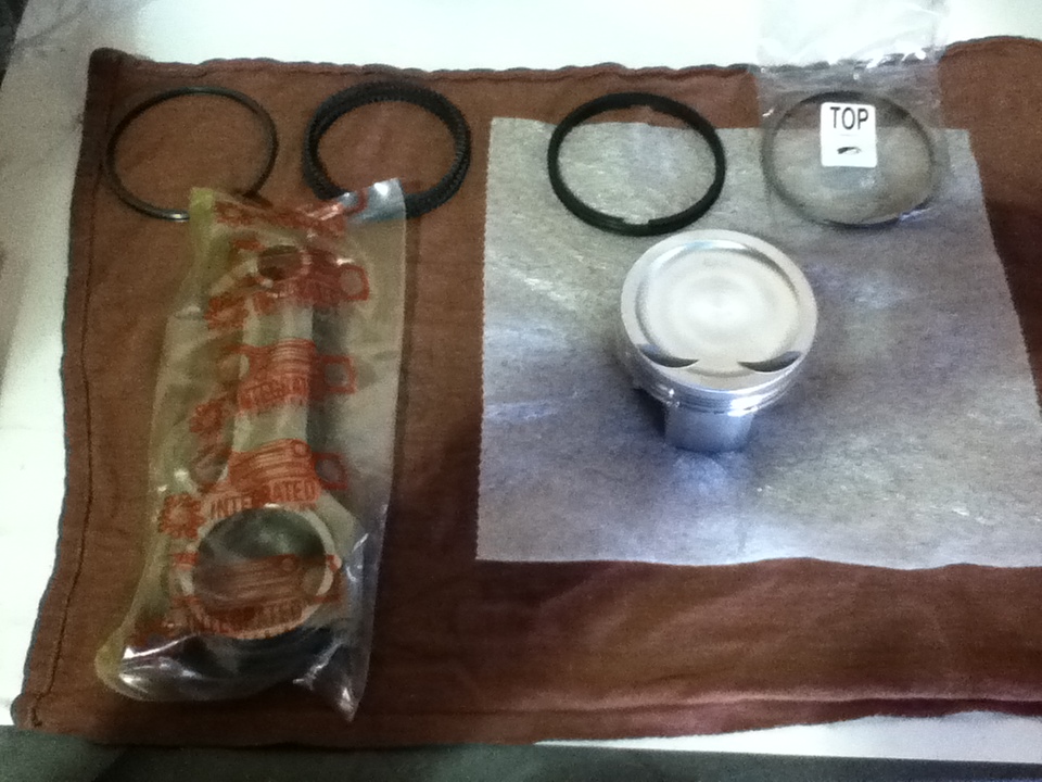

Some candy for the build almost don't want to install these works of art

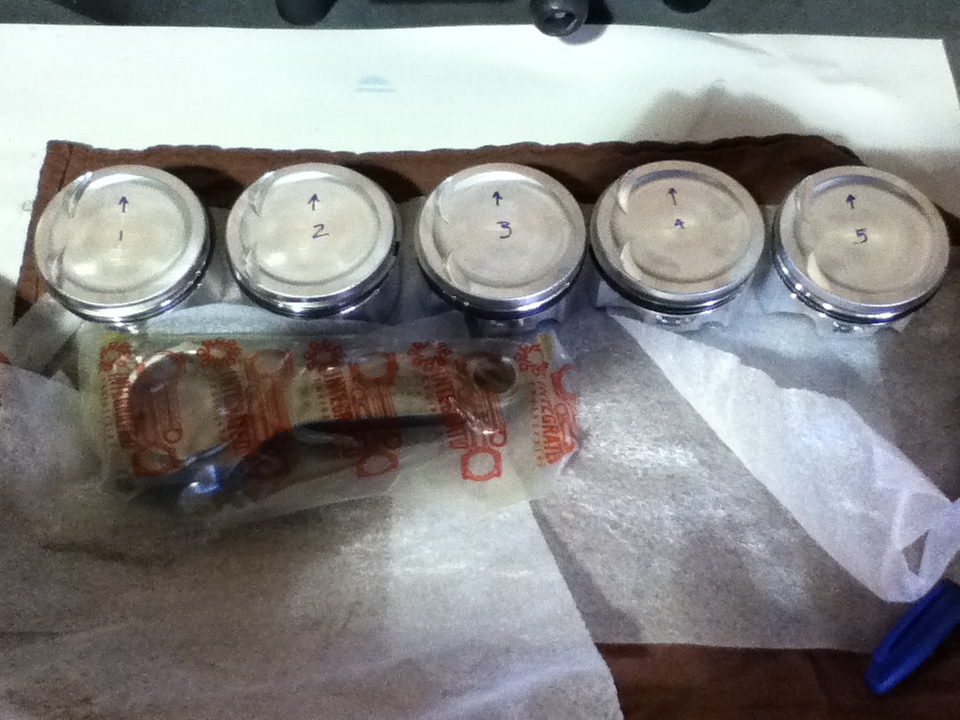

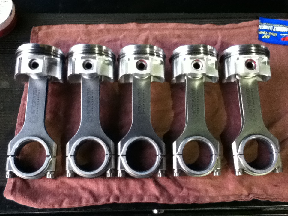

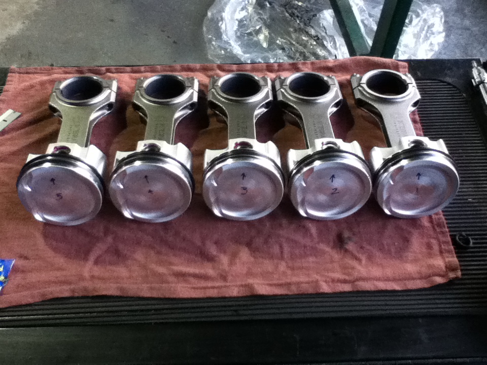

Integrated engineering rods w/ pistons
Posted: Tue Mar 12, 2013 3:12 am
by araipilot
pistons w rods

Crank was cleaned and polished at the machine shop. Pistons and rods installed in the block

ARP Main studs and APR head studs were used, also coated RS2 main and rod bearings used in assembly.

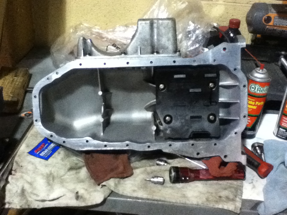

Oil pan cleaned and inspected ready for install

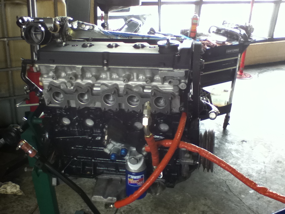

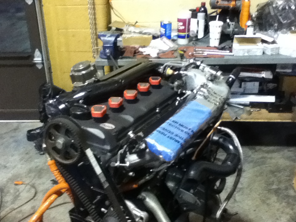

Oil pan installed and coolant and oil lines being installed Intake and valve cover installed

Almost ready to go in
coil on plugs installed for the AAN ECU swap

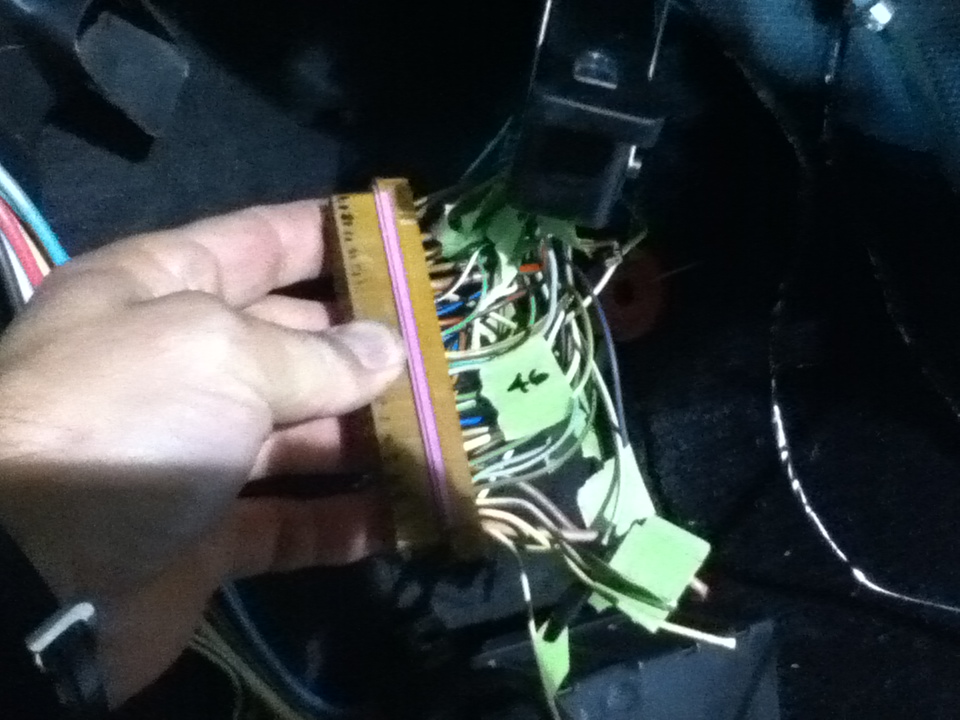

Now that the engine is back in we need to make ready for the AAN Ecu and start to depin the harness. I made sure I labeled evey wire I removed with its original pinout location in case I had a memory laps, very easy to put the wrong wire in the wrong location. Worse than that is depining the harness. It took me almost 6 hours to change the 22 wires due to having inadequet tools but we made it work. Pin #55 is the VSS or vehicle speed sensor that the 3B ecu did not have so we tapped into the Blue and white wire from the diff lock as this signal has to be a "processed signal" if someone choses to go down this road just keep that in mind when tapping the bl/w wire.
Posted: Thu Mar 14, 2013 1:31 am
by araipilot
More indepth wiring going on in these photos, you can see how easy it is to get lost even when your paying close attention and be very careful where you source your information there can be alot of miss information that can leave you scratching your head. It pays to take your time when going down these roads but the payoff will be worth the effort in the end.

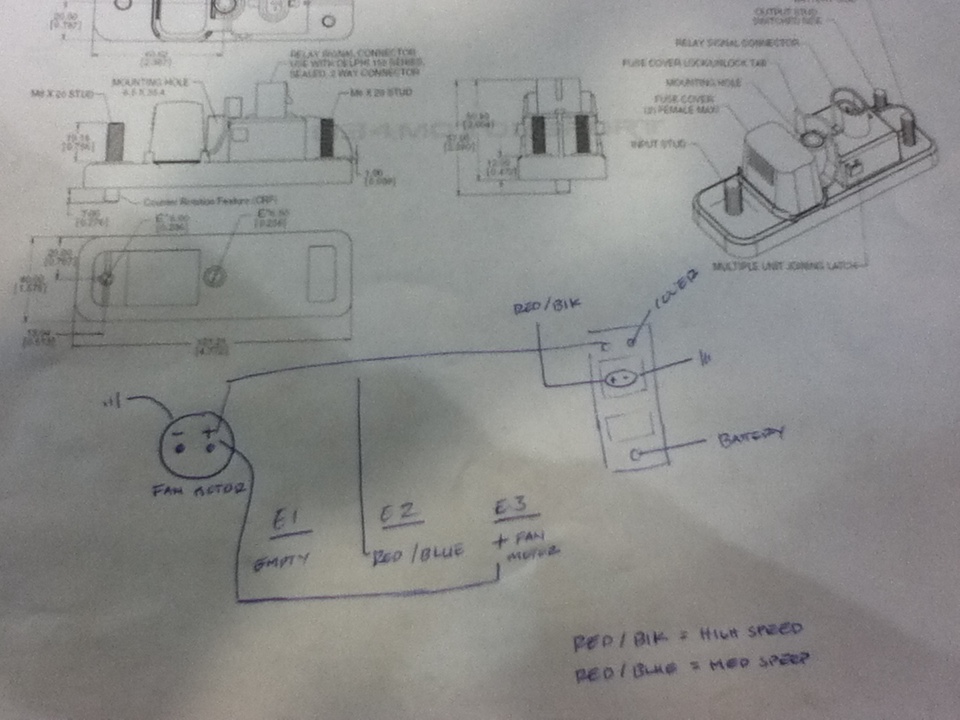

Now that the Ecu wiring is sorted time to start on the fan and the relay that I bought from well they shall remain unamed but did some research and this is what I came up with hope the pic will show the detail

Latest update on the fan wiring. Even though I have the S2 engine harness there are still some bits of the stock wiring that remain in the car. The fan wiring has to be rewired becaue I have the RS2 fan so the stock wiring can not handle the watts from the 500 watt fan so you have to wire in a resistor. E1 shows no connection but later I found out that the R/W wire needs to be connected to the E1 slot for your L-speed afterrun fan.

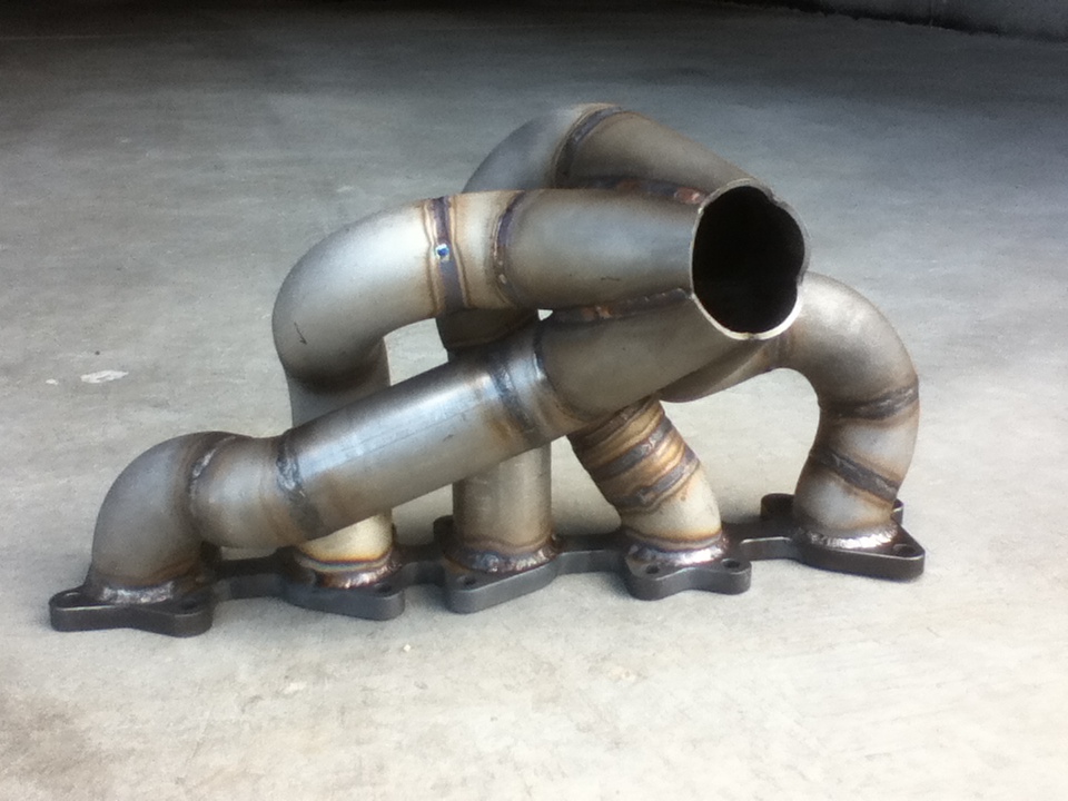

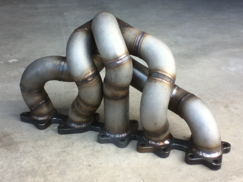

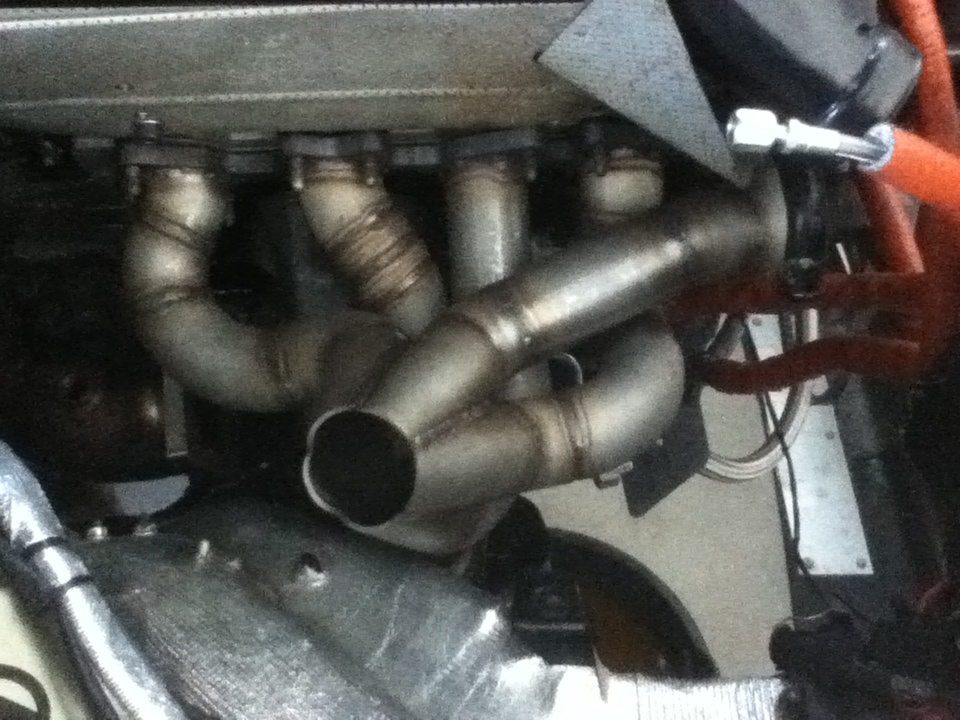

Below, I fabricated the exhaust manifold for the GTX3076R turbo but still have yet to fit inconnel exhaust valves along with the 1000cc high impedance injectors. This is my first attempt at fabricating equal length mandrel bent exhaust headers. Alot of work but the reward was well worth it. I am in the process of talking with Marc at EFI getting the AAN ECU sorted. My HP target requires me to wire in a RS4 MAF and with Marc's help it should be a steady process.

Super job on that header..
