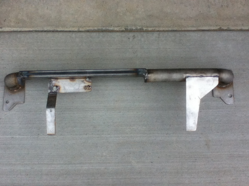

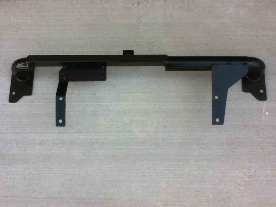

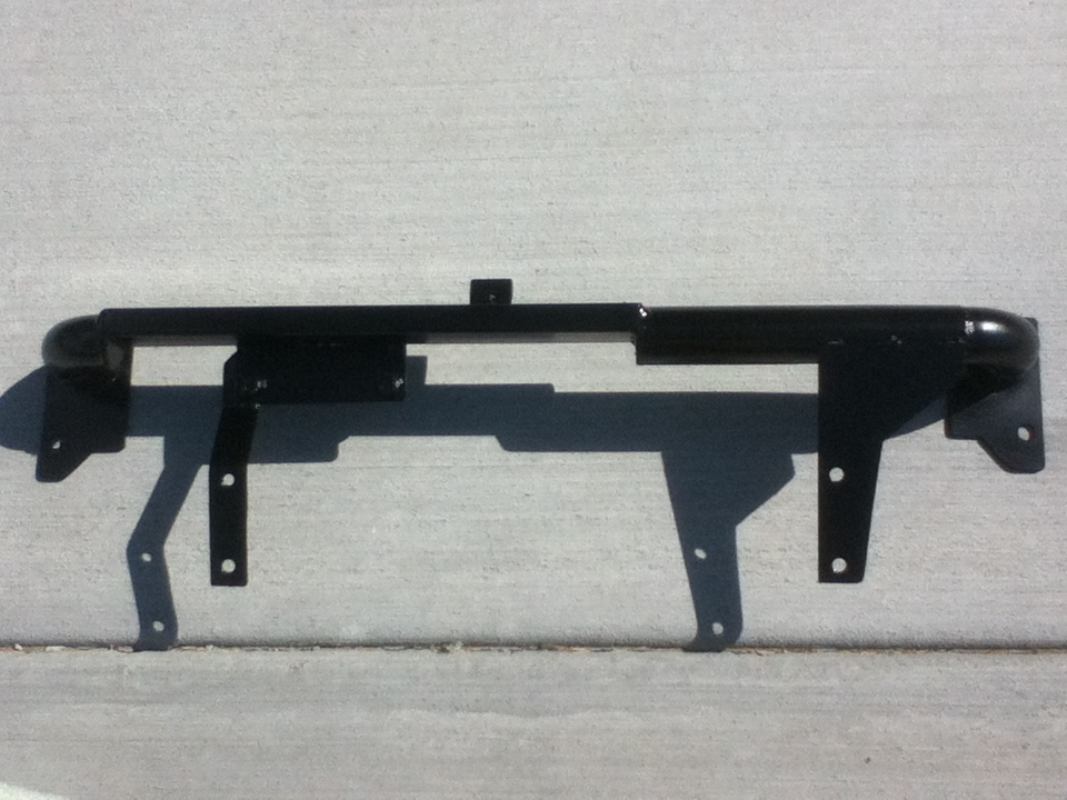

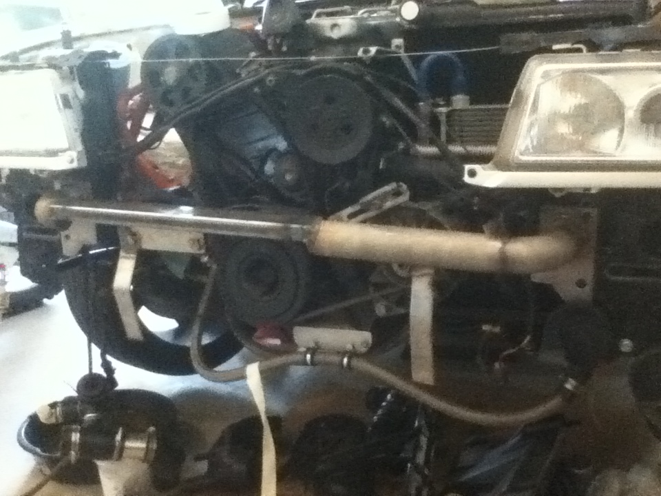

Ok revision #3. I think I finally got the intercooler cross member done. I had to make a larger support so the flex would be minimized. I also welded a brace in the back for extra strength. I think this took longer to make than the headers I made. I probably removed the brace probably 25 times trying different combinations for fitment compliance. The next step is to get the bumper to fit nicely.
I will have to fiberglass a hump on the bottom of the bumper to get the clearance I am looking for. It seems I take one step forward only to have three additional steps. I know that in the end it will be more than worth all the hard work
Larger intercooler support

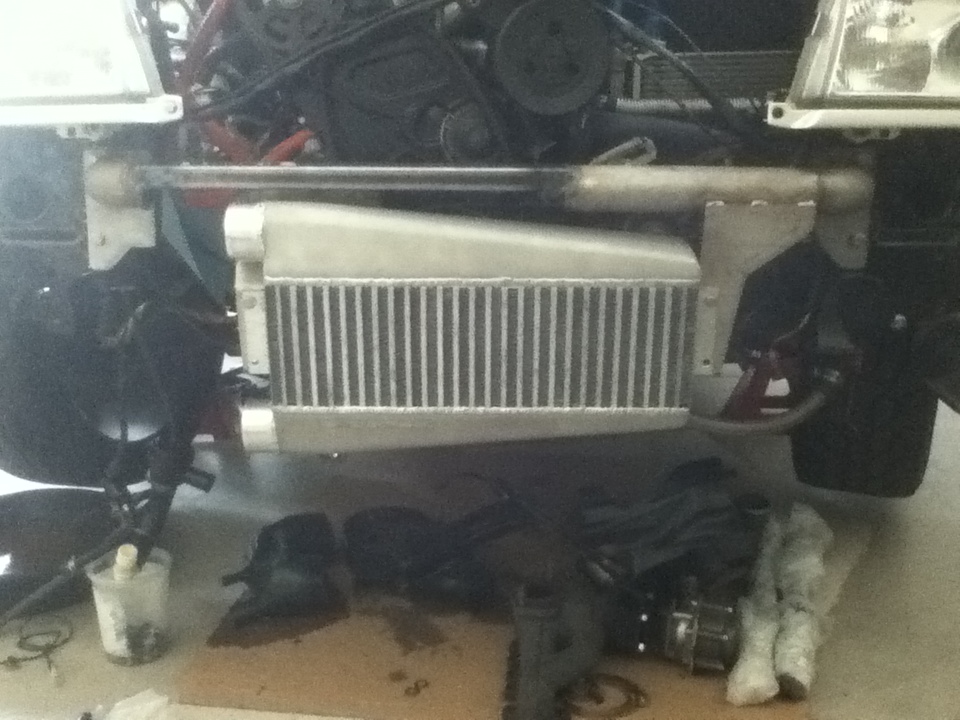

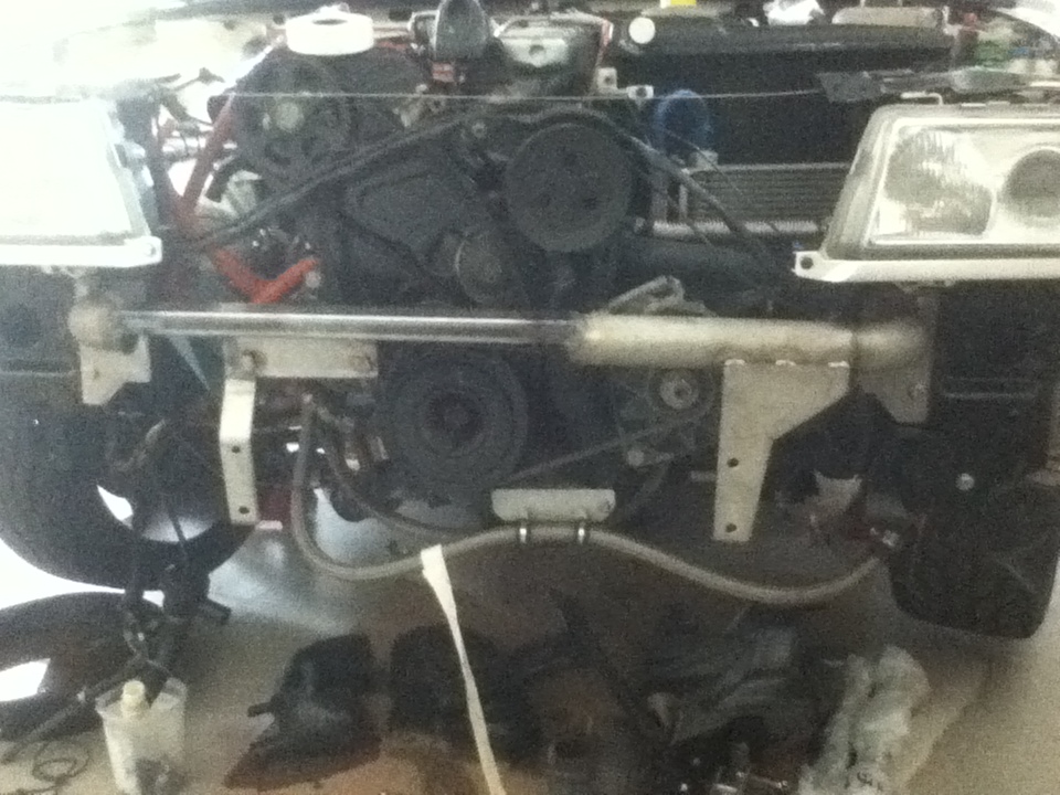

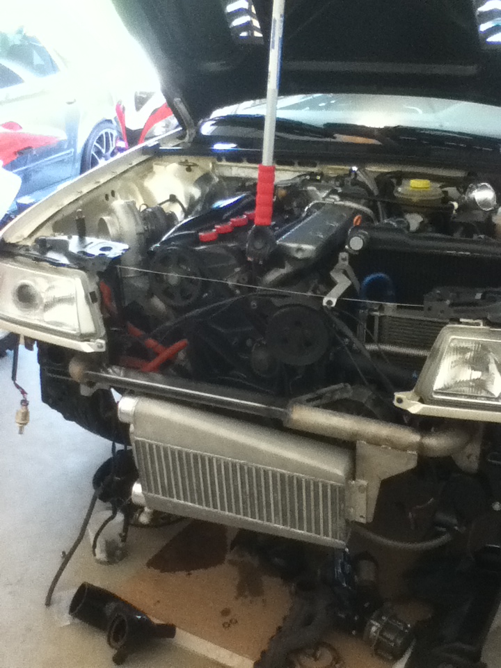

Here is the support on the car. The other support was too flimsy and the way I have the intercooler slanted slightly I ran the risk of the intercooler kissing the harmonic damper. I still have to install some rubber washers to give some vibration resistance.
I am pleased with how solid the arms are and it should prove stable enough for anything on the road. It also looks much better even though you wont see any of this once the bumper is installed
Just finished drilling all the holes
Finally mounted on the car, still needs powder coating

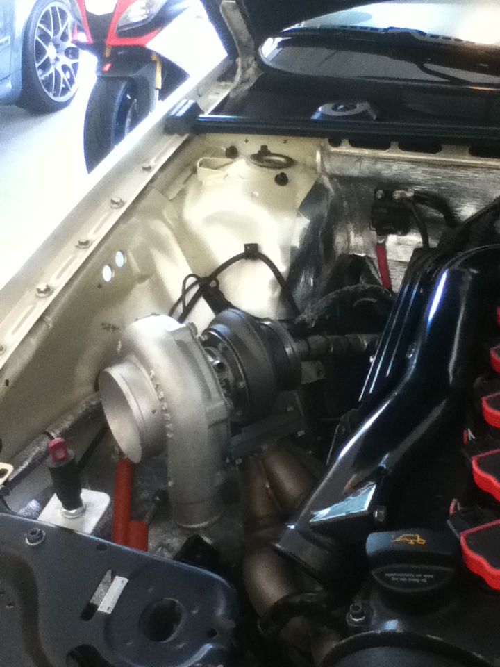

Ah, today I finally got my turbo in after more than a month of waiting. I will be running a GTX3076R with an A/R .60 it should meet my target HP goal of 600 BHP, 450 WHP. With the turbo I was able to finally weld up the T-3 flange. I waited because I wanted to be absolutely sure of down pipe clearance that I will be fabricating. The billet wheel sure looks the business. I can't wait to get her back on the road!! I still have to pull the head and replace the exhaust valves that I also received today. I went with some stainless steel ferrera Inconel exhaust valves that will do the job nicely.

Here are a couple of shots from the drivers side. I will be cutting through the side wall for the cold air intake that will be located behind the bumper
