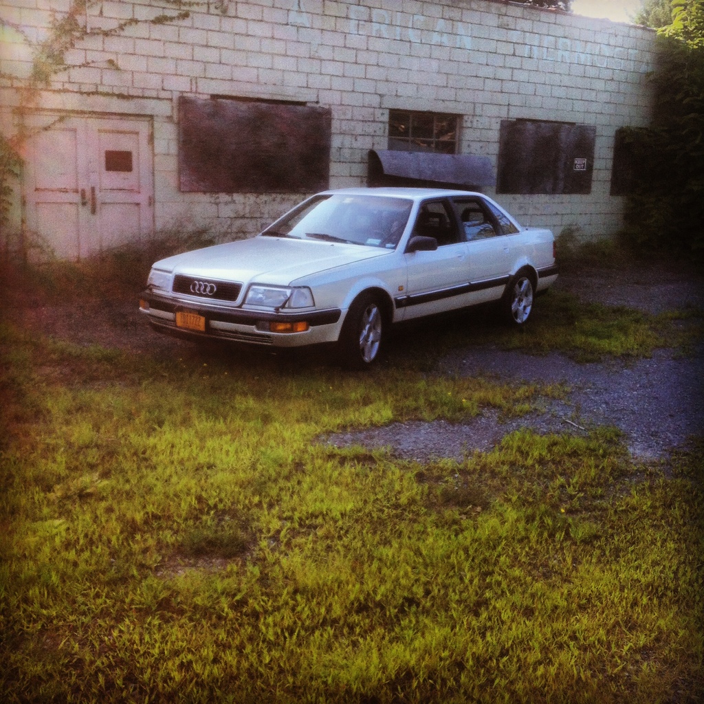

Just picked this up, going to start spending $ on it.
I'm looking for better front seats, sport or urs...heat power memory, if anyone has anything kicking around let me know. Needs valve cover gaskets bad, doing that and rear wheel bearing this week. Radio is stuck in safe mode, but I can't enter the code, it's a Bose I've tried holding fm1 and am and it's not responding. Any ideas on that?

Damn that looks CLEAN, but those wheels have got to go!
New V8
Posted: Sun Aug 03, 2014 9:23 pm
by scubagli

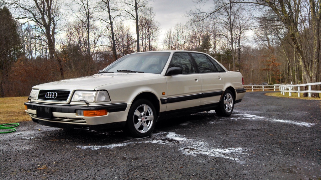

Which there are two sets pictured, 5 spoke Allroad 17's and old 15" milli's.
And the paint is pretty haggard, over all it's in good shape.
