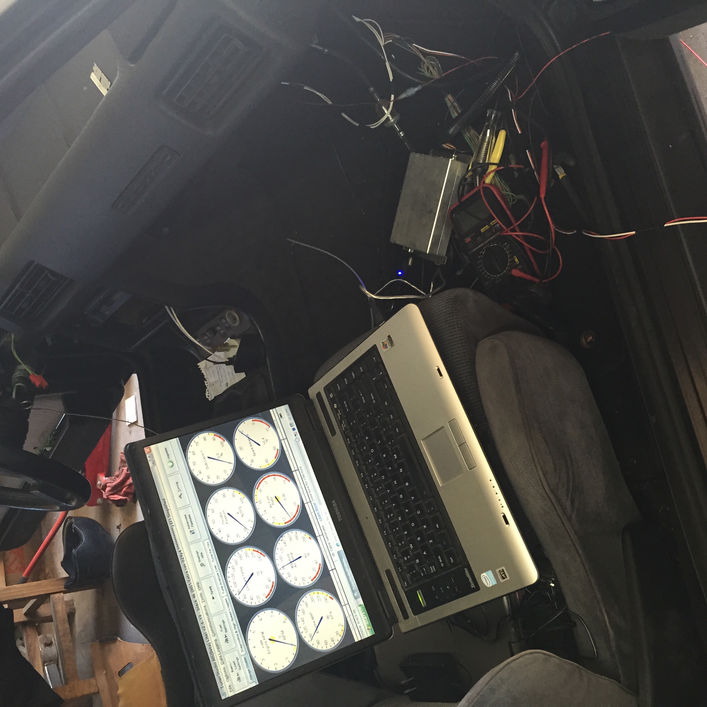

Sooooo.... This happened today!
Connected!
Connected!
She's online! The power connections inside the car are just roughly attached and I'll go back through and finish up after I get it started and idling. Everything seems to be working just fine. Went through and tested everything that gets power and they're good. Pretty sure the fuel tank is BONE dry haha. I'm hoping the pumps not gummed from sitting for a decade. I had to chase around a little bit with the fuel pump relay but got the pump to kick on like it should. I still need to wire in the wideband, change the oil, put fuel in and add coolant, BUT I'm going to try and start it on Thursday! Woohoo! :drunk:
