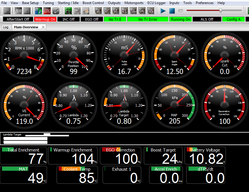

i posted my VEMS log in my other post by accident last night, whoops! it was late and i was tired. anyhow, here's the VEMS log from my very last pull on my test pad yestersday. this an easy first gear and than load it up in 2nd and pull to the rev limiter.

by carl
Voltage too low + Trigger errors.

by carl
Yea , my bad opened up wrong file :hammer: lol (v3.3_u009465-2015.06.22-02.30.24) guess windows nudged the file at the end being a new file and having the folder open or something.
Checked out the new log, no trigger errors, seems ok, like you say voltage still weird.
If you have one, what do your standard car gauge say, same deal? Maybe strap is jumping off the pulley from a wobble or too loose or something.
Can't say much otherwise, spool up seems a tad slow depending on what turbo you're running, interesting use of the mat retard table.
