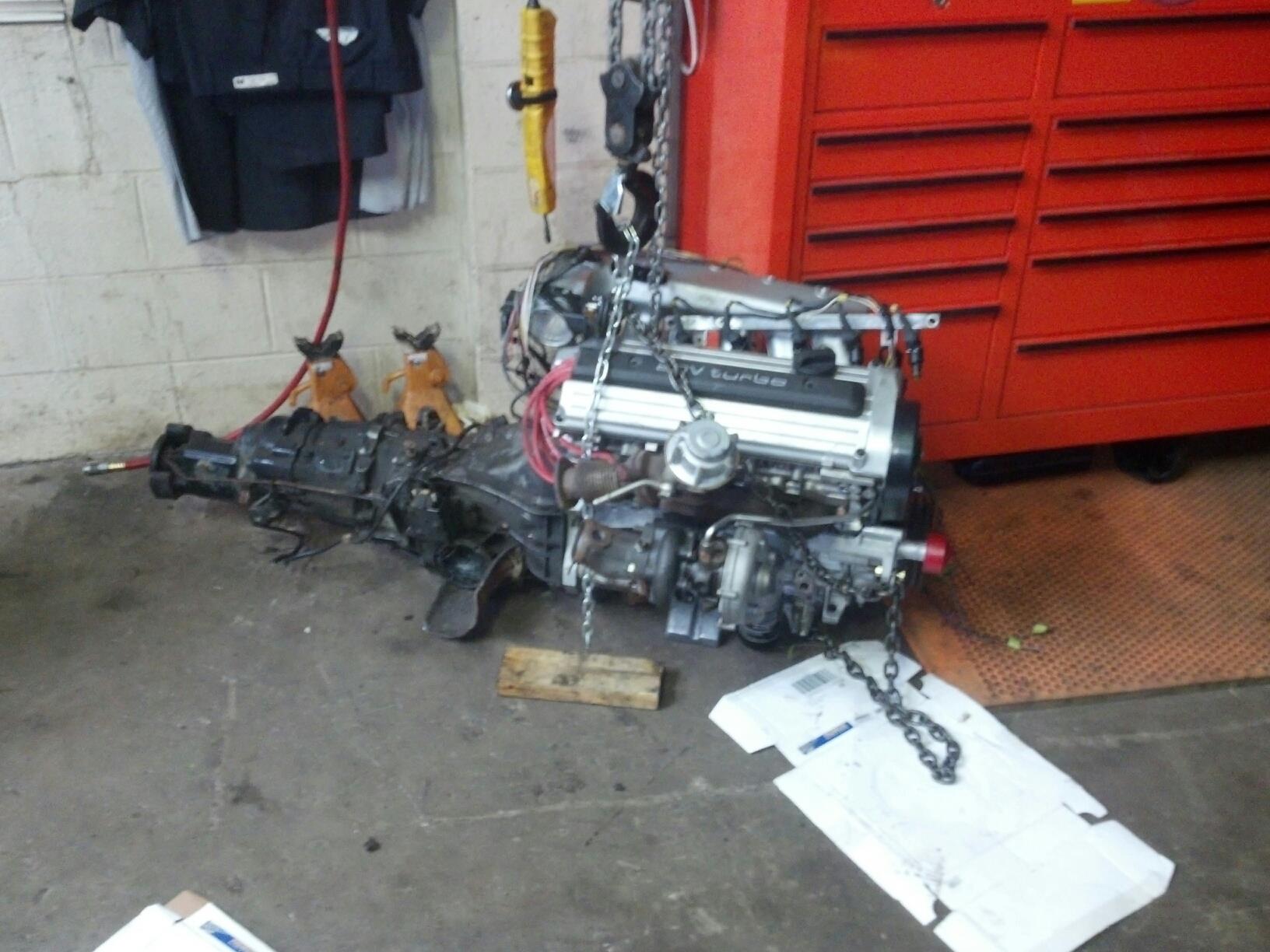

I guess it's time I make a thread on here.
Car:
1987 Audi 5000CS Quattro
Engine:
NF bottom end
7A head and cams
7A oil pan with extension
60-2 rear crank seal (no provisions for the factory sensors)
VEMS ECU
aaaand I guess pics...

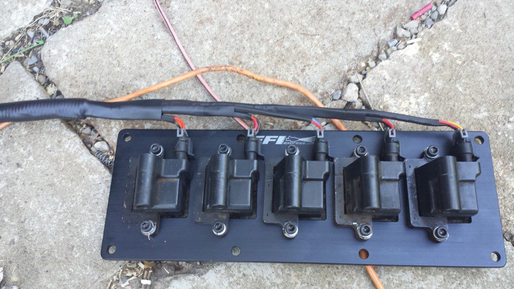

Which knock sensors should I buy to use? I can grab one off of a parts 5k for now/mocking up. Just wondering where to buy from.
Aaaaaand wiring progress. All I have left is ECU side and the crank sensor.

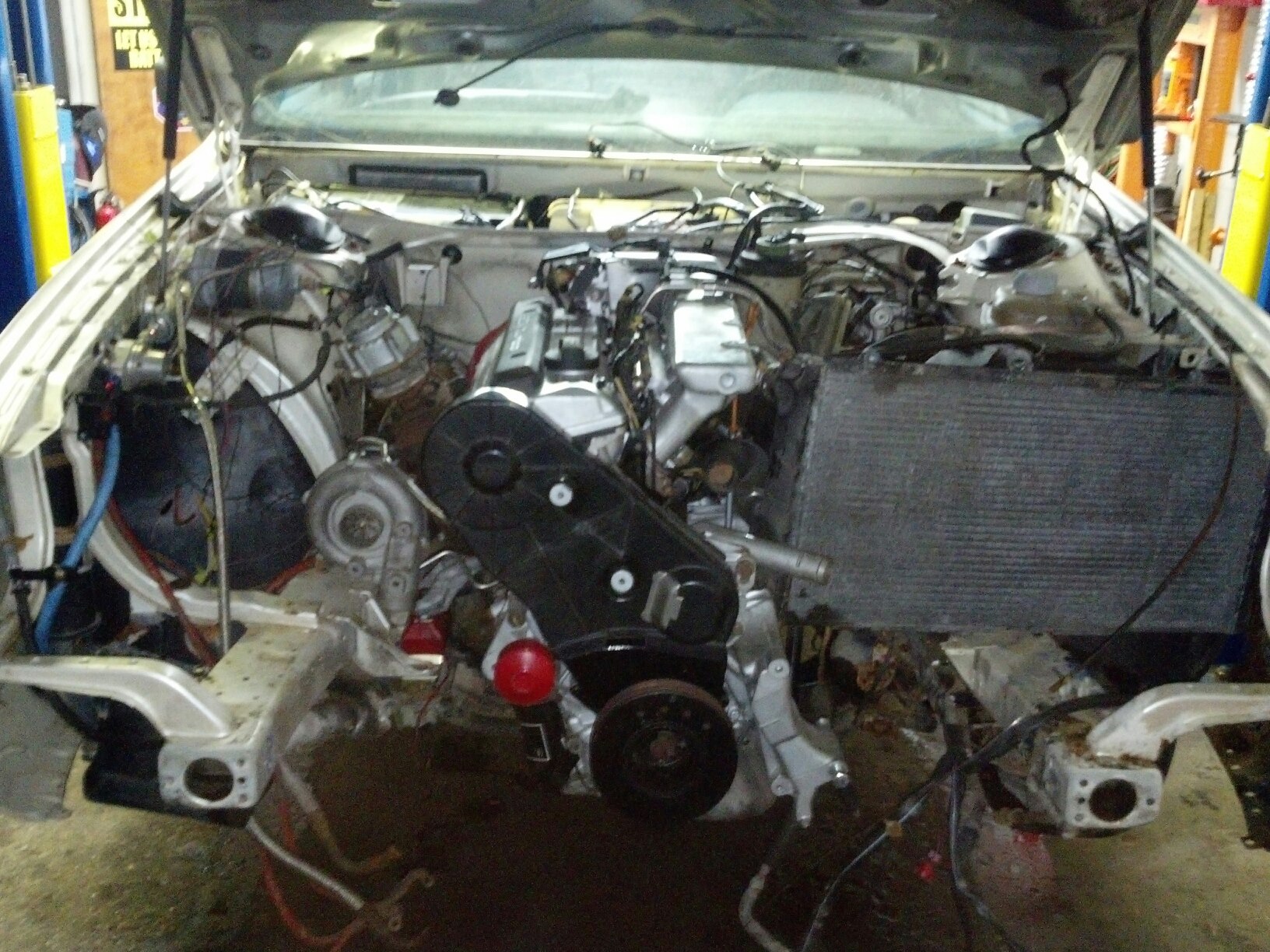

Hey it's a slow project and I told someone at Carlisle it would run by the end of summer, so I have less than a month to make it fire on starting fluid haha. It's getting along pretty well now. Basically I need that wiring, downpipe, fuel lines, brake lines, pads and rotors, power steering bracket and the vac boost swap. I think. I have work off the whole Labor Day week so hopefully I can get a good bit done.

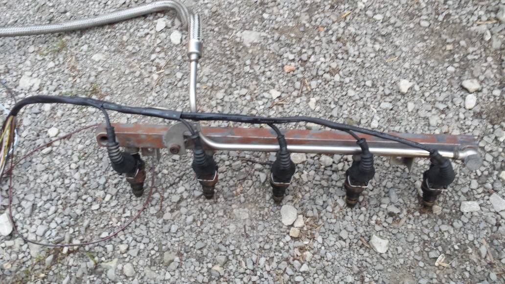

Today I bought a roll of fuel line, Wilwood proportioning valve and a splitter for at the rear of the car. Tomorrow I should be able to get some work done finally.
